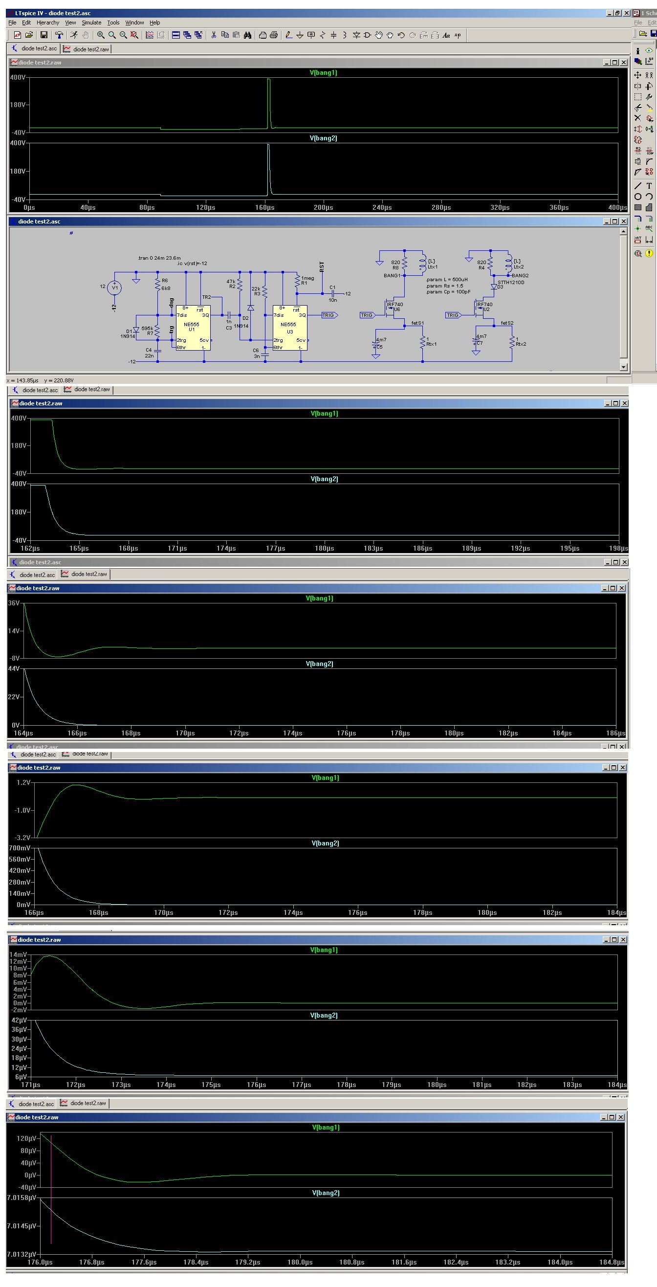

                            • Here is a virtual comparison of using a diode and not having one. I see some apparent difference between the two circuits' performance, but how or if that equates to improved target detection can only be determined in the field .
                              It looks to me like adding the diode will cause flyback to decay much faster in the first few microseconds. If adding a diode works out for builders being able to sample earlier than they could have otherwise, that is a good thing. And if you can use a higher damping resistance than before, that should also allow a stronger signal to be seen at the receiver input.
                              I don't think the diode would need to have a 1500V breakdown voltage (although for all I know, the STTH1210 might still be the best choice for some reason or another), but it would be a bad idea to use something with a lower breakdown voltage as compared to the zener voltage of whatever MOSFET is being used.
                              In case it is not obvious, what I did with the progression in the photo was start with the "big" picture, and then zoom in sequentially towards the last few microseconds of the flyback's settling. Note that the 176us point is about 14us after the end of the transmit pulse.
                              • how long was PULSE WIDTH in your interpetation? I ask because there has not deep sense to use the diode at range before 150us, but has after, near to 500us.
