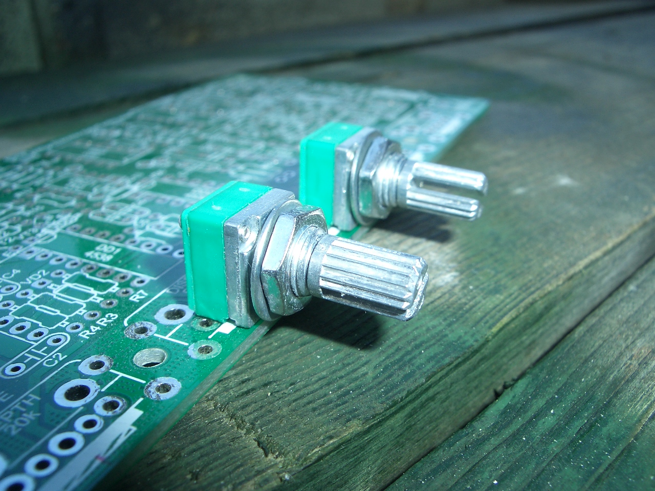

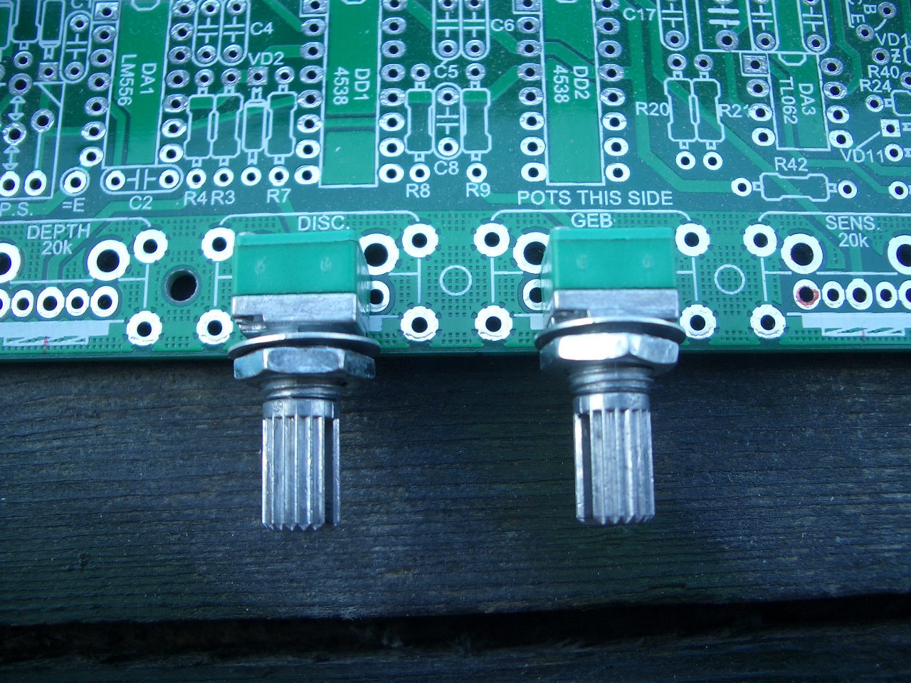

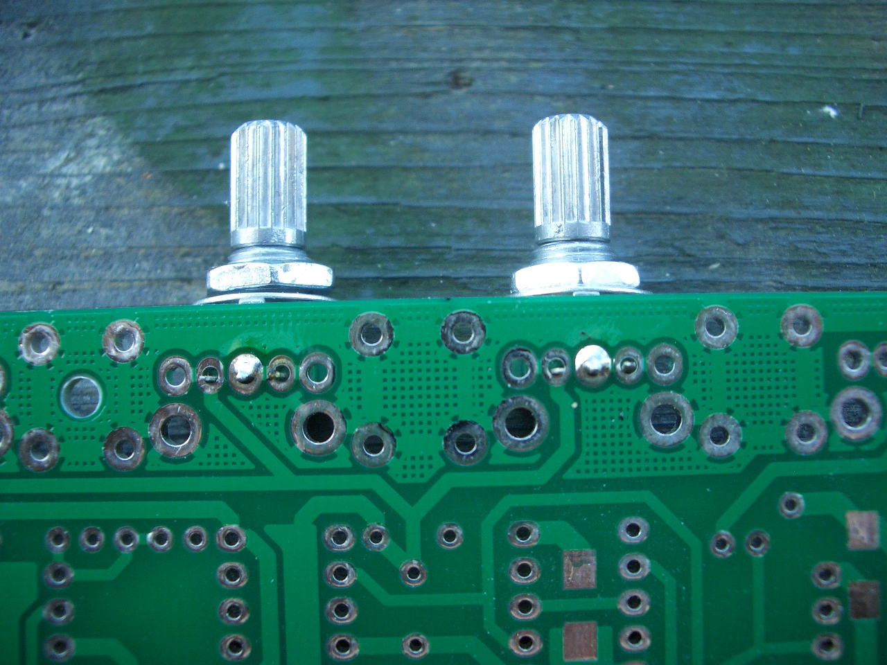

    • received 500k pots bought in ebay
      • Testing with AC erase head from cassete deck. It is the micro-pin-pointer coil.
