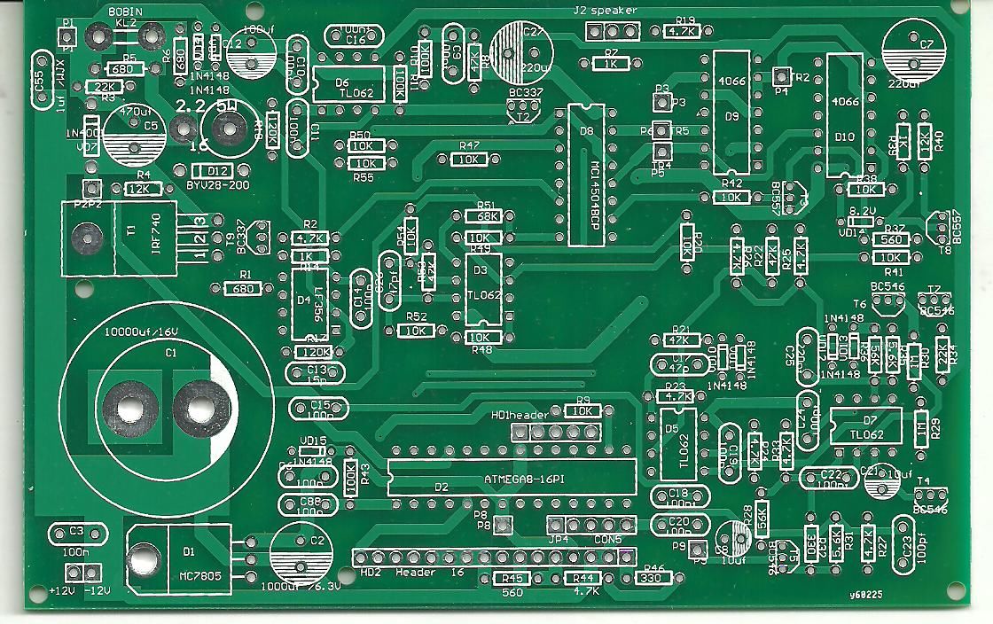

    • On the board I see you send Disc (I guess Iron Discrimination), Geb (?), Sens (SENSITIVITY), Threshold, but Geb and Depth not understand them.
      VERY VERY SORRY MY FRIEND! ohhh... I did feel I must rename the pots so then every kitchen wife could be working with DP, to low strange words on kitchen women level.... and yes I renamed them... because did think not all people around like PhD Eric Foster, Aziz, Nupi and Gary Chemelec... did think a majority people needs in simple terms, I did believe it. perhabs I did something wrong.... but no problem I give decoding for you...
      depth - PULSE WIDTH
      disc - PRIMARY SAMPLE DELAY
      geb - SECONDARY SAMPLE DELAY
      sens - GAIN
      bulgarians use for pot term NOISE. but what is the NOISE? WHY NOISE? WHERE NOISE??? noise in ground, noise in the schematic, either noise
      in sound? nobody bulgarian does not give answer. but I see NOISE pot is PULSE WIDTH - SIC! if you set it on minimum (150us) you do not
      get hot reply from ground, but then you have low sens - BOOM!!!
      if you set on maximum then you get maximum depth, so mohandes writes WHY I SEE THE BRICKS! so my friend mohhandes THIS IS NOISE. why you set DP
      ON MAXIMUM 500us PULSE WIDTH? why moha you do DP so noised and write that DP is not working??? write NOISE on your front panel, moha!
      I very hope all are clear for you now with the pots... no puzzle.
      PLEASE FEEL FREE TO ASK ME ANY QUESTIONS.
      ps. so if I see NOISE on front panel... I know... it is DELTA PULSE inside. http://deltapulse.eu/?p=157

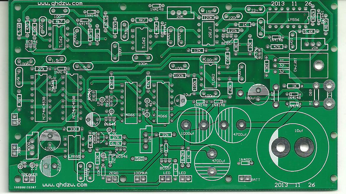

          • I had a diameter of 40 cm coil, with 8 cores, three times around, the effect is very good
              • Originally posted by qhdzw View Post
                your board WITH ATMEL is HUGE. it has area 135mm x 87mm = 11745 mm2
                my board area is 155 x 68 = 10540 mm2. while my board is WITHOUT the micro, with ALL POTS AT IT and with radiator place for IRF740
                bad work.

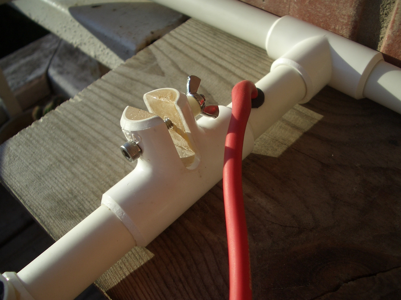

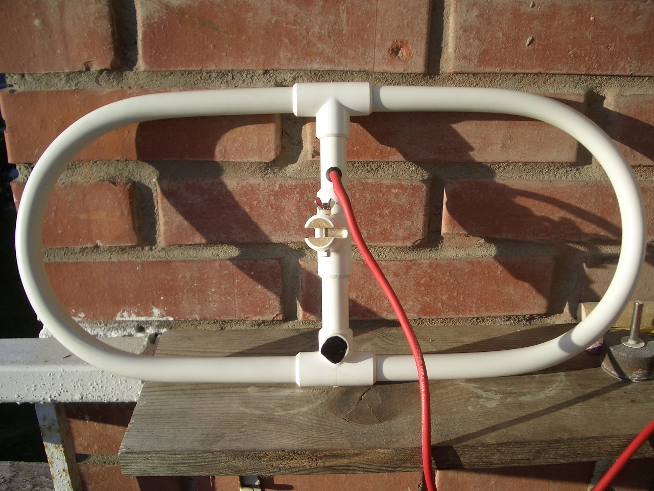

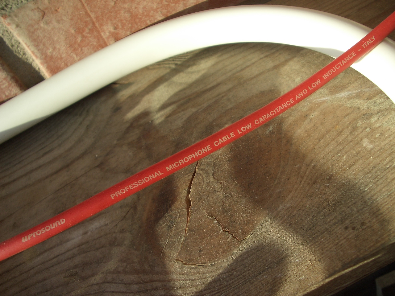

                      • Which cable use?
                        My friend... I use what is under my hand. a piece of television cable. I refused from tv too late ago... because russian tv channels are constantly lier, the degradation manifest, something kinda amerikanizm, child abuse, etc. nothing enlight. so use may be it. only take 'fat' and enough elastic cable. also I did see a microphone type cable in Mexico (SIC!) made DEEPERS 10DD detector. try it. with 114 500 000 inhabitans of your country I hope you will find it easily, my country has 2 948 200 inhabitans with fully depopulation on 2013 year. my country manufactures nothing. your country is huge and speedy grows... my country wants to be a colony of western Big Bro... the helot.

                        • kt315 Why do you use oval COIL..observed to be oval what is the REASON..???
                          many thanks g.s
                          • not mine made. DEEPERS 10DD coil. it was in repair by me. I_have_gave it back. ask please why oval http://www.deepers.com/English/Portal-Eng.html
                            • number of turn ?
                              blind squirrel, yeah? why you see but do not wish to see, why you hear but do not wish to hear? what is your problem, Mohandes?
                              • are you make your coil with professional microphone cable low cap..... ?can you tell me best cable for make 1.1m*1.1mcoil and for 35cm coil ?
                                do not use the not enough tight / tensed cable buddy, because you will be boarded out. http://www.liveleak.com/view?i=029_1396976270
