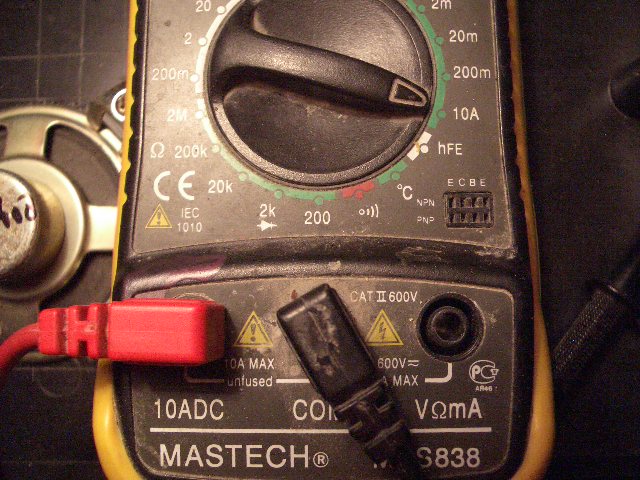

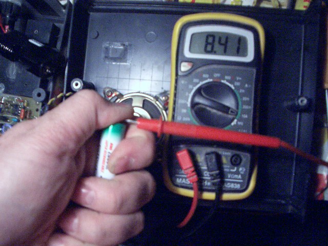

            I do not mean to replace MOS-FET with 7909. you add this IC for to supply all schematic by stabilised voltage. test all accumulators - this is your problem! one AA size unit must give you 9-10 A of current on your digital tester in full charged state! if you do not get this current - you do not get the stability NEVER MORE!
            hi kt315 ,
            please if you can explaine me more , i am a beginner and many thanks..................

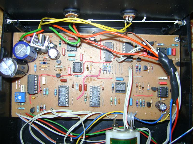

            i see your photo ....what the diffirence deep by TM808 and your DP?

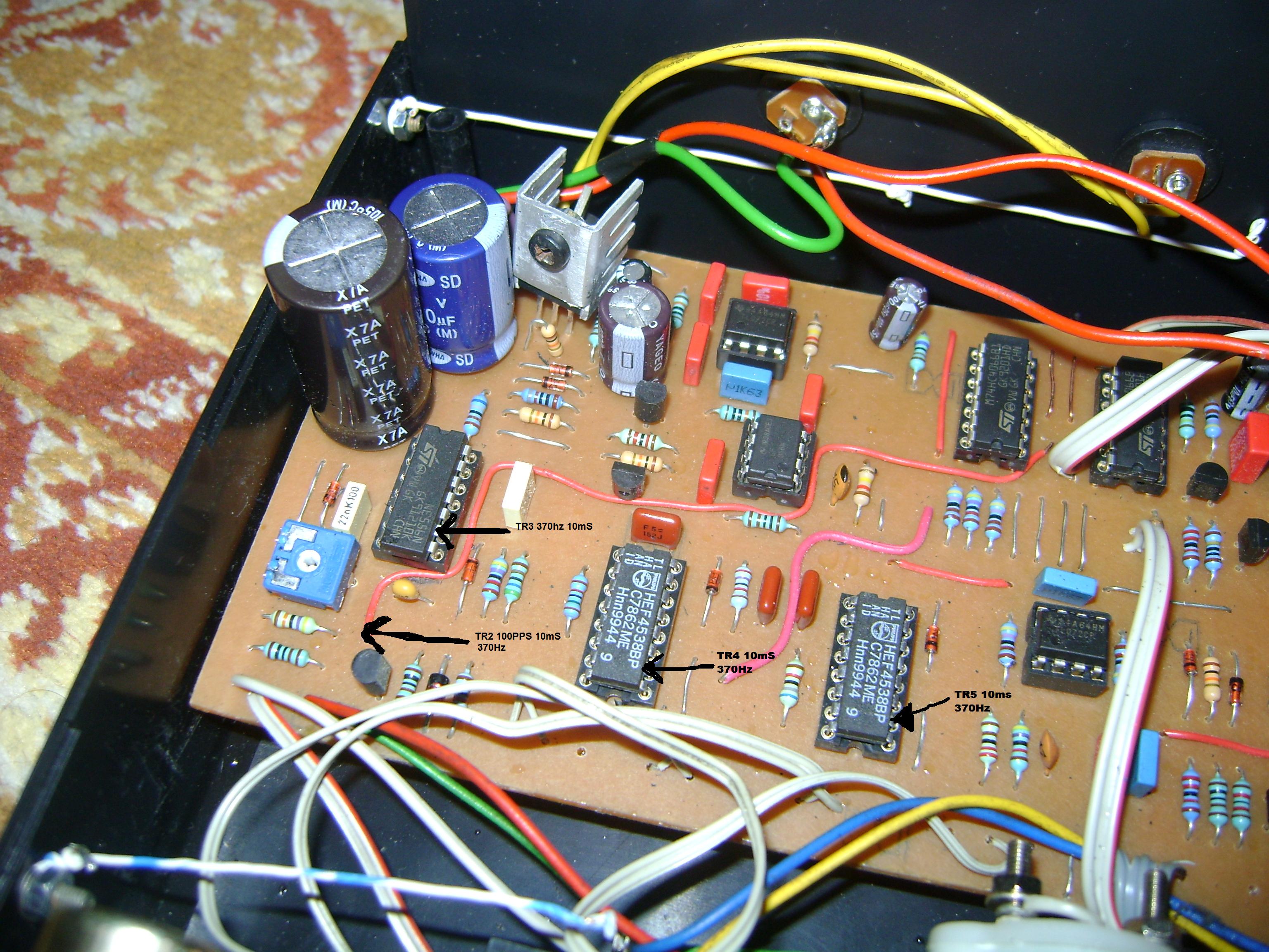

            • Hi,
              This is my new delta pulse or xr71 with discrimination
                  what you see HERE?
                  REMEMBER!
                  you must test your batt ONLY 1-2 seconds in this mode!
                  it is a short circuit for your batt!
                  is not TM-808. it is TF900. DP is more sensitive with coil 1*1 m than TF900.

                      • Delta Pulse
                        I have checked all based on schematic did all on osciloscope but same problem.With a 25 cm coil 32 turns im detecting at about the same distance
                        as i am using the 40 cm with 23 turns 0,5 wire.Dont know why.... Poor detecting a spray can 330 ml with 40 cm coil at 50 cm only...
                        With the 25 cm coil i get a big coin at 16 cm maximum....
                        Marius
                        • Originally posted by steaua581 View Post
                          Marius, what is the width of your TX pulse?
                          • Delta Pulse
                            Hello Mikebg and forum,
                            I have 10mS pulse TX
                            Marius
                              This is impossible. The pause between TX pulses is so large. See the width of pulses above in this thread posting #1024!
                              Mike-BG
                              • Delta Pulse
                                Hello Mike Bg and forum,
                                Thanx for your help ..You think instead 80uS arround 100uS on TR 2 will be allright?
                                Marius
