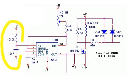

    • Holding the reset line low during initialization should prevent the long "on" signal that otherwise occurs at startup that could fry the FET. The component values I show are probably a little bit of over-kill but should be no harm in that.

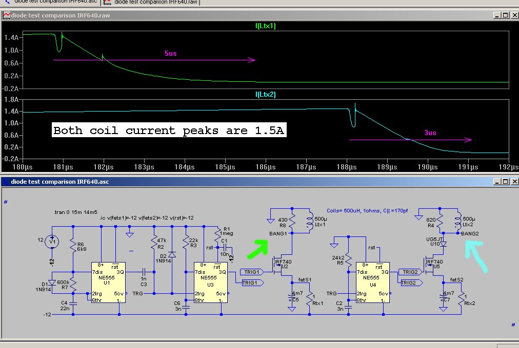

                Andy_F, I ran some side-by-side tests with and without UG5JG diode.
                Tests set up so that coil currents are equal instead of equalizing voltage peaks. That was my mistake before.
                The side with the diode uses about 11% more current than the side without the diode. Sooo, must tradeoff less power consumption for faster di/dt (plus higher damping resistor)?
                From those tests I don't see how power consumption is improved with the diode. That was wrong.

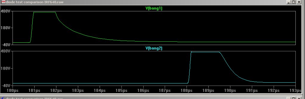

                  Drawing 1. without the diode, with the slow diode, with the fast diode:
                  Drawing 2. Results of modelling. Flayback with fast and with slow diodes is equivalent (speed of the diode is indifferent). Schemes with diodes have the smaller energy reserved in the coil (because of losses on the diode), illusion of therefore is created that the impulse with diodes is slightly shorter. No advantage of the diode is present (except harm) .

                        • Originally posted by Tinkerer View Post
                          Thus, we generally do not let the "parasitic Diode of the Mosfet" conduct, since it adds 2 or 3 uS to the delay.
                          Well. We will replace IRF840 with an ideal switch.
                          It is visible, that presence of the parasitic diode considerably worsens a situation. By the way, with IRF740 will be even worse.
                          • But we will return to the main question.
                            For processing used the place, where voltage of flayback is a millivolt and less. We will consider, that occurs in this place. For this purpose we take the scheme with the diode and without the diode.
                            Doubtless victory of a variant without the diode!
                            • This last test is flawed because you have made no attempt to optimize damping resistors. But that's OK because we're comparing apples and oranges anyway. I will grant you decay rate (with diode) slows near the end so that the ends of the two curves nearly coincide.
                              And yep, it looks like the diode doesn't become reverse biased until after most of the coil current has already decayed. That means I'm lacking an explanation for increase in di/dt.
                              The advantages I touted are quickly being whittled down.
                              1) There's no improvement in supply current for equal coil currents at cutoff. The FET/diode requires a slightly longer energizing period because of diode loss.
                              2) Initial quicker discharge rate slows until there is no advantage in time at which a sample can be made (coil voltage in the microvolts range).
                              3) No appreciable improvement when long pulsewidths are used.
                              (This probably means wasted power in the DP.)
                              There are some tangible benefits from adding a diode -with short pulses
                              1) A larger value damping resistor is possible with the diode.
                              2) Faster initial coil current decay which equates to more power delivered to the target - for equal coil currents at turnoff.
                              Now, whether these factors make up for losing power in the diode - who knows.
                              Looking at the voltage waveform tells you little about flyback current. Look at the current waveform.
                              Alright, don't use the series diode in your Delta Pulse because any benefit is very debatable.
                              • hi ,
                                I need help ,today I connected battery with diverse polarity that I blow up something.
                                my delta give intersting sounds. does not see metal.
                                I tocuh voltmeter to coil outputs but no change at screen.
                                I changed mosfet , ,chaneged burned 4001 by 4148 ,also changed 556 but still there is no change
                                thanks for helps
