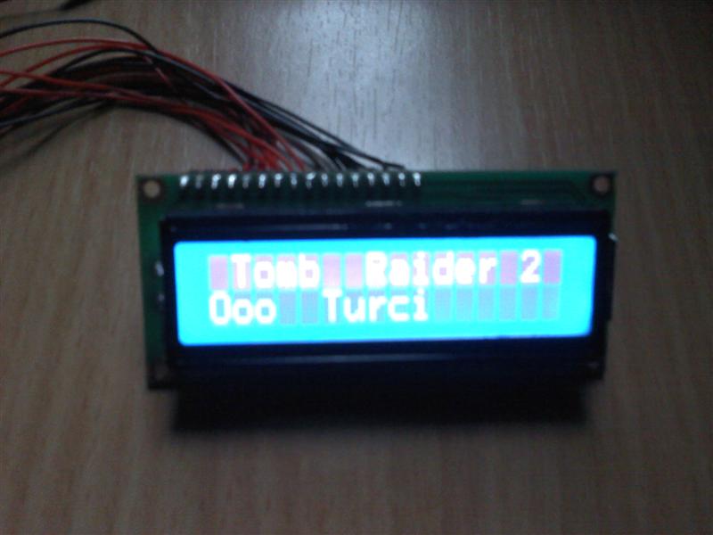

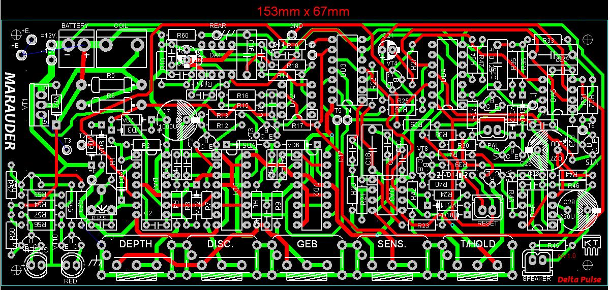

      • i want to make lcd for this and i want use turkey site ( i download this file )
        • at this stage
          • Kt315 do you have the schematic that goes with that PCB ?
            thanks

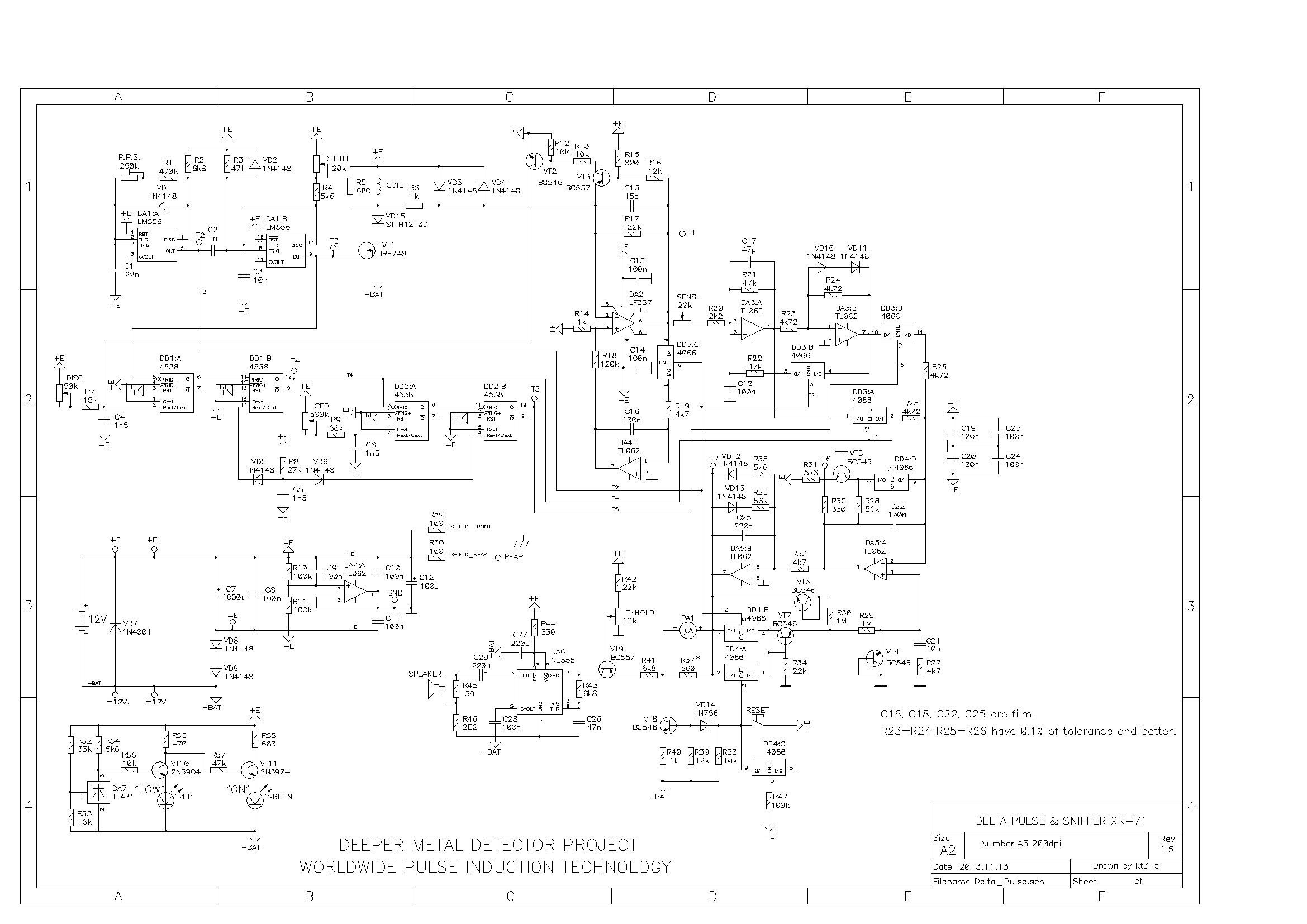

            • schematic
              • I have a problem with lcd
                When I put hex _ He gets it !Click image for larger version
Name:	ooo turcii.jpg
                  When I put hex _ He gets it ![ATTACH]27206[/ATTACH]

                      hi 6666
                      can you say me diff between ths schematic and main schematic
                      • for your mohandes..
                        1 ..The main difference is the DIODOS ultrafast (stth121od) So this elevates the voltage in approximately 200 voltage..
                        2.. An additional switch at the button ( reset )
                        3.. a stabilizer at 9 volts,and two RESISTANCE for shielding above and below obsidian rainbow PCB.
                        4.. improvement of the two led Indication for the operation and for low voltage....
                        would be good though to make this question to the author which improved these things..
                        THIS IS THE ΚΤ315..
                          if anyone maybe dreams to do an ultradepth PI the diode gives advantage. IRF740 with its 400V of limited max peak voltage will go in range of pinch-off at max of PULSE WIDTH, mean more than 500us and if anyone want encrease PULSE WIDTH to 1000us
                          (Eric Foster's detector for Mel Fisher Atocha 40tons gold - http://en.wikipedia.org/wiki/Mel_Fisher).
                          the diode takes off this limitation. I have to notice you are NOT needed in the diode usage in surf pi, bara pi, HH pi and similar low TX power machine.
                          still needed in experiment. it is not tested.
                          I deleted the 9v stabilizer. I offer to use outer impulse STEP UP converter. it was tested.
                          it is simple circuit and was tested. no expensive special ic used.
