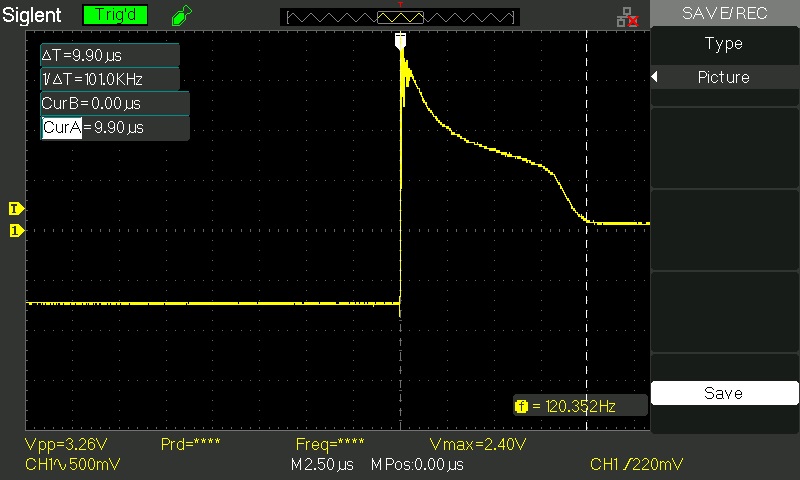

      Here is my first attached image:
      I am beginning to make a Deltapulse. I have use a breadboard to test the driver circuit (timer + power). I used a function generator to created a pulse at 120Hz (1.2% duty) and ~100uS (pulse width)
      The coil is:
      25 cm, 25 turns, 0.5mm wire -> 506 uH, 2.0 Ohms
      This is the pic taken from the oscilloscope; I would like to know if that is what I have to expect from the circuit; it was taken with the scope connected to the damper diodes.
      • to expect from the circuit --- ITMD was written for beginners. ITMD is perhaps RTFM for breadboarders.
        ok. what you have to see on limiting diodes? the limited 'delta pulse'. good start for understanding what is delta pulse in Delta Pulse.

          I attached a picture with the wave forms taken from VD3/VD4 + R6 (1K0). I would like to know if that is what we normally see when the Delta Pulse is working Ok?
