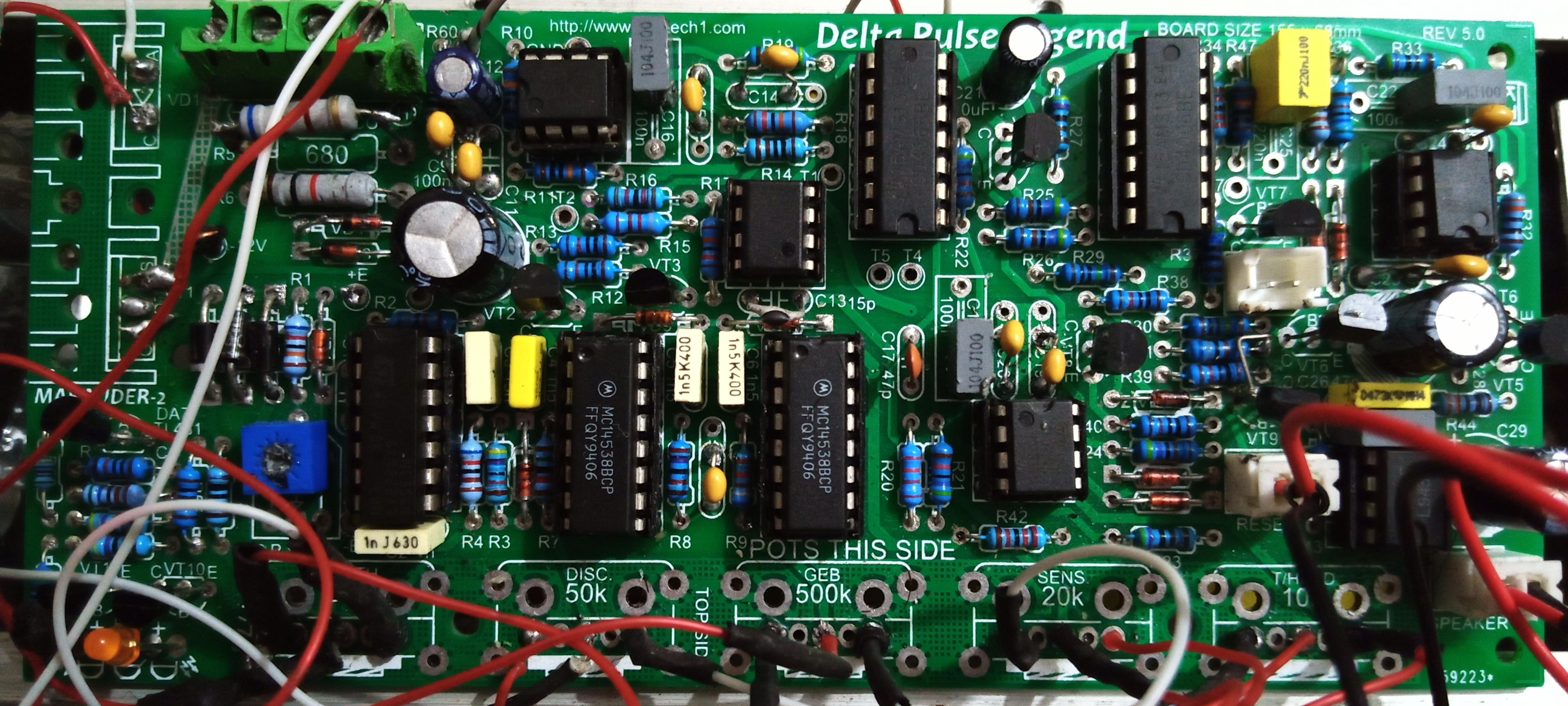

      Andi68 With some damping resistor + LF356 the detector is absolutely obedient no noise no chatter and i can turn all pots to maximum without much noise but it detects no target whatsoever. Whats else can cause this non detection other than LF356? $he same board works with TL071 but depth not as expected.
        • why vd4 cathode on anode pad?
          • And I see some nasty solder joints
            • Originally posted by Andi68 View Post
              Yes very ugly but working good.

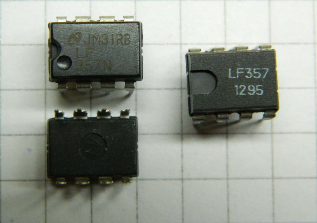

                  I have no problem with LF but... i stil use old BC548 transistors, ceramic caps in offset correctors and maybe fake Wima 100nf MKP capacitor - magnet can easy stick to it. Also my problem is laziness...
                  some fake ic on photo Click image for larger version
Name:	fake and original.png

                        Yes i see the mistake there with VD4. I don't want to solder again and again so i ignore beautification. The solder joints are good because i checked with DMM.
                        • I have corrected VD4. Nothing has improved after correcting this mistake. The 356 chip is still not working

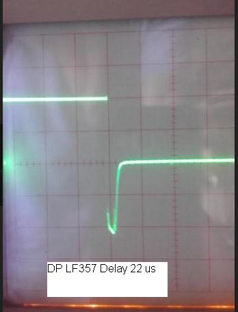

                          • Buy two LF357 and two TL081 to perform the tests.
                            Install a socket to test the chips.
                            With the LF357, set the Delay to 22 us.

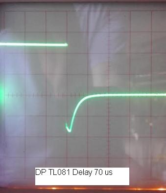

                            The TL081 turned out to be false.
                            Recover a TL081 from another board and it worked, the delay was set to 70 us so that the DP was quiet.
                            I also tested an LF356 and the delay was set to 35 us.
                            All other controls and damping resistance were not altered during the tests.
                            Other Chips, 5534; LM318; 709; they didn't work.
                            LF357 is preferred, followed by LF356, but with TL081 sensitivity to small and medium objects is lost.
                            Attached do images taken with the oscilloscope, at the exit (leg 6) of the LF357 and TL081.Click image for larger version

                              It is likely to be false or damaged due to improper installation of VD4.
