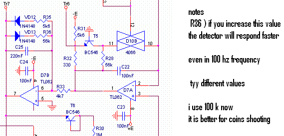

                • this mod increases reaction of SAT speed if you need to do it. ossama mod.
                  • Awesome
                    • thank....
