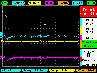

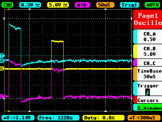

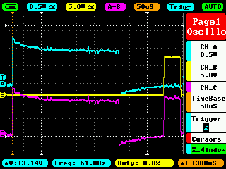

              Also, I have bought another oscilloscope probe, so there are measurements for Tr3 and Tr4. When I compare signals on those points, I have 30us minimal and 130us maximal delay between imuplses, depending on Delay (or Sensitivity) potentiometer position. Are those values OK, or I need to adjust something?
              Delay between Tr4 and Tr5 is 115-930ms:
              I suppose that is correct?
