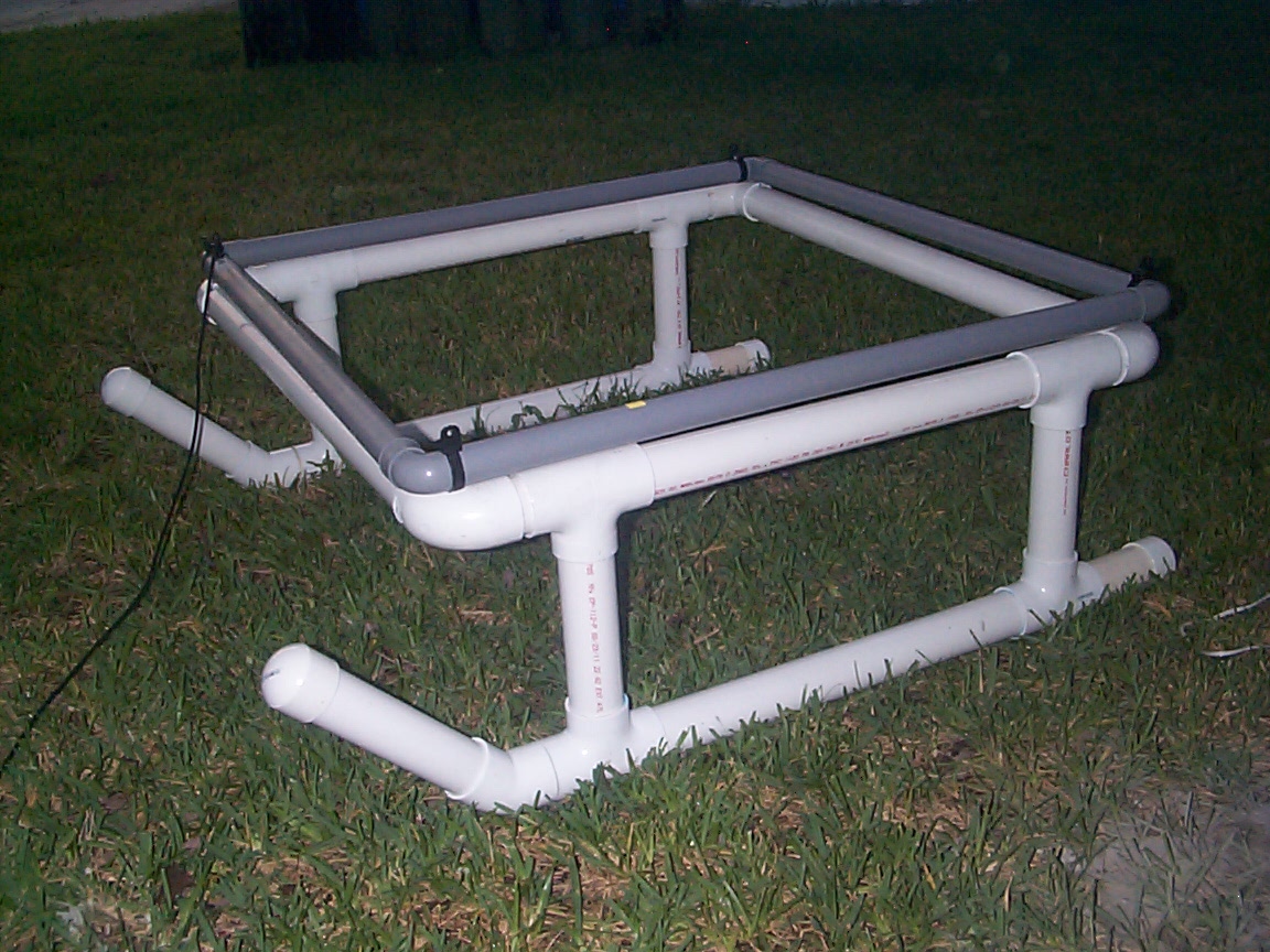

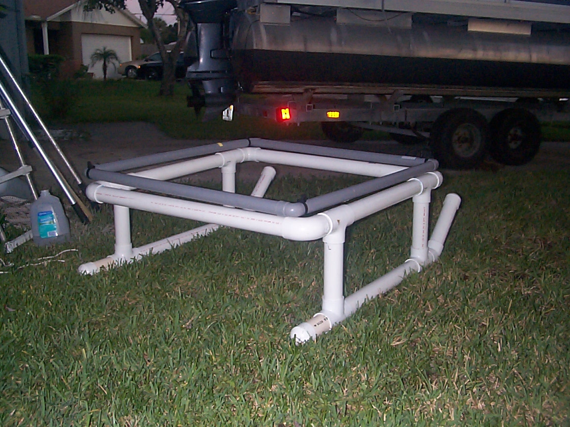

                          • use bigger coil for increase of the depth. and Voila! i do not see a problem )))
ID:	344032Click image for larger version
                            • chinese people at job. maybe they do pefect detector now, maybe something for minelab. maybe sir Liu is like a manager among them.
