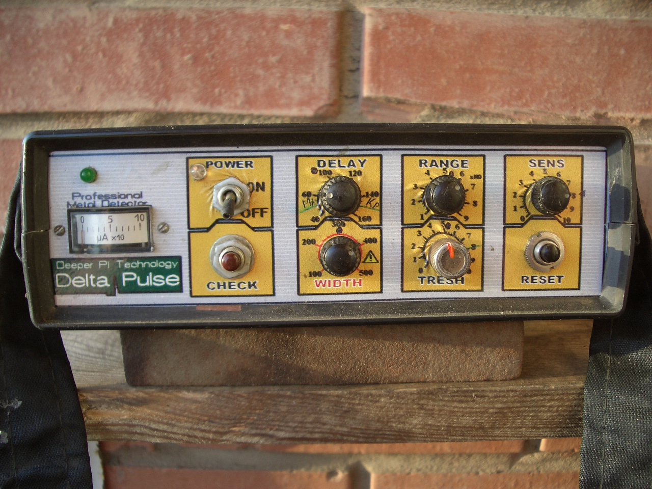

                    • I ONLY was back now from a field I tested Delta Pulse again. Working too good! After my last shielding mod I described above. I did set 400 and 500 us of Pulse Width - there was NOT PROBLEM! Very well steady work.

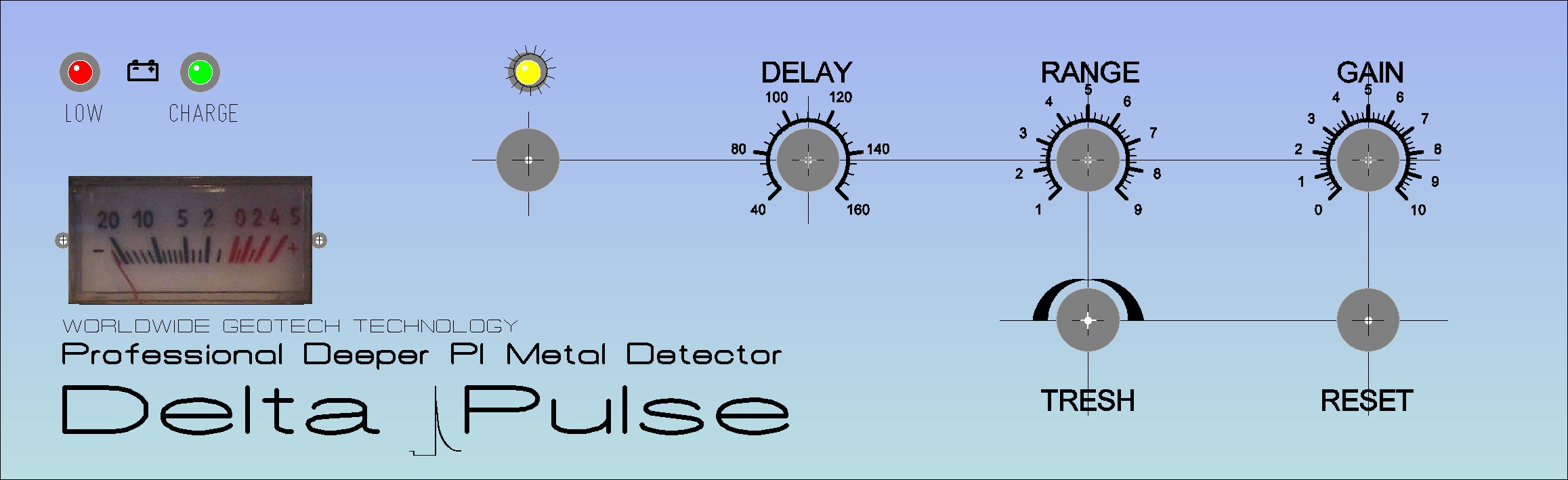

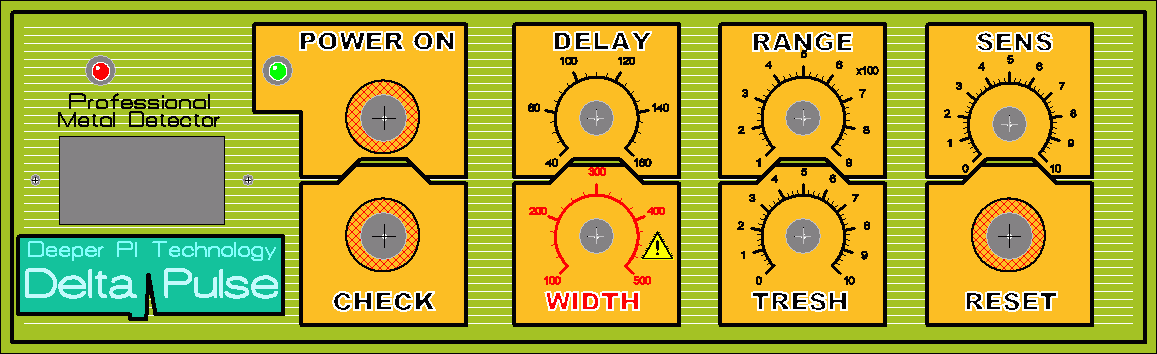

                        • DP
                          Hello KT315,
                          I wonder what software you use for the front panel DP design. I am looking to give finishing touches to my DP. Do you have any templates by chance?...
                          looks great!
                          Kind Regards
                          Marius
                          • hi Marius,
                            I use FrontDesigner_3.0 translated/converted in Russian. it has 2,7mb installation EXE file. it is widespreaded in our part of world.
                            sincerely
                              • DP
                                Thank you so much KT315!!!.
                                Marius
