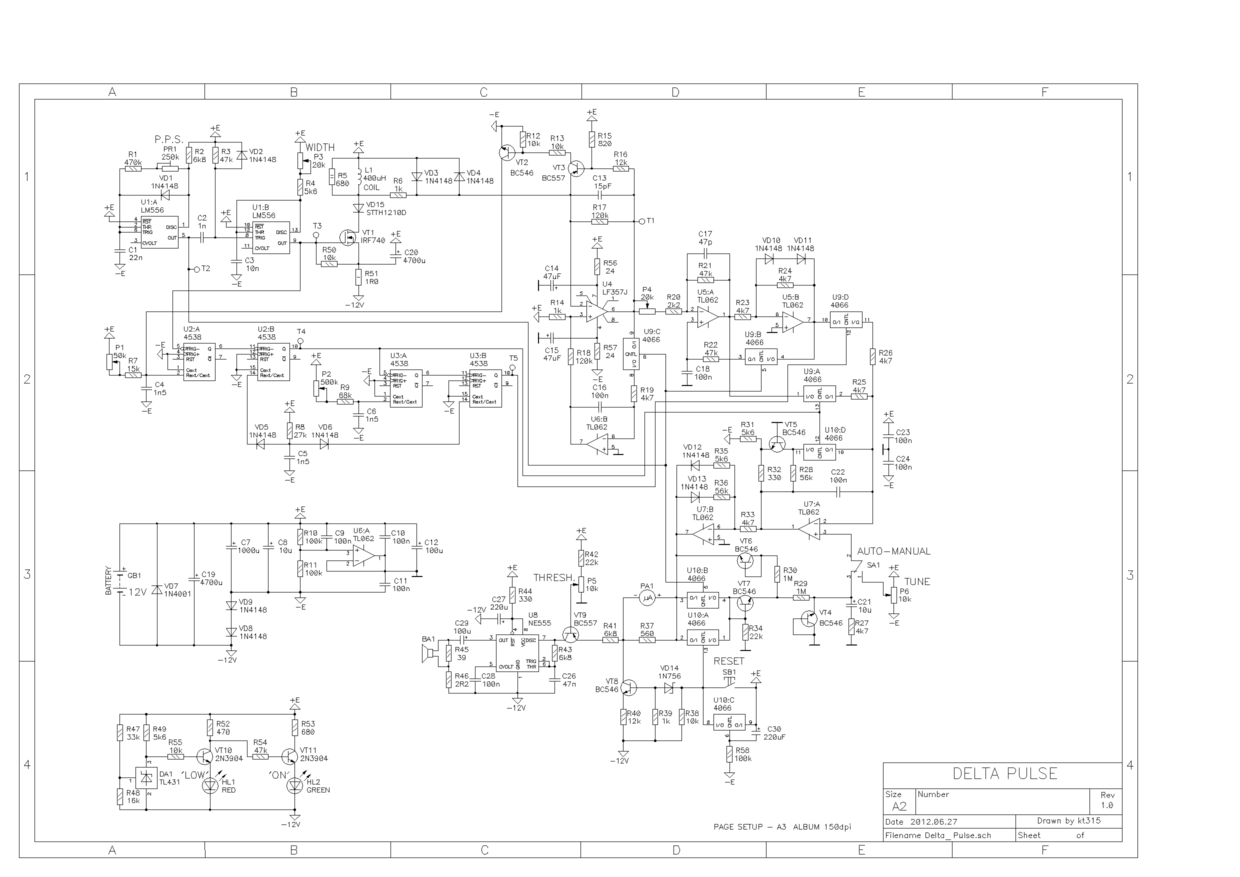

    • Delta Pulse Problem
      Hi Everyone,
      I have constructed the DP1 and its not working.. The issue that I have is I am not getting any sound from it... I have made my own PCB using the sonsor.lay file which was posted here.
      I have found that the BC546 transistor has been inversed on this PCB and correctly soldered the components.... does anyone had the similar problem and found the solution???? If yes please help me...
      Ajay
      • can you give a direct link on this sonsor.lay file?
        • Check bc557
            Hi KT315,
            Sorry my mistake it is not sonsor.lay it is actually soncorr.lay. I dont have the link to this file handy now i am attaching the file here.
            -Ajay

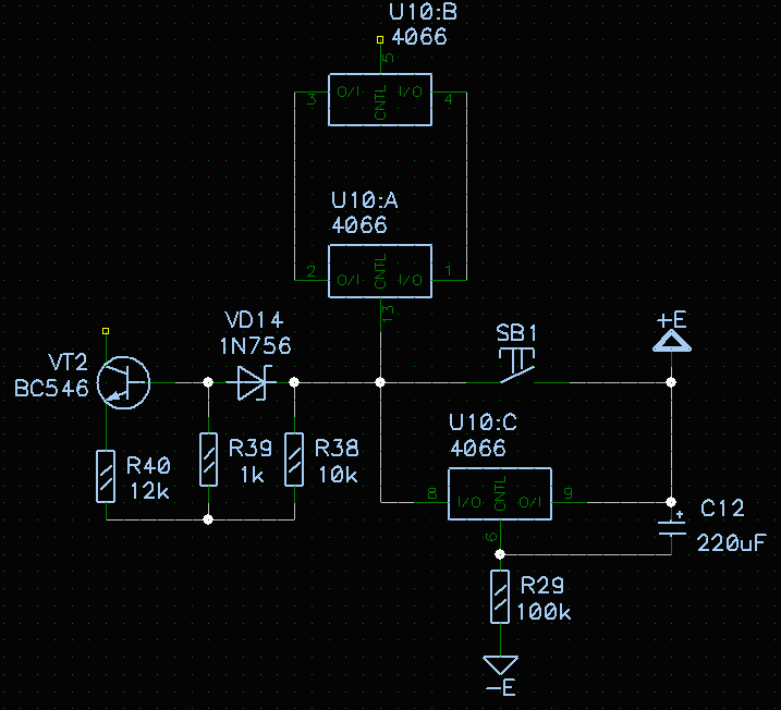

                  • Maybe anybody has did a schematic in OrCAD or P-CAD? would be greatly appreciated if you share it.
                    all the best
                    • noticed there is free section of D10 (U10 in my schematic attached). IMO it may be used for auto-reset on turn-on.
                        Good idea, KT315
                          • please help
                            i have build my delta pulse since a year, it don't work , i would to fix the problems, so i need your help .
                            - a continued sound from speaker.
                            - TL062 (D5) is very hot
                            please i need your help
                            Cordialy
                            • Originally posted by apocalypto View Post
                              Cordialy
                              Hello Apocalypto
                              It's hard to help from here.
                              I can only say that the TL062 is not power device. Its power consumption is very low so not to take temperature.
                              Check the PCB and compare with the scheme, it is likely that there is any short circuit between the tracks, use a magnifying glass. Check the value and the correct installation of the nearby component.
                              Replace the TL062, may be damaged.
