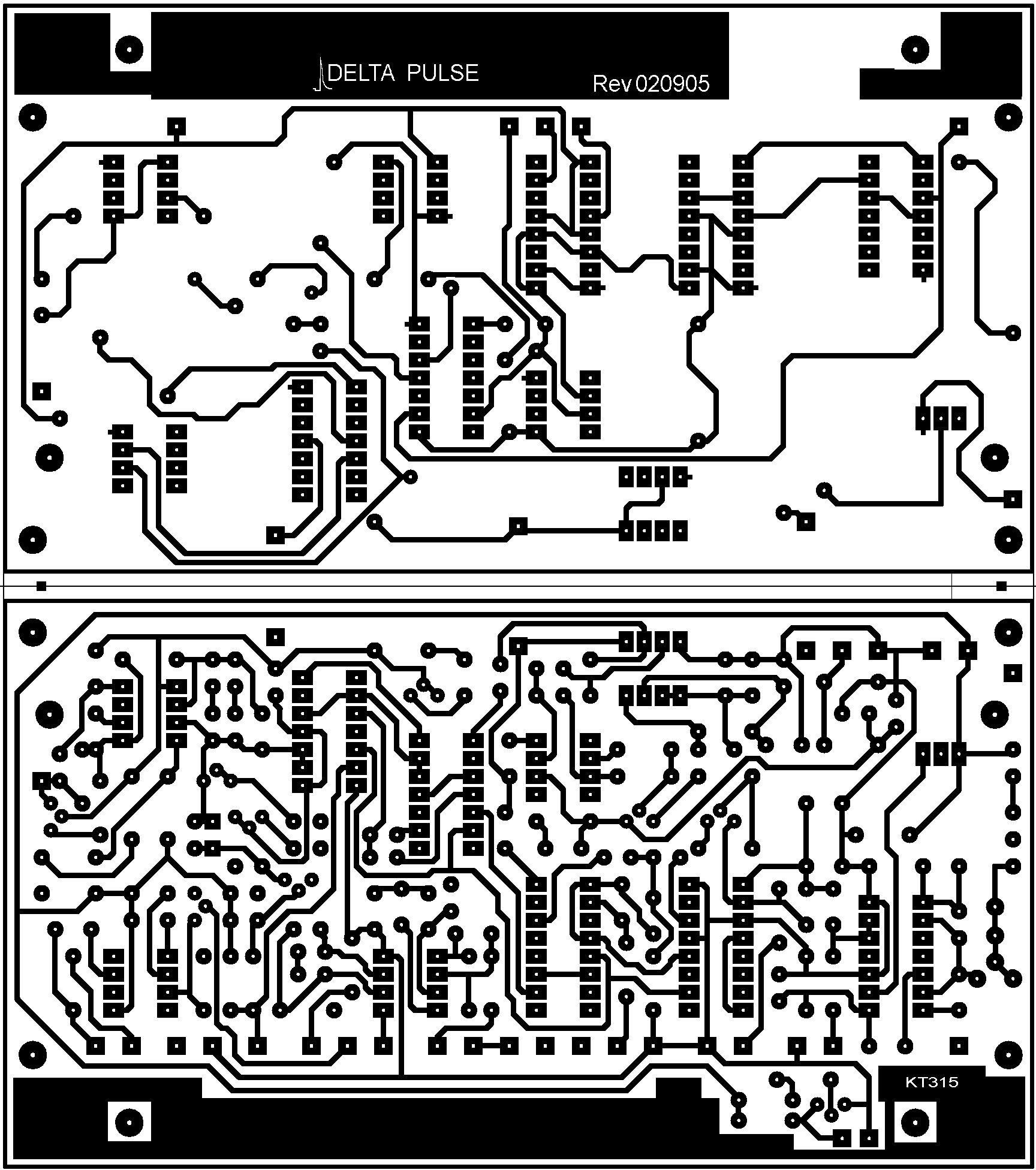

                    • #55
                      PCB image

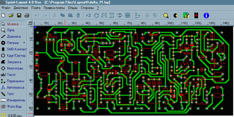

                              we have PCB in Sprint Layout format now.
                              done by Treiti - thanks lots him!! please, check the PCB.
