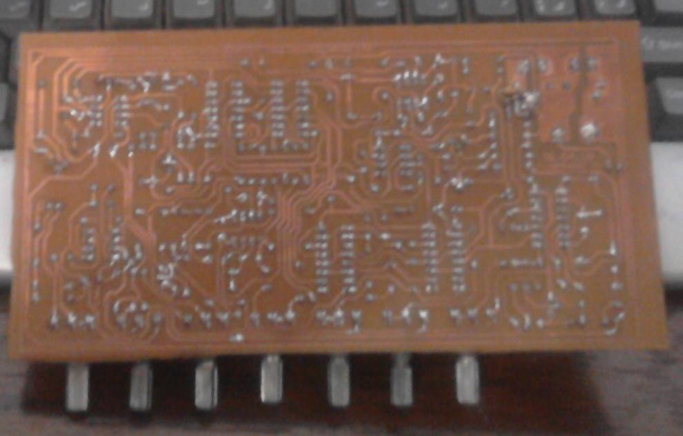

    • Clean the soldered side of the board with isopropyl alcohol, there is a lot of sh*t (residue) left after you soldered it. Also, you could check the connectivity (point to point) of your tracks, they don't look that good.
      Also, check if you don't have shorted tracks.
      Nicolae
      • Thank you very much.I'll see and I'll tell you what happened

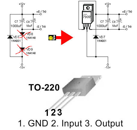

            PLEASE CAN YOU SIMPLIFY THE LOCATION OF A 7909 WHERE I HAVE THE WELD IS POSSIBLE
            WITH PHOTOS.
            I did refuse 7909 use. but you can try it... I placed 7909 instead diodes VD8 and VD9, on their places (the diodes was been desoldered). photos I did not do.

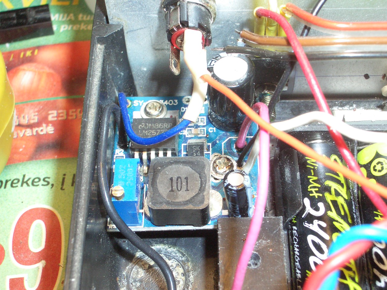

            my mod now... converter on LM2577-ADJ... if it is working good in Milelab so I think it will be working good in DP too

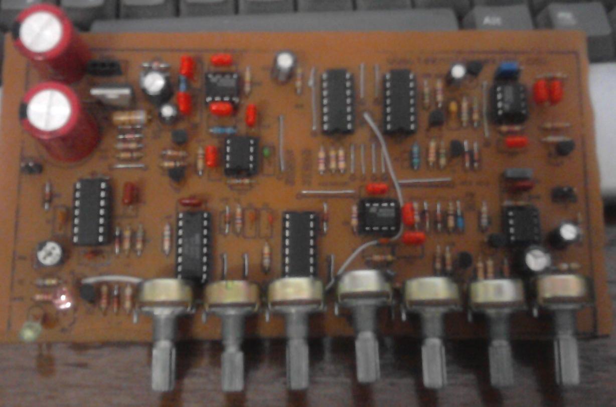

                      • I check all diodes an transistors
                        this is my delta pic's
                        • Originally posted by Sepid Gsm View Post

                            From the part I wrote about my problems and a few step which you solved.
                            http://www.geotech1.com/forums/showp...postcount=1348
                            The condensers for replace PP.
                            • yes coil vibrates is well
                              without coil,D9,D10,D2,D3 sound going too !

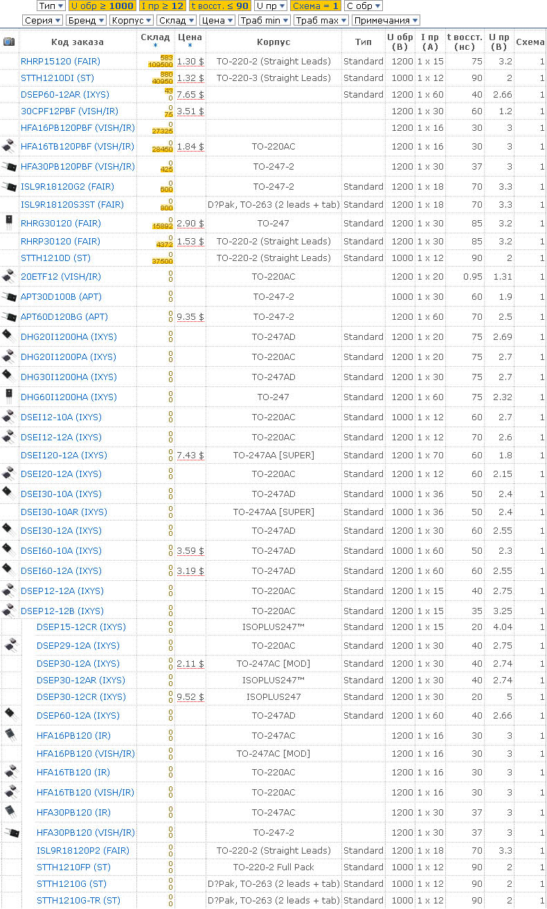

                                Hello kt315 and other friends
                                I can not find the diode stth1210
                                Please help me replace this piece
                                Can I work take 1n4001 or 1n4148 ???
                                Please help me
                                I did some search the interchangeability... enjoy.
