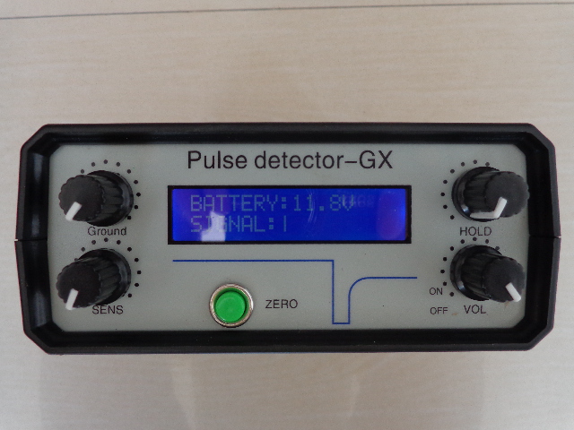

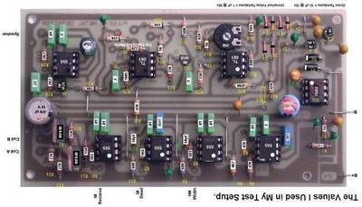

                  Hi Kt315 the schematics of Chinese detectors is sniffer 71
                  http://www.3630tc.com/h-pd-14-2_2.html
                  and other modified

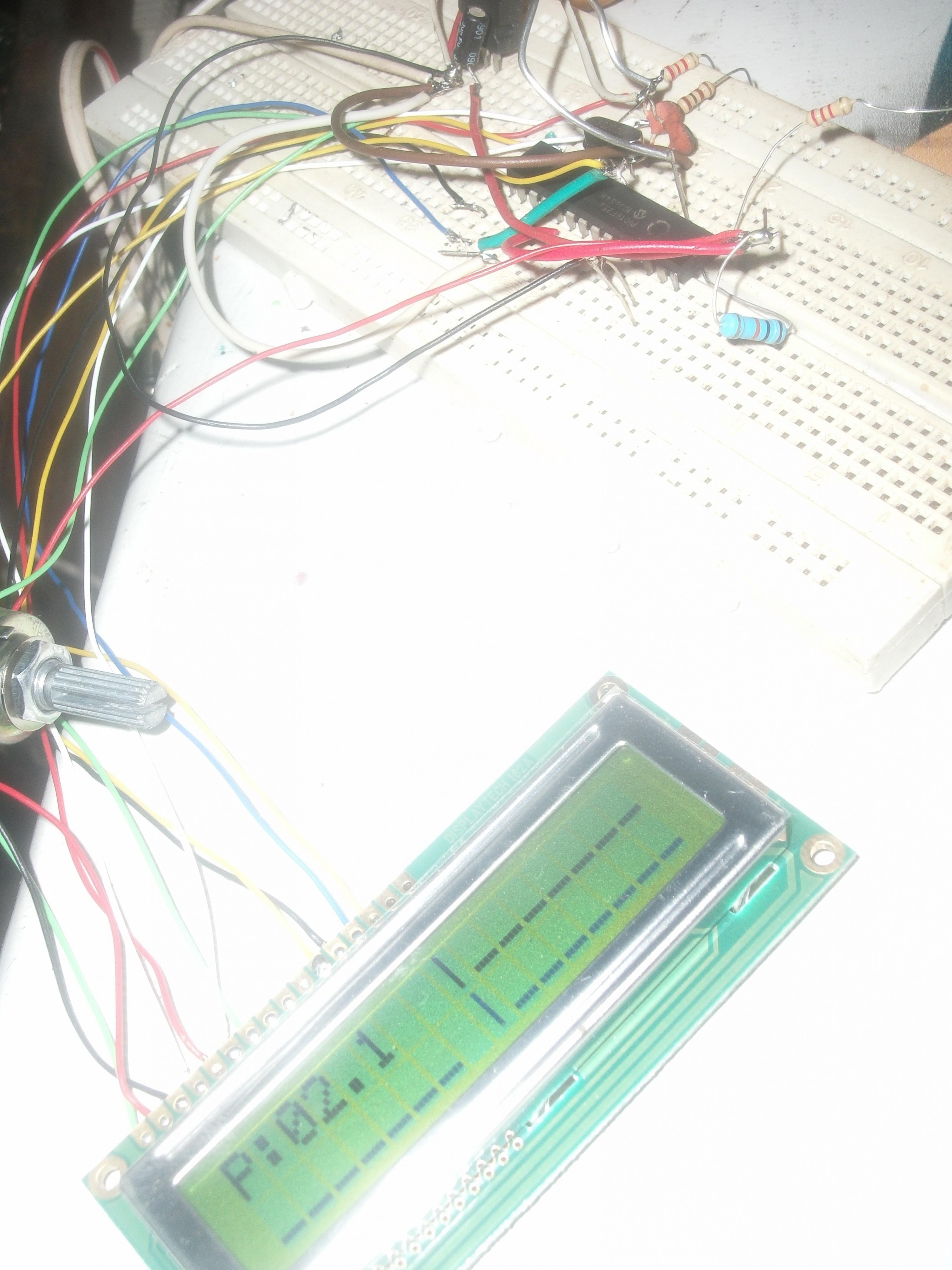

                            hi
                            my problem not solve.

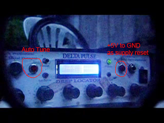

                            Hi Mohandes, i have same problem with you on DP2+ last year I make two circuits with this and get the same problem,.the trouble is the LCD I use when I turn on the circuit I get scramble letter on TOP of lcd screen.,some times like a full contrast but is not.,.I only solved this by making a quick short of +5v out of LM7805 to GNd...maybe the reason for this is the write delay of a hex and the delay of the LCD.Click image for larger version

                            • If you have some spare of LCD try to sub. one..

                                I'm pretty sure for that, it is a Delta Pulse or XR71 and a Gary PI..
