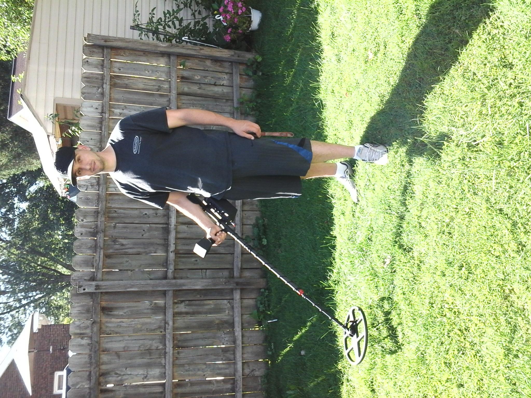

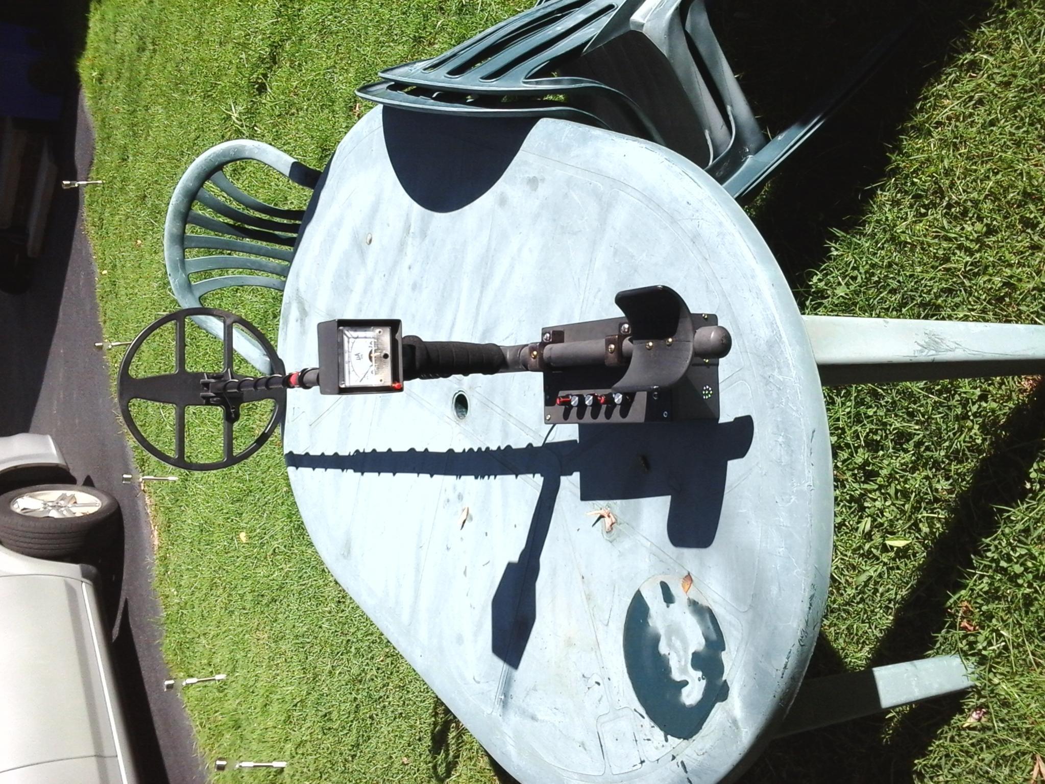

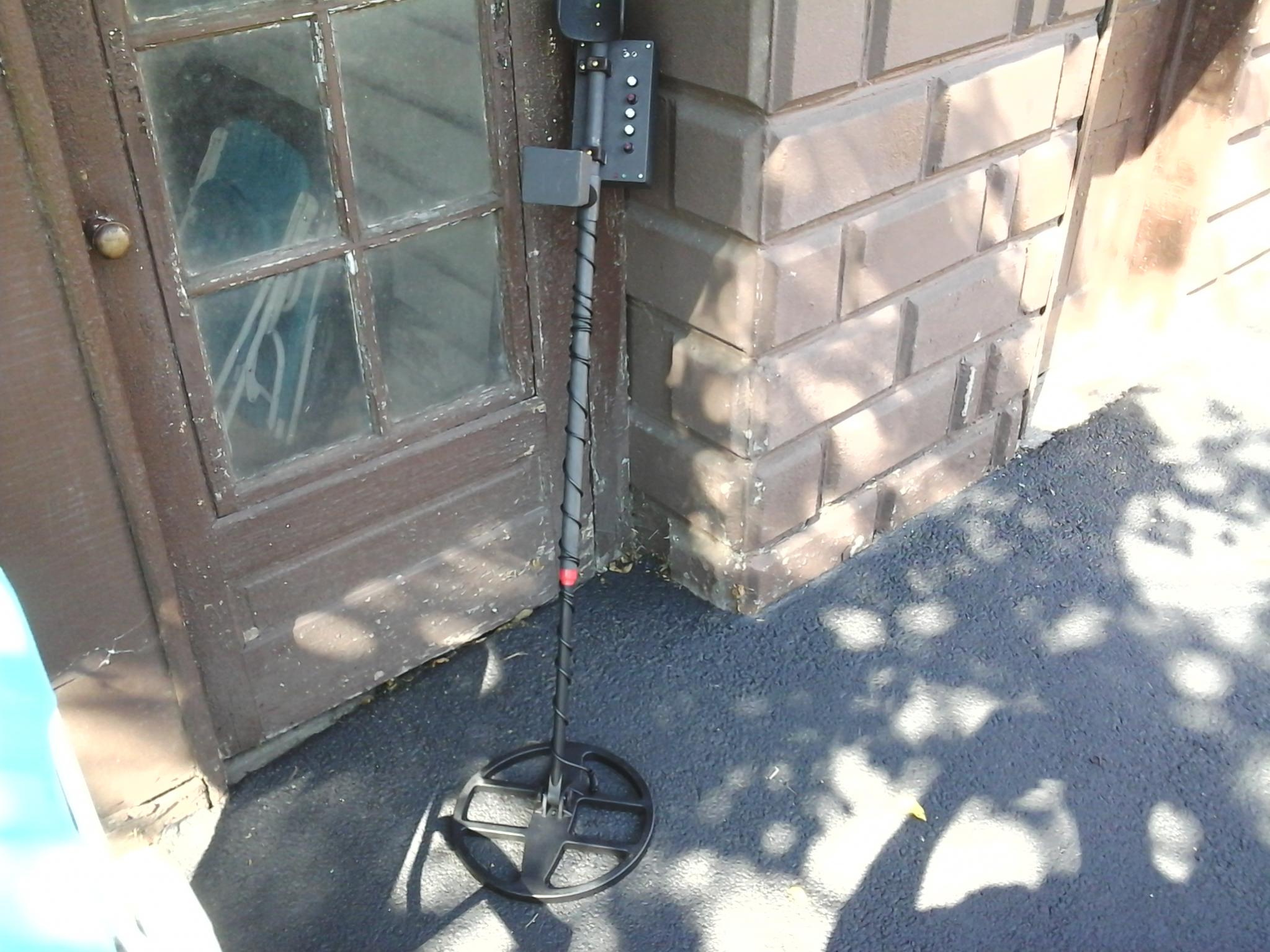

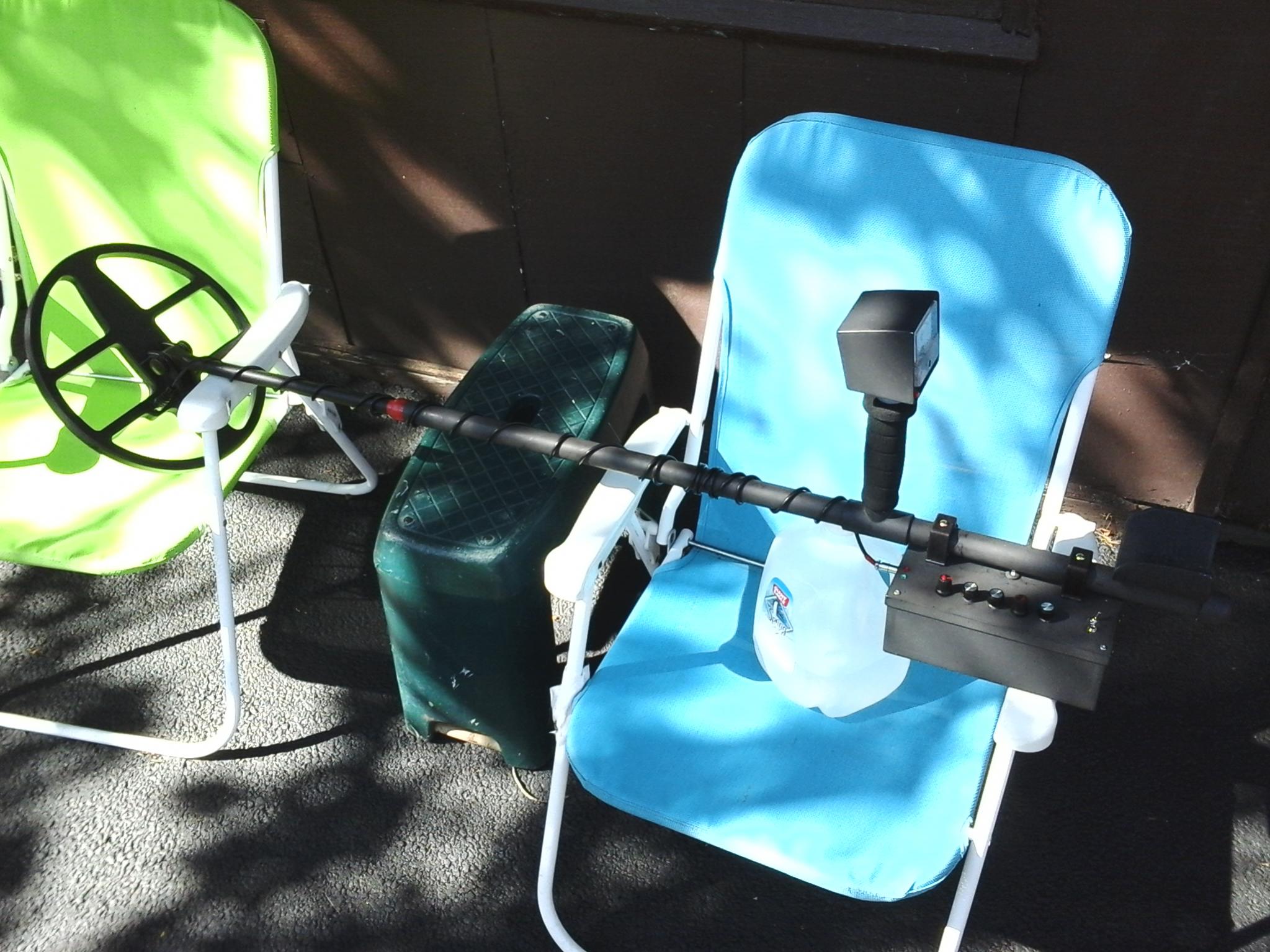

                            • so if i lower R7 to 10 or 12 k is that good or you think 5k only wondering if you know if not ill test a few different values tomorrow .oh im done building the box and stick and coil so next sunny day i will take pictures.
                              • Ok heres some pictures of it working and dont laugh its the best I could doClick image for larger version
