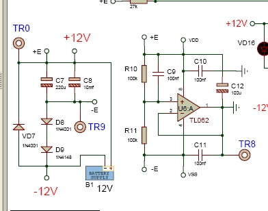

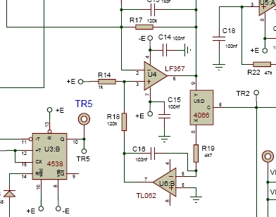

                            • hello all ,
                              been looking at the delta pulse and xr71 schematic , and i'm a little puzzled , hope somone can explain.
                              below is two extracted pics from dp / xr71 ,
                              firstly , the two op-amp's u4 and u6b , look to be feeding back / in a feed back loop , why is this , what is the purpose , checked on the net and can't find any examples that have this configuration to get an explination of what's going on.
                              my first thought was a type of automatic gain adjustment or automatic leveling of signal , the nearest thing i found that looked close was a high pass filter.
                              next question , i notice that the first op-amp , u4 has the same feed as the search coil , 12V , how can this work , as far as i was aware , the first op-amp requires a hight supply than the singnal which its dealing with , in this case it's 12.7V ish down to 12V , yet u4 appears to only have a 12V supply , ( +E) same as the search coil.
                              and lastly in the power supply pic , u6a , looks to delivering a regulated , but low current 5.3V supply to a reil noted with the ground symbol , been trying to work out a voltage scale for this detector , (-12V) = 0v
                              (-E)=1.4v
                              earth=5.3v
                              (+E)=12v
                              can't see anything higher than 12v so still puzzled as to how u4 can work.
                              i could be blind , and haven't seen it yet , but this is doing my head in , please help.
                              pics on next post , forgot to add.
                              • hello , pics below.
