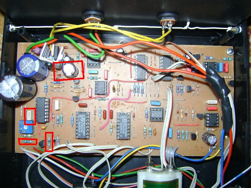

    Hello Mike Bg and forum,
    You think instead 80uS arround 100uS on TR 2 will be allright?
    Marius, you should adjust it for best results with the target. No need to measure it. But measure the battery current and pay attention of TX transistor temperature.
    • Originally posted by steaua581 View Post
      Thanx for your help ..You think instead 80uS arround 100uS on TR 2 will be allright?
      Marius
      hi Marius,
      you have to change somes composants az tell Eugene...
      -R47,R49=2k
      -R5=2k2 1w
      -R6=1k
      -C7=220uf (not 1000 uf)
      -C1= 15nf (not 22 nf)
      then i think you get best result...............regards raff33

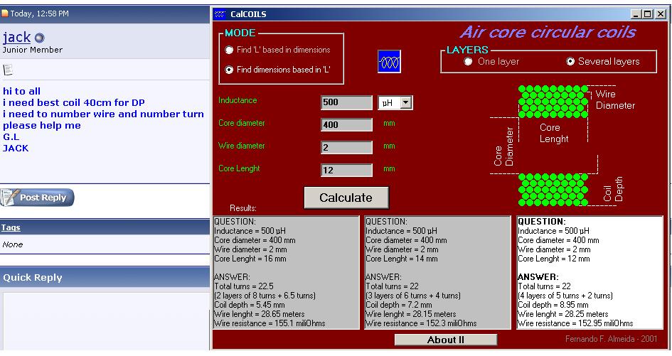

                • hi to all
                  i need best coil 40cm for DP
                  i need to number wire and number turn
                  please help me
                  G.L
                  JACK
                  • Originally posted by jack View Post
                    hi to all
                    please help me
                    G.L
                    JACK
                    enjoy.
                    • TANK YOU KT315
                      FOR 40CM COIL >>>>>22 TURN NUMBER WIRE 2MM (14SWG)OK?????

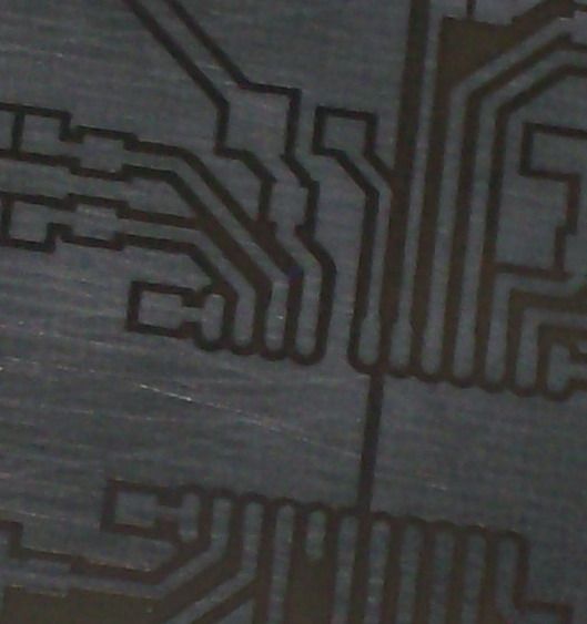

                            • I am going to build the Delta Pulse Metal Detector. Only, I am indecisive about which version of the PCB I will use. Both versions, the single-sided and double-sided PCB designs seem to work OK judging by what I have read.
                              However, although more compact in design, is the double-sided PCB version worth the extra hassle. And I am referring to making a through-hole specimen in which the top and bottom layer are though-hole galvanically interconnected. Well, I am going to have to make this decision on my own, for I have not yet read any posts about layout disadvantages between both PCB versions. I would have to make extra expenses in manufacturing the double-sided version. However, materials obtained (extra expenses) to make a double-sided through-hole PCB version will come in handy for future projects too. So, whatever you decide for yourself, maybe the following links may be of interest to you.
