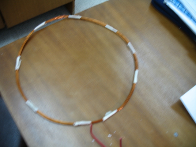

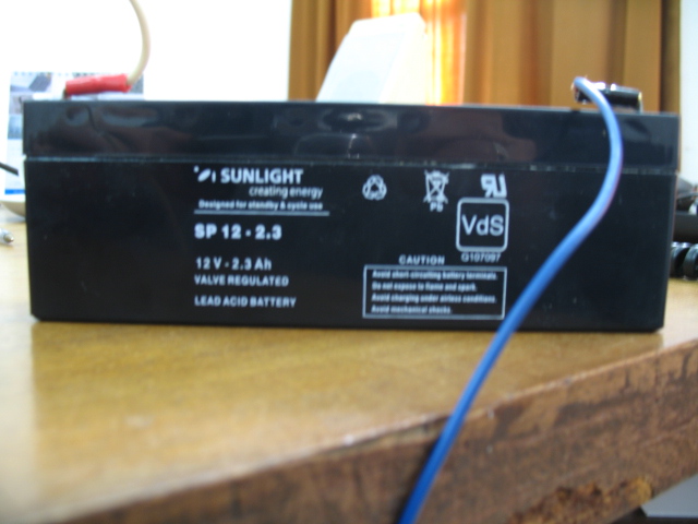

      - Battery : 12V 2.3 AH
      - Serach coil : ø25 cm, 30 turns of 0.5 enemable CU
      - Volume capacitor (100 ohm) not assembly

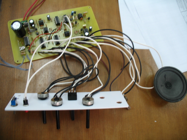

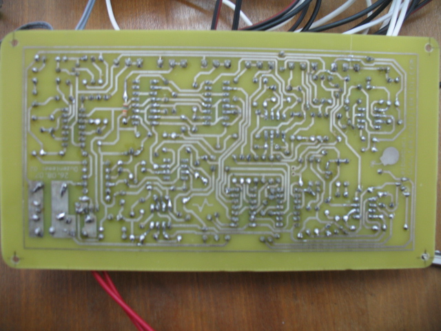

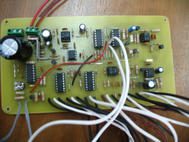

            • Originally posted by apocalypto View Post
              This the pictures of my delta pulse
              Turkish PCB layout? I know nothing about it. in my opinion you must check the layout and have a list of mistakes on PCB to fix these up, to foresee all. you did not measured resistors and capacitors, do not check all transistors before soldering into PCB. I am not a magician to say outright where you have the problem.
              • I cheked all ressitor, can you give me some point test (voltage between point.....) to localised the problem?

                    Hello apocalipto
                    The tests I performed with coils of 25 cm. in diameter, worked well with damping resistance of 500 ohms or less, on an experimental test, never got good results with 2.2 K, always 680 ohms or less and medium-sized rolls of 40 x 40 cm.
                    Sincerely
                      how? what way you see? if PCB is good quality made and without mistakes, you soldered all details checked you get absoliutely stable working device RIGHT OFF!
