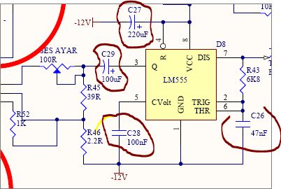

          Jap thank you for help my problem is in the sound
          I hear nothing in the detection
          I think the capacitor related integrated circuit 555 is not calibrated
          I value the following C26 and C28 voltage is 100V
          capacitors C27 C29 voltage is 50 v
          that you think Jap?
          is the cause of the voltage
          • Hi Nicolas
            No No.
            All capacitors C26 and C28,C27 C29 are OK.
            -You are back to the zero Point.
            U say,,,, I hear nothing in the detection.How do you know?--Although the audio sound correct.
            -Tested and check T9
            best time
            j.
            • Thanks Jap
              Originally posted by jap View Post
              Hi Nicolas
              No No.
              best time
              j.
              Oh Jap ok you are right
              the transistor BC 557 is corrupt
              Now it's ok thank you
