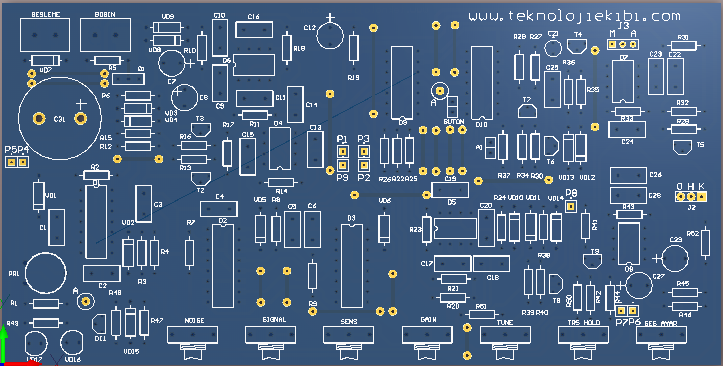

          You would be able to measure it, what kind of values it is necessary to receive on the single dots?
          A=11,2v
          B=7,4v
          C=7,2v
          D=0v
          E=11,8v

              • The pic was corrupt. The new one work fine... :-)

                        If I can get your idea to finish programming the PIC 16f878 for old version for LCD
                        I have the following measurements on points
                        A = 11.3V
                        B = 7.3V
                        C = 7.2
                        D = 0v
                        E = 11.8
                        but I do know the max values ​​to define a good descrimination
                        for ferrous and non ferrous
                        If you know the values ​​help me
                        I send you the beginning of my project

                              OK no problem thx
                              But I have a problem with the capacitor primarily the value of Voltage
                              If you have these voltage for electrolytic and ceramic capacitor value
                              send the for me JAP. I want the check
                              I believe that I have an error of voltage
                              Thank you very much for your cooperation and assistance
                              Best time you too
                              • Hi Nicolas
                                -All voltage for electrolytic=16~25v
                                -All voltage for ceramic capacitor =16v
                                -ALL voltage for mkt,mylar capacitor =63~100v
                                best time
                                j.
