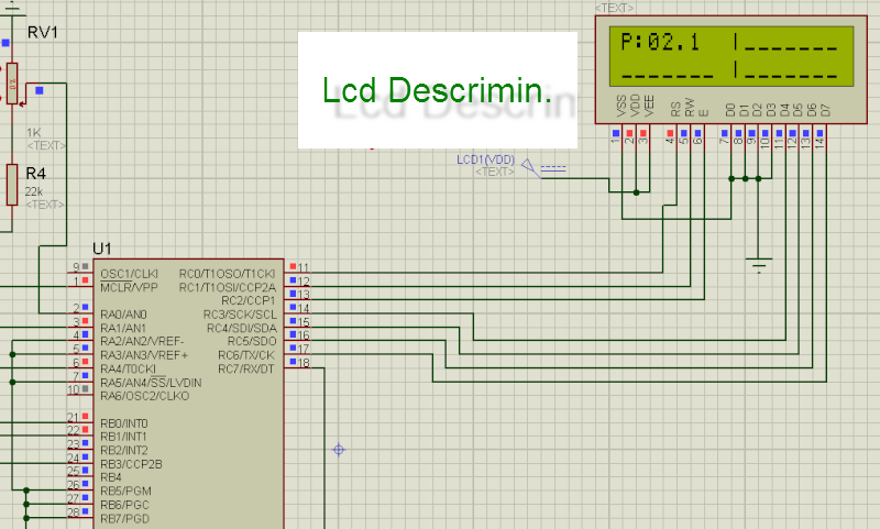

          -RE:What the number and name type of LCD ?
          -connect two LED .
          see pdf!!

          • hi jap
            the number of lcd is 162B-D REV.A
            lcd 2.16
            thank you
            best time
            pegeon.
            • lcd
              Hi pigeon
              -for the number of LCD--->u connection rong.
              -for RX see pdf 1...ok
              -for connection see pdf 2.
              --connect two LED for discrimiation,its test if pic work..ok
              best time
              j.

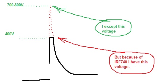

                  hi kt315.
                  after doing these work can i reach more depth or not?
                  i asked this question because i see a cut off(400V) on flyback voltage on oscope.its because of irf740.Click image for larger version
                  • your problem is that you look on schematic and do not wish to notice there HV diode in DRAIN pin of the IRF740. this mod is being done ESPECCIALY FOR WHAT you WRITE NOW.
                    • In terms of "energising" the targets there is not much difference between the spiky and flat top response. There are two differences though, you'll not observe any arcing in standard cables so you'll not fry your pinky in a process, but the avalanche limitation is quite noisy.
                          I know what you say.i added this diode before but result wasnt so good.I dont want explore my problem any more here.anyway thanks for your help.regards

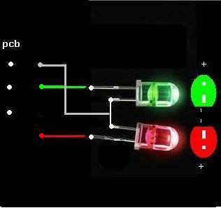

                            hi jap
                            to finish this problem can you give me points - and + of the LEDs. and the location of point P1 P2 P3 P4 P5 and P9 on the delta pulse klasik pcb.
                            thank you very much and sorry for the inconvenience
                            best time
                            • Originally posted by pigeon View Post
                              Hi pigeon
                              two LED for discrimiation.
                              best time
                              j.

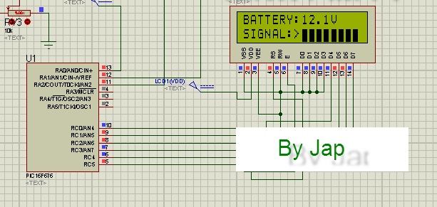

                              • Originally posted by jap View Post
                                Hi pigeon
                                best time
                                j.
                                Thx Jap for your help to All
                                I tested the Hex file his Working good and you are reason of these value for RX
                                I used two RX = 4.7K
                                Finaly I need your English version for Hex file as the first
