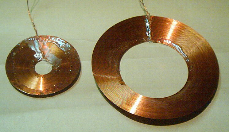

                  • hi porkluvr & kt315
                    can you guide me to make nice flat coil for dept please?
                    thank you
                    • hi alonejax, what sizes of coil you mean? I used only 1x1 m coil in my practic.

                          • hi dear kt315
                            i want to make 40*40 coil please
                            some boady let me this coil have better sens than normaly coil
                            is it tru?
                            thank you for replay
