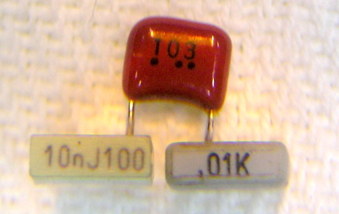

                  • Hi Neomio
                    thanks for your reply
                    I am sure for resistor it is 5k6 and pot is 22k
                    but not sure form capasitor ,on it it is wirtten as 01J250
                    seller gave it as 10n to me . is it wrong???
                    • Originally posted by okantex View Post
                      Hi Neomio
                      Should be .01, if it's 0.1 it's 100nF.
                      However, try to check frequency and pulse with!
                      Ciao
                      • is it wrong???
                        yep. wrong. you must ask seller to give you 103J250 (why 250 Volts? you can take capasitor on 50 V!). this is 10 nanoFarads what you need of.
                        • Thanks KT
                          good shot.
                          it sstart giving sound ,but not regular and clear for metals.
                          also I burned 2k2 again after correctin 10n .
                          I need new 2k2 but there is still fault.
                          thanks for helps
                          • if you mean R5 so its power must be 1 Watt and more. maybe you tune on very big Pulse Width via P3 and this is your problem?
                            • capacitor
                              Actually, notation for capacitors could be even different. If you take a look at the picture, these, for example, are three different capacitors with the same value: 10 nF. So, you could find 10n, 103 or .01
                              For R5, if you can't find at home a resistor of the suitable power, certainly you'll have four resistors of 10K 1/4W. Just connect them in parallel and you'll get a 2,5K 1W...
