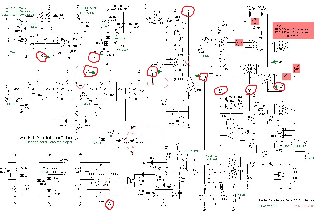

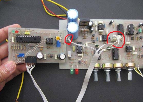

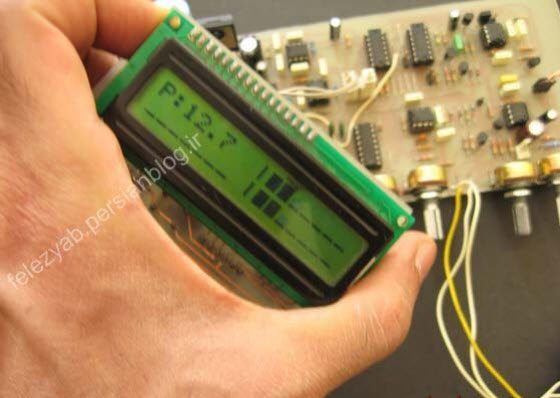

    excuse me pin name are tr1-9
    i think for divorce gold & metal

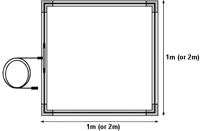

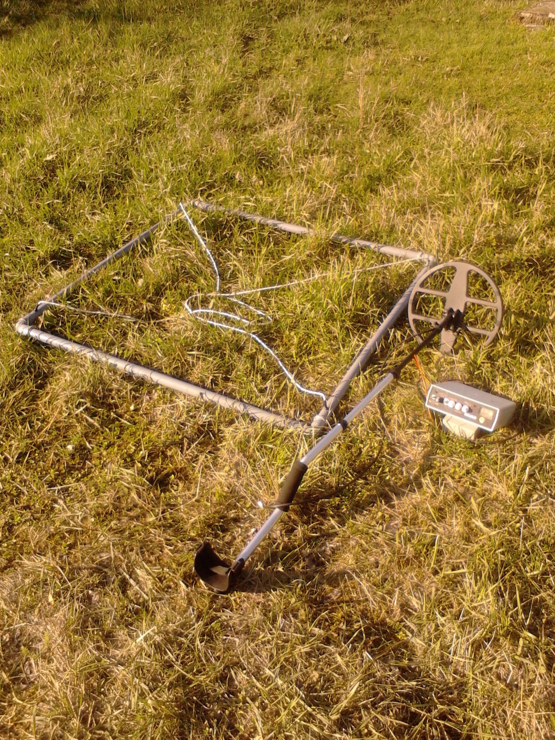

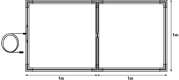

            how i can to make big & good coil example 1m*1m
            if i make that , i must change damping resistor?
            flat coil is better or normaly coil?thank you
            • Originally posted by alonejax View Post
              how i can use pr1-9 pin in delta board?
              Like signals get connected to like signals.
              For instance:
              TR1 = TR1
              TR2 = TR2
              TR3 = TR3
              and etcetera.
              "Shorthand" schematic notation so that the designer would not have to run signal wires all over the place, looking like a bowl of spagetti.
              porkluvr
              I would like to see you (or anybody) try to make a 1m x 1m flat wound coil. That would be a neat trick, but a waste of time.
              No, don't mess with spiral wound coils until you become expert.
              A 1m x 1m rectangular coil has been described here many times. Yes, depending on what coil you use a different damper may be required.
              You might try:
              10t 0.35mm wire PVC or Teflon insulated wire. Not magnet wire.
              1m x 1m rectangular form
              result:
              ~450uH, 7 ohms (these are wild estimates)
              >40.2m of wire is required.
              If your current damping resistor works with the coil you described earlier, it should probably work with the coil I just described.
              The problem with what I just told you is that, wrapping the wires tightly is necessary but becomes difficult with a large coil form.
              Some people like to use Cat-5 wire and splice individual sections together. I can't really help you with that except to tell you that it has been described before, do your research (google.com search is good). READ previous posts in this thread.

                any body can to make adc(analog digital converter) for use in delta to sence betwin gold & metal?adc show change voltage or frequency or current to graphic per cent in lcdcan make with avr or pic or .. micro procesor
                  porkluvr

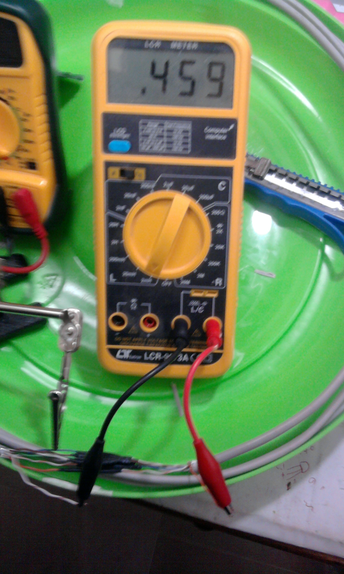

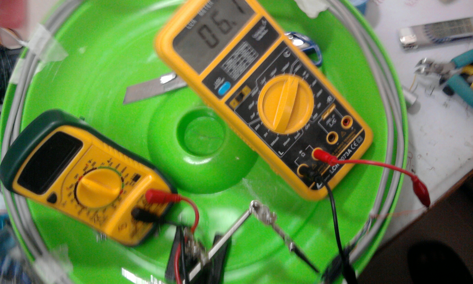

                  Look it
                  I use cat5 for my frame 1mx1m 2turx8 = 16 turs is good for me
                  and for my coil 36cm 6.1Ohm 459uH it is Best deep 90 cm for a printed circuit plate
                    you may be have to look in QED side if want an explicit detector on gold. this subject I mean Delta Pulse is not for you and leave it. Delta is deeper working in all metal, has simplest in realisation schematic.

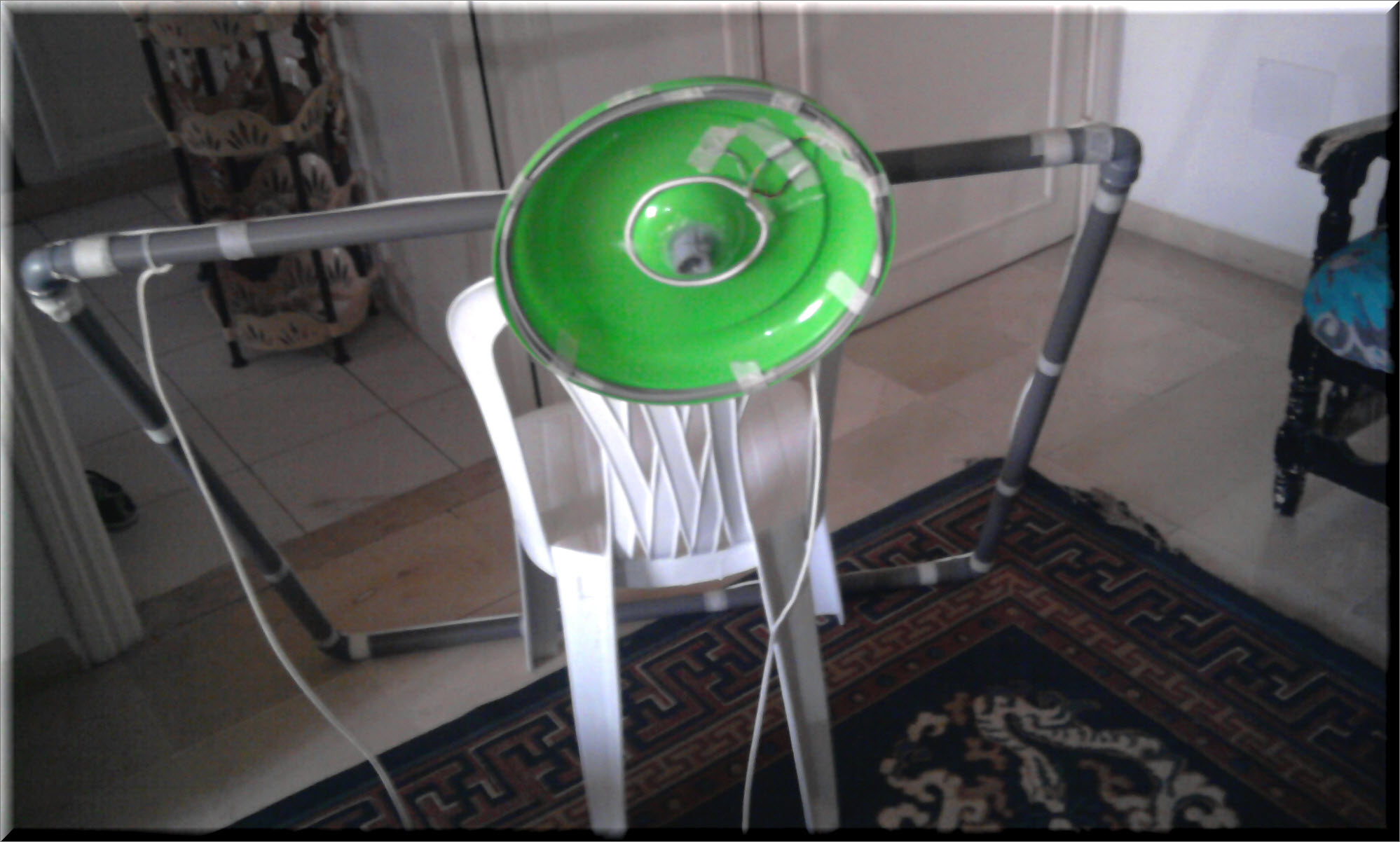

                    • What value damping resistor should have for 26cm coil, wire 0.45 mm, 35 turns for better results? Which is the best frequency for such a coil?
                      • Originally posted by zlatica View Post

                          Thank you kt315, I will try. I need a coil for small items,, like a coins.
                          • if for coins tune first strobe delay to 10...15us meaning preset of MAIN DELAY pot.
