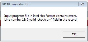

      Thanks, Orbit.
      But the TeknolojiEkibi Demo you uploaded still gave error message as follows:
      It seems that the Demo file could be damaged.
      Ciao
      Speedy_G

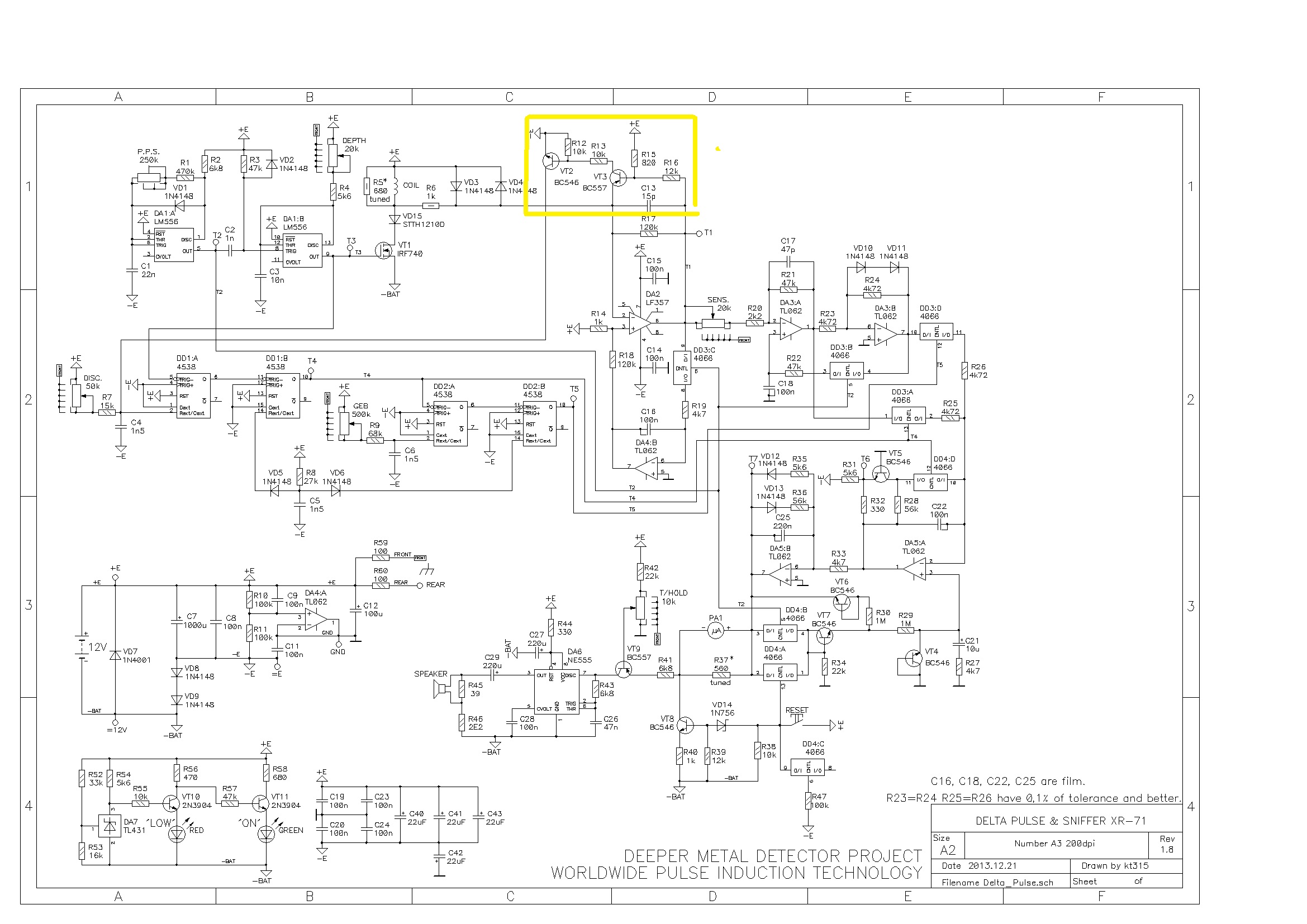

                          • Hey Guys I often wondered what the circuit framed in yellow does in this design?
                            Modify pulse width based on ground loading? Anyone know?
                            • Originally posted by Silver Dollar View Post
                              I do not know exactly.
                              I learned that when a large metal, coil to approaches increases the delay, possibly to avoid overload.
                              In a modified DP for coins (decrease delay and increase in frequency), disconnect the collector VT2, to bypass this circuit.
                              By this I get softer the "delay" setting.
                              • had answered many times... something like a protection from overloading of amp part, on big target near coil. working such way. if a signal gains to some level this circuit turns on and moves out primary sample pulse in a range with more low amplitude - ie at right side of 'delta' pulse.
