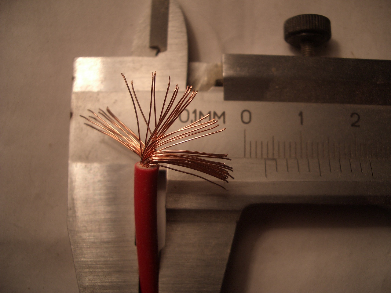

      what kind of wire you are used for 1*1 coil ?
      please guide me.
      Thanks...
      • I use a 25 cm coil serach 30 turns of 0.5 enemable CU it is correct?
        • Originally posted by Belief View Post
          Hi KT315
          please guide me.
          Thanks...
          I used isolated wire what you can find out in any electrotechno shop. it is 3,5 mm external diameter, 2 mm diameter of copper.
          good luck!

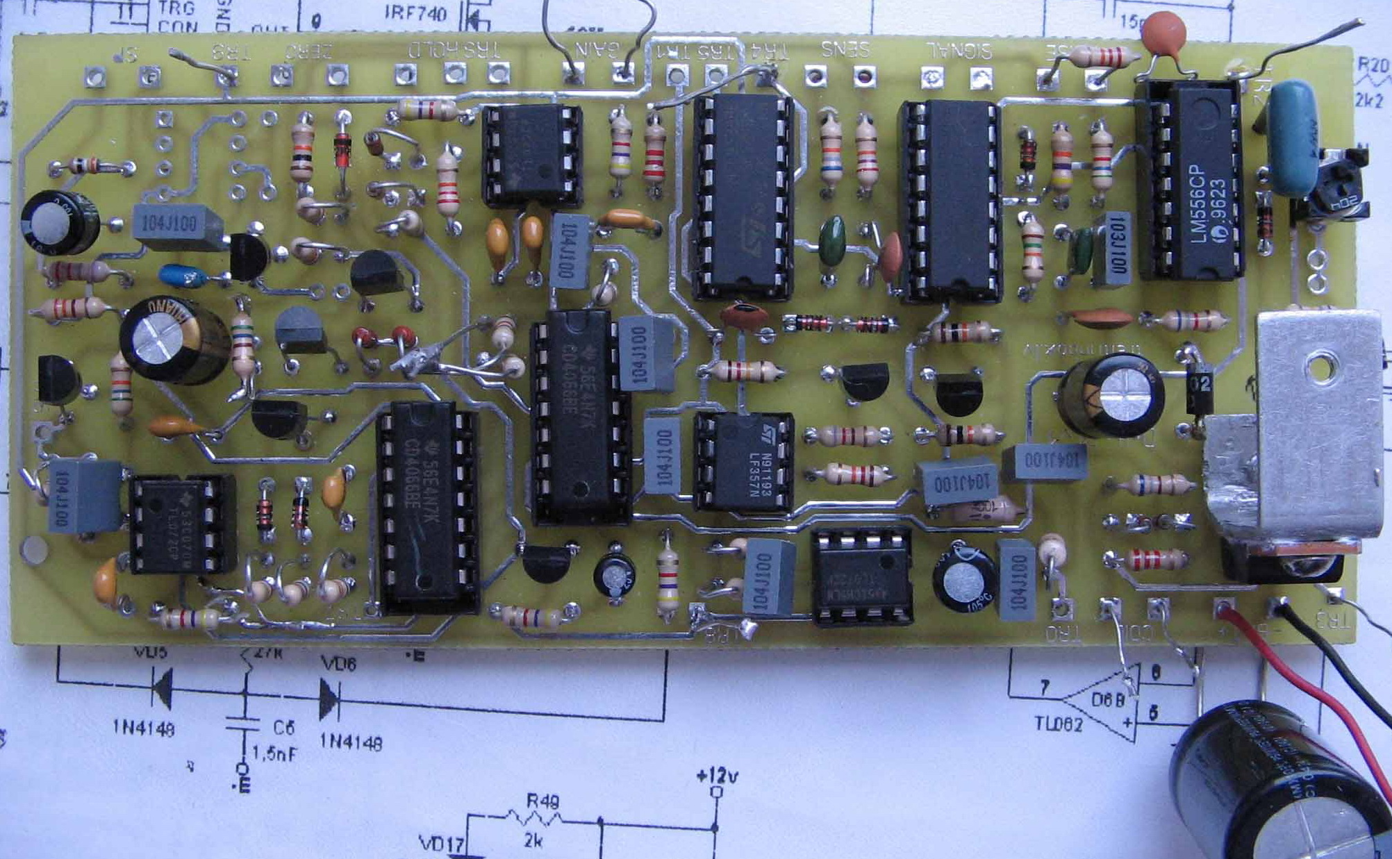

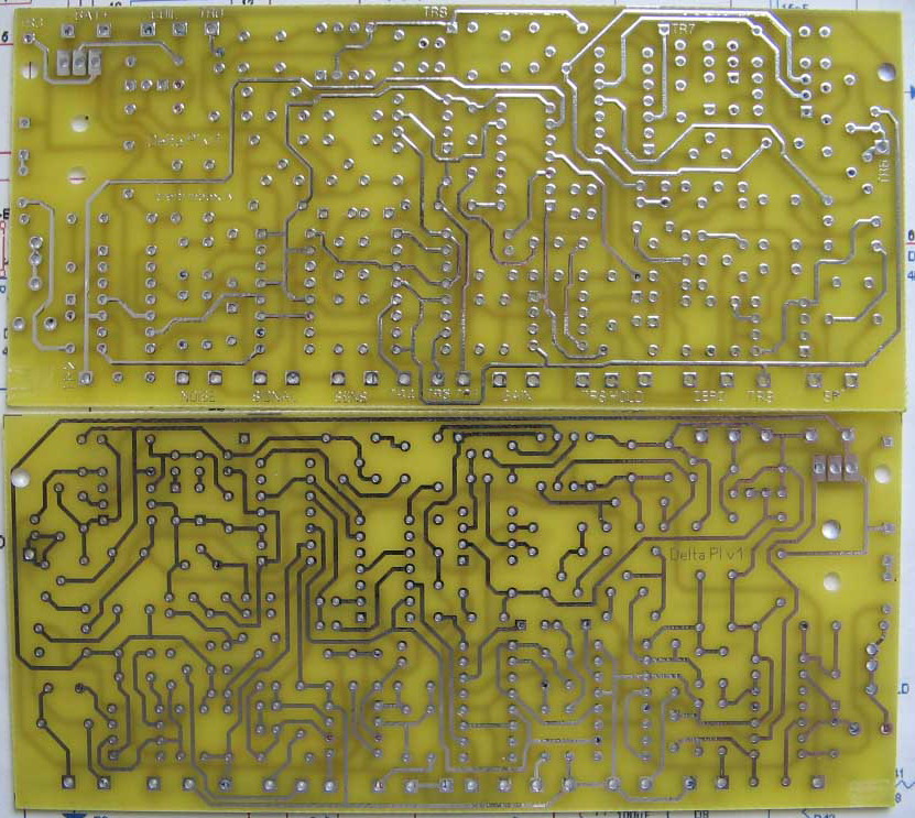

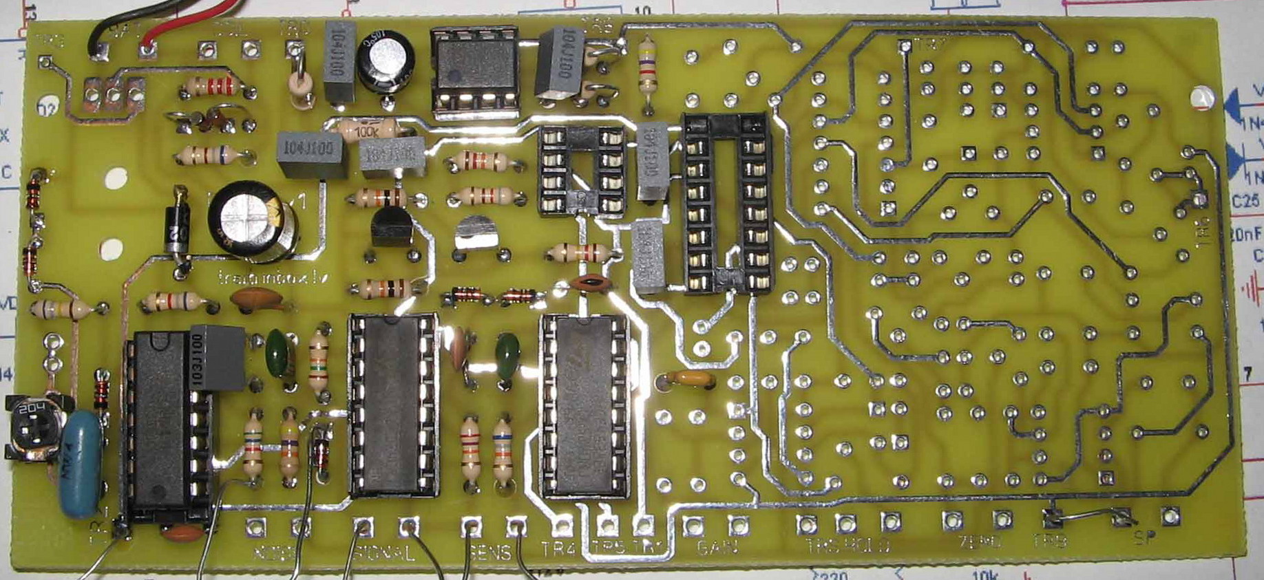

            • dear batman,
              I used 'classic layout' PCB that did my friend in Latvia. I see many versions of PCB layout in the forum... huge amount!... can say nothing about these! you do all on your funk and risc
              • I am also using that pcb. Made over 30 DP's so far.
                Very good pcb indeed!
                • oops! all photos above are not mine. these done by Sergei, aka Treiti.

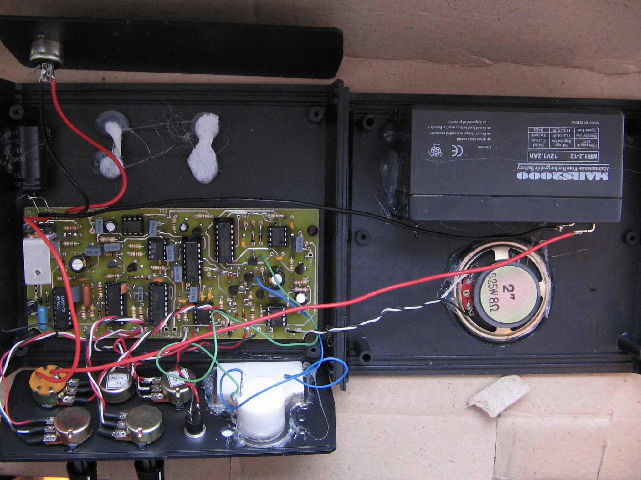

                          • Hi kt315, finally i solve my problem with no sound from delta pulse. The problem was a broken volume pot.
                            The potenciometer, was rotating fine, but for some reason, there was not resistance. I presume a factory fail.
                            Anyway, thanks to you and all members who help me to find the problem and for shure i had learn a little more about delta pulse and how to detect fails.
                            Nelson
                            Nelson, with T9 soldered you must get a sound in any THRESH tuning position, I think. try reconnect that I did draw here and you must hear a sound. decrease R44 value to 20-33 Ohms. desolder R45 too. also check R46 - it must be 2-2,2 Ohms.
