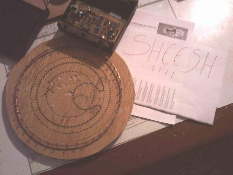

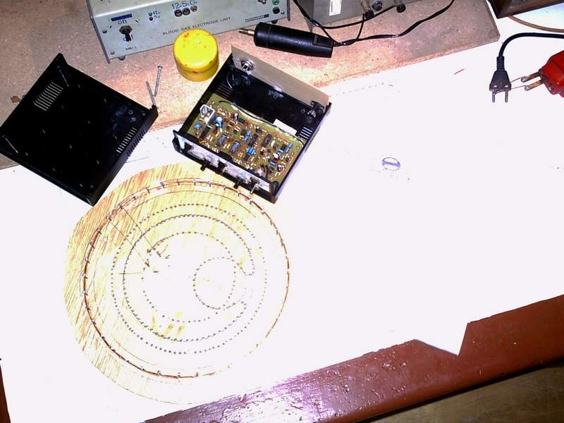

      • It is alive?!?!?
        I just finished my fifth DP in this year.What to say? Somehow i feel satisfied
        with progress i made building those.
        Every of those five working very good from a start. No problems at all.
        I reached the point where can be free to claim that my "machines"
        are good and pretty accurate.
        But i still have a lot of problems with coils!?
        I just downloaded "Making a Fast Pulse Induction Mono Coil" from Joseph J.Rogowski
        aka bbsailor.
        Congratulations on such fine,neat and accurate theory bbsailor! I do agree 100% on
        all you've been talked about.
        I just made a coil; 26cm diamm. 25 windings, wire 0.35-0.4mm(close...i cant tell,i
        busted my mickrometer last week)....Resistance of a coil is 3.3 ohms.
        Buster is 2K2,frequency is 120Hz....
        Results are good. 2cm coin it can detect on 30cm distance.I guess,it could be even
        much better.
        It is now in "experimenting" phase so i am not using any resistivity in serie with
        coil....so it is just 3.6-3.8 ohms(including cable).
        After 5-7 minutes, IRF740 is still cool!?
        I am, sort of confused,amazed???
        But there is a certain problem. "Playing" with Treshold knob, i can put device
        in position to be unstable and "sing" like canarian???? Even than,detection is
        very good,fet remains cold and nothing bad happened????
        I am presuming it must be something about coil, resistance or dumper....
        Between those five DP's i made,this last one is the very best...i have that
        feeling. I also payed a lot of attention on components. I used mostly pp caps,
        wherever it was possible.I used 1% resistors also....
        It will need some more experiments to establish right values of dumper and serial
        resistors,but so far it is acting very good.
        Until now,all previous DP's needed coil with resistances over 6 ohms, to remain fet
        calm and cool,this is first one working cool with <4 ohms coil.....so far.
        I will experiment more,these days.If discover something interesting i'll post here.
        Merry Christmas and happy new year to all!!!

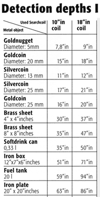

            Hi all,
            A good PI machine must be follower to this table.
            sorry for my bad english.
            Happy new year,
            Best Regards
            • Hi. Delta Pulse is a low frequency detector. It is not optimised for small objects (large delay time). It is optimised to work with large coil for large objects. My DP is very good at large objects (with large coil) but medium at coins (with 10in coil). If you want a PI for coins then make it at 400Hz and try to change the delay time or (better) build an other detector. As i know (from your letters) all you are interesting for large coils so you want the detector for large objects. I believe that there is not a general purpose detector with perfect performance.
              Ivconic Hi. My friend put more turns. DP needs a coil at least 600..700uH. The 1x1m coil from Mikron is about 1mH.
              As for table from 1843 .... what to say. I think that are the best distances for every object that can be detect by a PI detector.

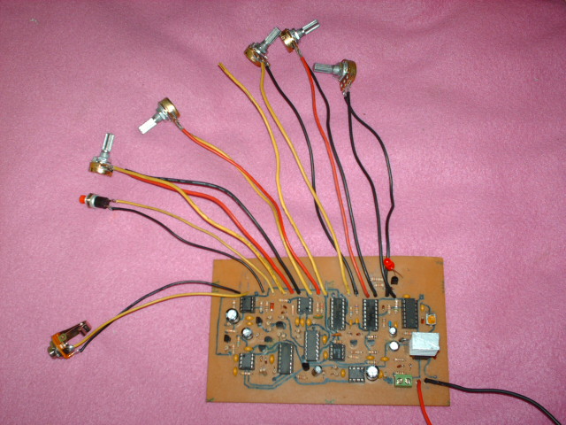

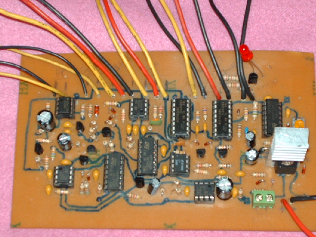

              • My delta pulse not working good
                Hi again, well i have check my delta pulse and i found some missed conections that by now are connected.
                Has i said, the detector has power on the coil (440 mH). No metal detection. Coil resistance 1.8 ohms. Damping resistor 3 ohms. Sometimes sound comes on with a high tone that is decresing to the point you can get a little cliking and varing it with TRSHOLD. But sometimes you don´t get the sound thru the speaker. it looks that this happends after the detector is unpluged from the batery for a while. Also when the sound comes, it feels a little unstability.
                I haven´t check pin 1 of IC 5 jet.
                I also replacedIC 8 and IC 9, but nothing really change.
                I m not electronics expert, this is just a hobby for me, so i really need more details from the circuit. I also traid to see the pictures publish on the forun, to see if i had made any mistakes when i conected the capacitors polarity and diodes polarities. I m really turning confusing with this project, so any experience like geo and Ivconic will be very appeciated.

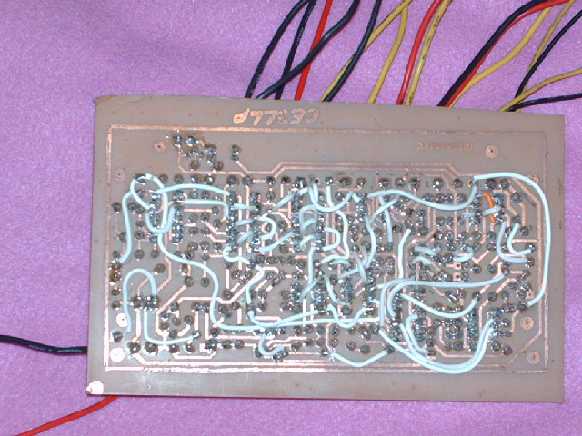

                ivconic, i also tried to follow some pictures and after that i burn LM 556, that now is NE 556.
                I forgot to said, that this is a one side PCB, that i had fixed with jumpers to get a two side kind PCB. By now i m still cheking if i had made a bad or missed connection, but for me everything looks like a good job.
                In advance, many thanks
                Nelson

                  • My Delta Pulse pictures
                    hera are pictures of my DP.
                    Nelson

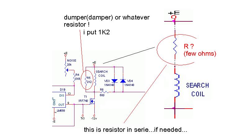

                    • bbsailor, i forgot to check this out.
                      Yes the damping resistor is 5 ohms and the coil 1.8 ohms.You said that the damping resistor must be btw 500 ohms and 1 K. So if i use the 5 ohms damping resistor, what can work wrong ?
                      regards.
                      Nelson
                      • 5 Ohm Damping Resistor
                        Nelson,
                        If you use a coil that is 1.8 ohms and a 5 ohm damping resistor, your current fall time will take 360 ms and you will miss all targets and generate a lot of heat in the coil, damping resistor and MOSFET.
                        The 5 ohm damping resistor value is wrong.
                        Look at all the PI schematics on the Geotech web site and see that most coil damping resistors are between about 400 and 1000 ohms.
                        The damping resistor is the resistor that is in parallel with the coil.
                        I believe this 5 ohm damping resistor, that you are using, is one of your problems.
                        Post the schematic of the PI metal detector that you are building so we can help.
                        bbsailor

                          • more...
                            :confused:
                            Nelson,friend, you made terrible mistake!
                            You are confusing "dumping" resistor with serial (with coil) resistor!
                            Dumper or dumping resistor is already on schematic,valued as 2K2. Of
                            course this is not obligated value, depends of coil type mostly.
                            But "serial" resistor is not sketched on schematic! This probably
                            confused you?
                            Dupming resistor should have values not less than 400-800 ohms and not
                            higher than 2K2 or 2K7 in 99% of cases.
                            "Serial" resistor should be just few ohms, if needed at all. If you
                            made coil with resistance over 4-6 ohms, you wont need to even think
                            about "serial" resistor at all.I made more coils without to use any
                            extra resistance in serie, just a few with serial resistor...so far.
                            Another possible problem of yours,might be bad pcb!? You should respect
                            pcb that KT315 posted some time ago here.Geo too.
                            It is double-sided pcb,although top side is not complex at all.
                            I do draw my pcb's manually,it is not so hard.Vias are thick enough,
                            not a big deal to draw it slowly and carefully with thin marker.
                            We can talk here endless about possible problems that you have with
                            your DP, but first you have to be sure that your pcb has no mistakes at
                            all!
                            I can asure you that mentioned pcb is accurate, it works for me for the
                            fifth time. Only connection between 2. and 6. pin on 555 is missing.
                            I used simple wire and soldered over ic, and connect those pins. Not a
                            big deal.
                            Do some checkings, than we can easy help you to fix it.
                            best regards!
                              all!
                              big deal.
                              best regards!
