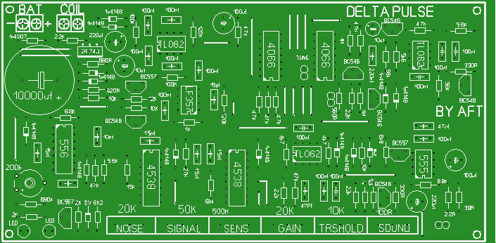

    • Singel layer pcb for delta pulse
      • Geo 1. I never saw a one side pcb for DeltaPulse.
        nelson You are right Geo. My pcb is a one side with lots of jumpers on it to configure the original board, but it must be some errors on connectios

        Singel layer PCB for sniffer xr71 and delta pulse.

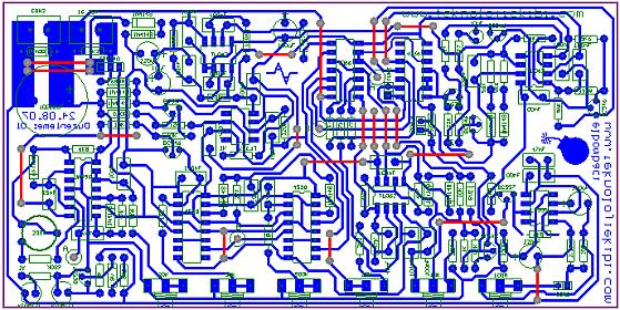

            • elbombacı design of delta pulse single sided
              • http://www.teknolojiekibi.com/yeni/i...ic=4.msg6#msg6
                elbombacı designed
                http://www.savefile.com/files/1018088
                • Hi Nelson
                  No, I don’t test yet .because it completed later.
                  Drew it with sprint layout 4 .can you send me
                  Your drawing?

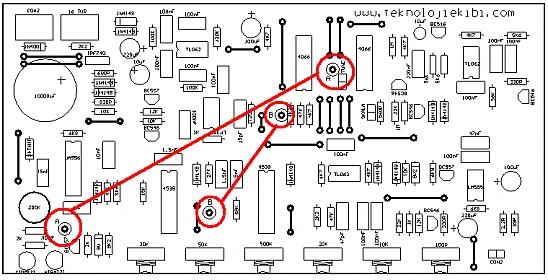

                  • Hi erolunall
                    Had differences between my drawing and elbombaci.
