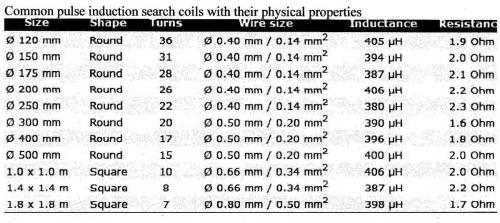

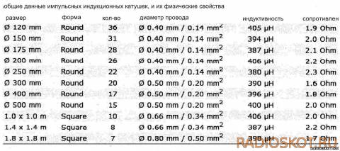

    • coil data
      • Thank you I needed that , I also have a problem there is no frequency at the output coil ???
