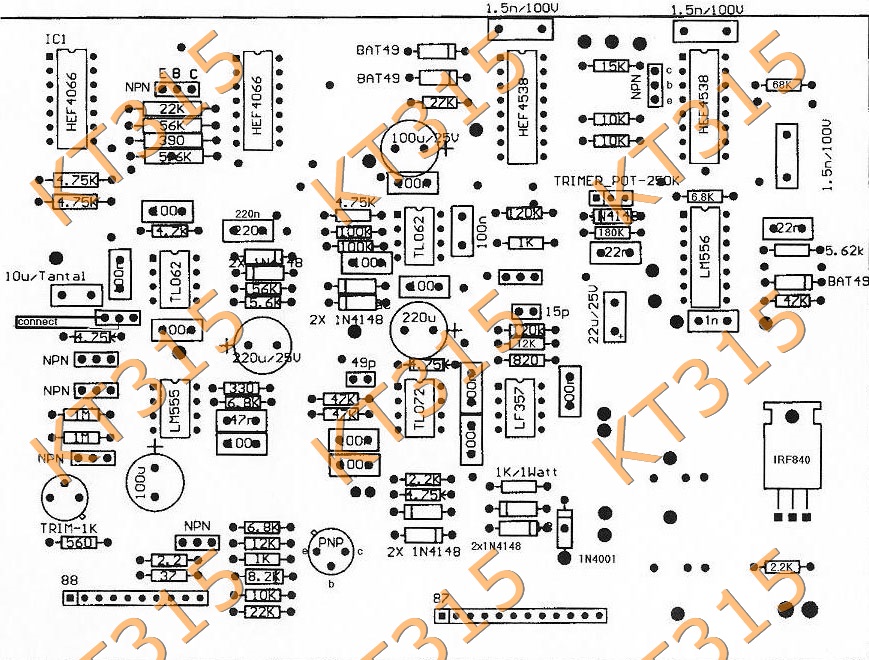

      in the manual it is written for best performance coil between 3 -7 oHm, I built one with 5.6 oHm 58 turns of 0.30 mm 38 diameter .
      0.30 mm is too small wire size. It should be about 0.6-0.7 mm
      • what is the number of turns , can this detail cause a reheating of IRF ?
        Thank you !
        • Originally posted by abdennour View Post
          Thank you !
          Pulse induction detectors work with different coils. Usually, the inductance of the coil is given as the starting point. Delta pulse typically work with coils that have an inductance of about 400 µH (micro Henry). It is not necessarily exactly 400 µH, but this approximate value is sought regardless of the diameter of the antenna (50x50cm or 100x100cm). The thickness of the conductor from which the coil is made only counts for the power of the pulse emitted into the ground. After you make the coil and connect it to the detector, you have to understand the exact value of the extinguishing resistor connected in parallel to the coil. It is given as 2k2, but in reality for each coil it has a different value. This is important for the proper operation of the detector and the depth of which metal objects will be detected.

            • I am not a pro, how can I know the exact value of this resistance ?
                The resistor is replaced by a potentiometer 5k set to the maximum value. An oscilloscope is then needed to monitor the received signal. Turning the potentiometer will clear the parasitic signals. See this picture:
                http://s1.hostingkartinok.com/uploads/images/2012/03/c3a5aef7c54cff620e3cfadd696df3f9.gif
                Then the potentiometer is replaced by a constant resistor with a value equal to the one measured by the potentiometer.

                        • thank you for the photo, I begin to learn through the schematic , I do not know but when there is no frequency at the output coil I think lm556 is burned ???
                          • The inductance of your coil is too high(58 turns, .3mm wire, 38cm diameter) gives app. 4.3mH inductance. This is way too high. The 2.2K damping resistor is for coil with much lower inductance ~400uH. You must wind a coil with about 22 -25 turns, this would put you in the ballpark, then you can vary the value of damping resistor for your coil.
                            KT315 is right. Your pictures suck! If you want assistance here then you could at least take better pics of your pcb(both sides), otherwise everything is just abra kadabra and you might as well chuck it.
