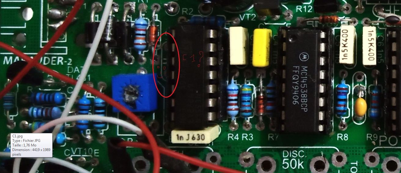

        • HI CHUUBABA....YOUR C1 CAPACITOR IS MISSING!
          • Thank you TufaN and Tifred for your attention to the board.
            C1is soldered on copper side ( back side of the board)

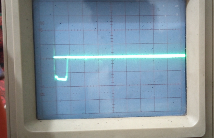

            • Chuubaba, did you put scope probe to leg 6 of the LF356? What did you see?

                        • Chub, that is a very sharp and clear image you have shown, I've never seen better. The scope trace is very nicely focused and the camera is high resolution, congratulations.
                          I can barely make out what's going on.

                            How much is voltage at pin 6 of lf357??
                            • on pin 6 - this is OUTPUT of operational amplifier (opamp, op amp, op-amp) - is impulse signal,
                              it is 'cutted 'delta' pulse on its top' but inverted (cutted by two diodes VD3 and VD4). the opamp is in invertor circuit usage here.
                              so you see via your oscilloscope the 'low part' of whole 'delta' pulse on coil.
                              no DC signal you would be like to measure by a tester. without mos-fet on output of the opamp is GND (ground, zero) level, in relation to output of DA4:A.
