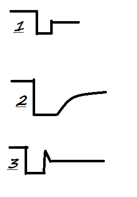

  • hallo .. i have one question .. which diagram it correct in tp3 ...Click image for larger version

        correct is clear delta pulse (not name of the detector), clipped (by diodes on input of preamp) and inverted (be cause preamp inverts the signal). 2 diagram is correct.
