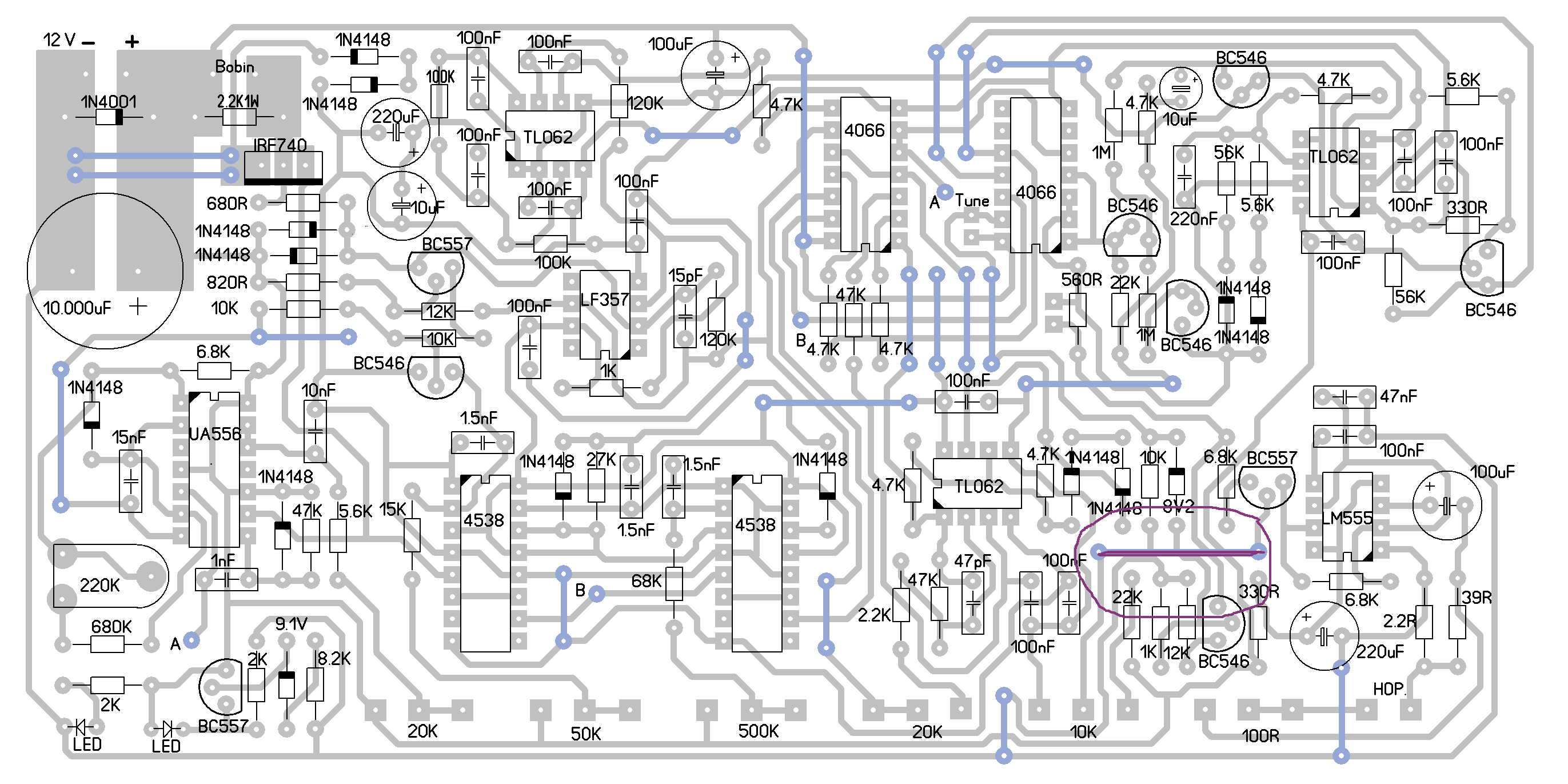

        • Hello All
          I attached single sided delta pulse in sprint layout 5 format drawed By Hakan Durmaz from elbombacı design pcb .he has www.durmazonline.com about detectors Please write if find any errors
          http://www.uploadpaylas.com/v/1450483/son.lay.html

                  • one side pcb for DeltaPulse
                    Hi
                    dear geo
                    is it really Correct one side pcb for DeltaPulse?
                    how many power? does has it value for build?
                    thanks for reply.
                    good luck.
                    • Hi. I did not construct it. But as i saw at a Turkey forum this pcb works well.
                      Download the demo version of sprint layout 5 and open the file son.lay who Erolunall has post here.
                      • Dear 786
                        I constructed it and working good.I will put picture of DP here soon.
                        Elbombacı made LCD for DP.
                        You can find below link about single sided dp but YOu have to ask elbombacı about LCDç
                        http://www.teknolojiekibi.com/yeni/index.php?topic=4.0
                        Best Wishes
                        Erol Ünal

                          • Hi Nelson
                            There is no performances changing.But very easy for building.
                            I attached parts replecement.
                            I wonder can we attach Digital ampermeter to delta pule below link?
                            http://elfly.pl/multimetr/multimetr_en_DIP.htm
