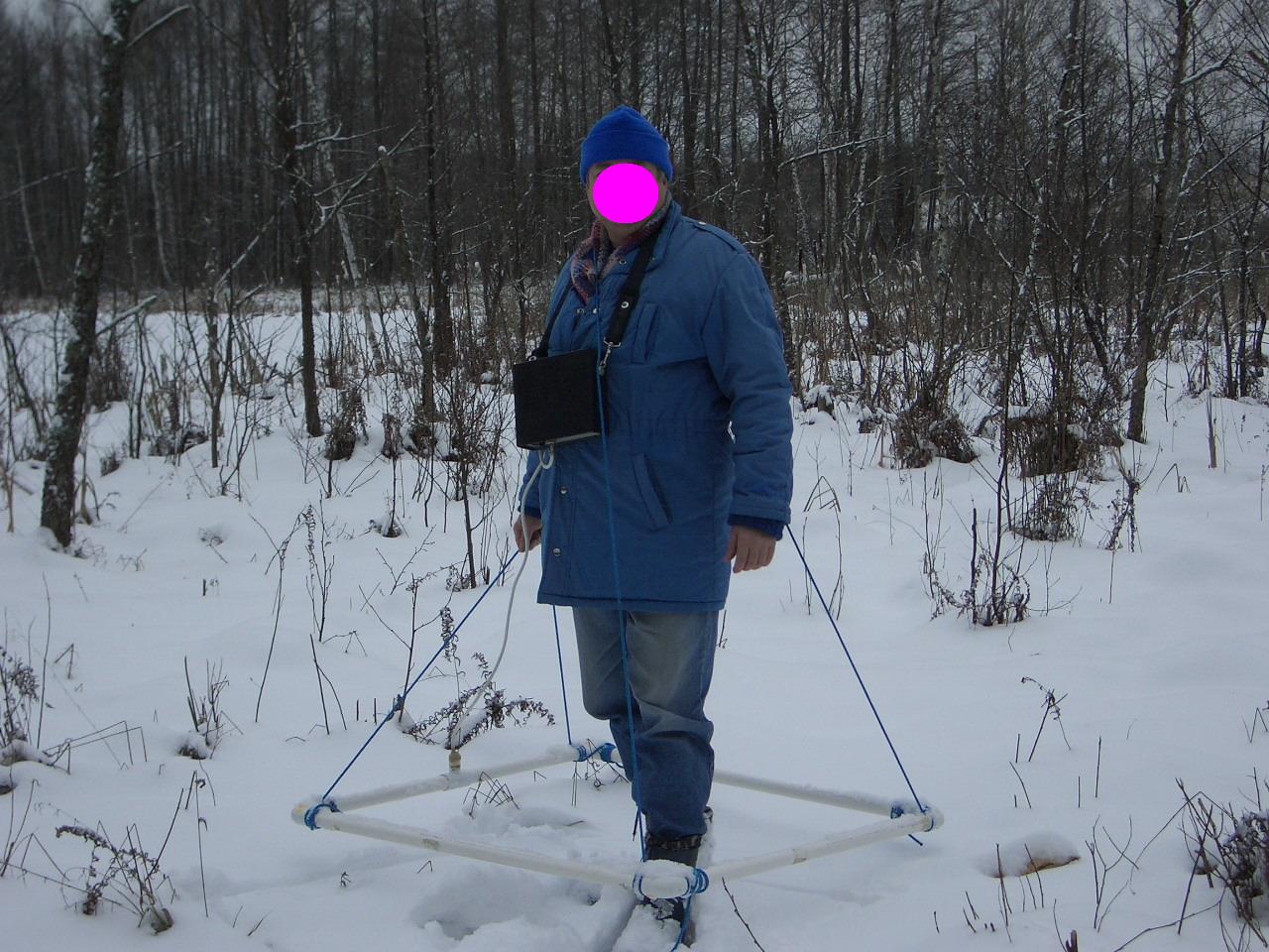

              • me and Delta Pulse at a lake.

                        • Hi kt315,
                          very nice picture from your Deltapulse,
                          please tell us your deltapulse, how much deep can detect
                          one 10*10 cm metal plate ?
                          Thanks...

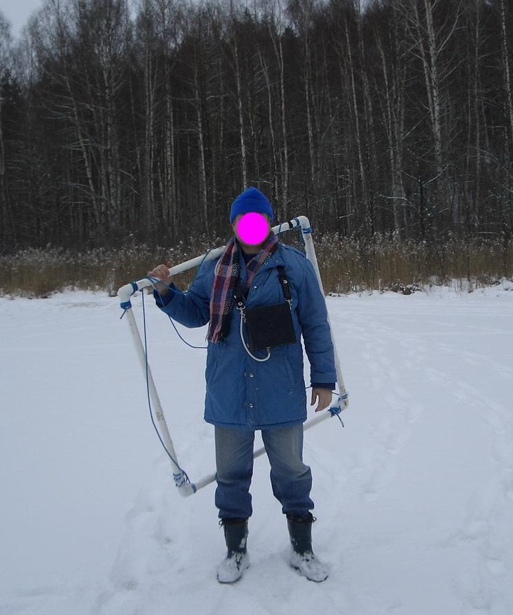

                          • hi zenit52. I tested DP only on pretty big Main Delay, 100 and more us. especcially for huge targets only. I did DP only as deeper on big targets, not interesting in small objects I can find out ordinary way. a sensitivity of DP was better than TF900. I use 1*1 metre coil. all targets that DP has found will be up on this week.
                            • a sensitivity of DP was better than TF900
                              Hi KT315
                              yes, pi detectors working more stable than TR detectors at deep.
                              Best regards.
                              • all targets that DP has found will be up on this week.
                                I waiting see it ………….
