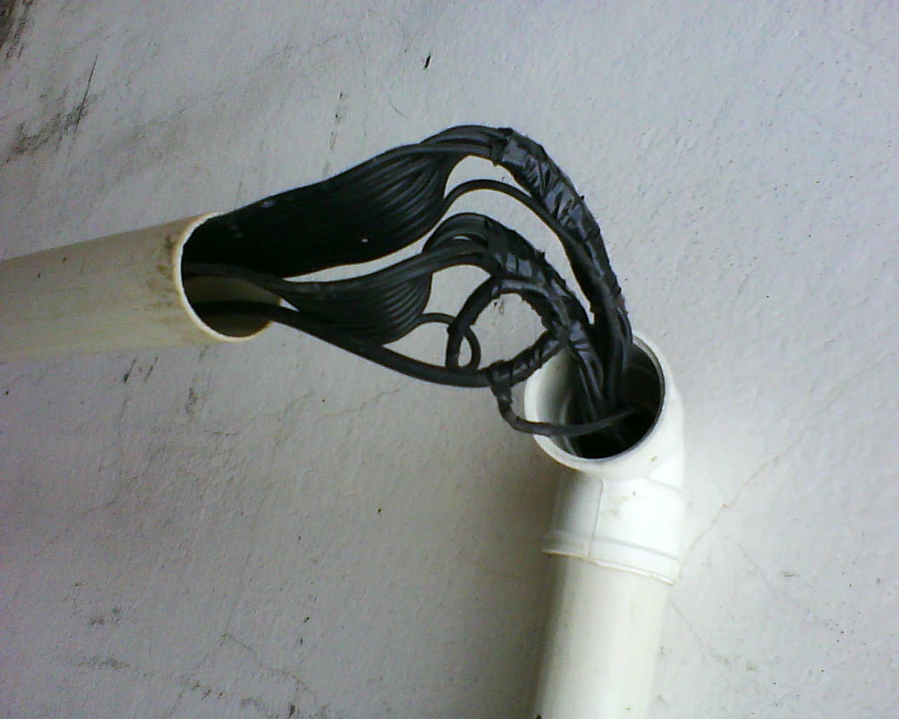

        Hello Belief
        I use flat cable 18 drivers that I provided elevator maintenance technicians, the diameter is 1 mm. approximately, the total resistance is about 2 ohm.
        I use MD damping resistance of 680 ohm, in the 1x1 meter coil added two parallel 2.2 K ohm (1.1 k ohm). The operation is stable.
        The scheme without modification as shown in previous posts.
        Sorry I do not speak English.

            HI Jose
            Would you please send me your 1*1 coil's picture ?
            Thanks.
            Iman boroumand.
            • Originally posted by Belief View Post
              HI Jose
              Thanks.
              Iman boroumand.
              Yes, I prepare the photos. A little time please.
              Best regards.

                  Coil Picture

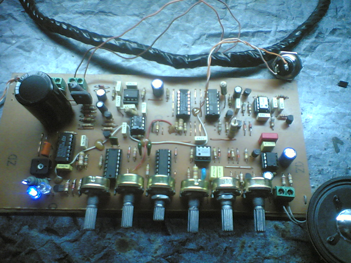

                      Dear Erolunall
                      I will try to prepare a video for next week.
                      The soda cans as are preserved, are easy to spot as iron, remember that these are ideal conditions and with maximum profit at the controls of MD and optimal adjustment of delay time.
                      Do not make major changes in the circuit, use lf357 (LF356 noisy).
                      TX power potentiometer 20 K, I use 10 K for IRF840 not overheat the 60% (approximately 120 microseconds).
                      Delay time from 20 to 30 microseconds, reducing training 1.5 na 1 n if necessary, otherwise as indicated in the scheme.
                      Good PCBs for minimum phase noise preamps (lf357)
                      Sorry do not speak English
                      Best regards

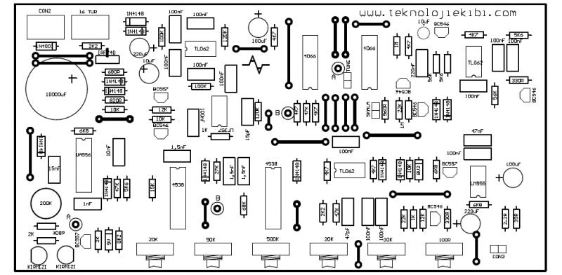

                            • hi can someone make a simple side pcb br!
                              • Hi Jose
                                I used it
