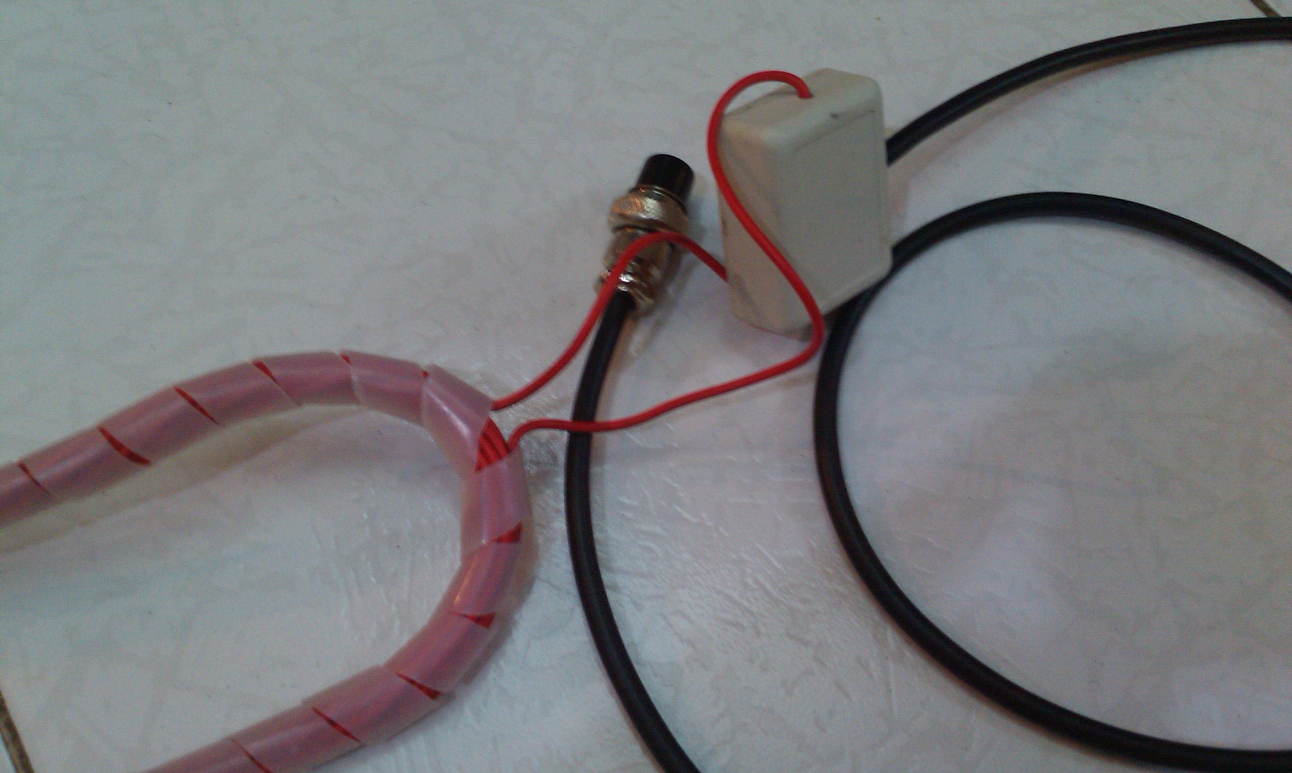

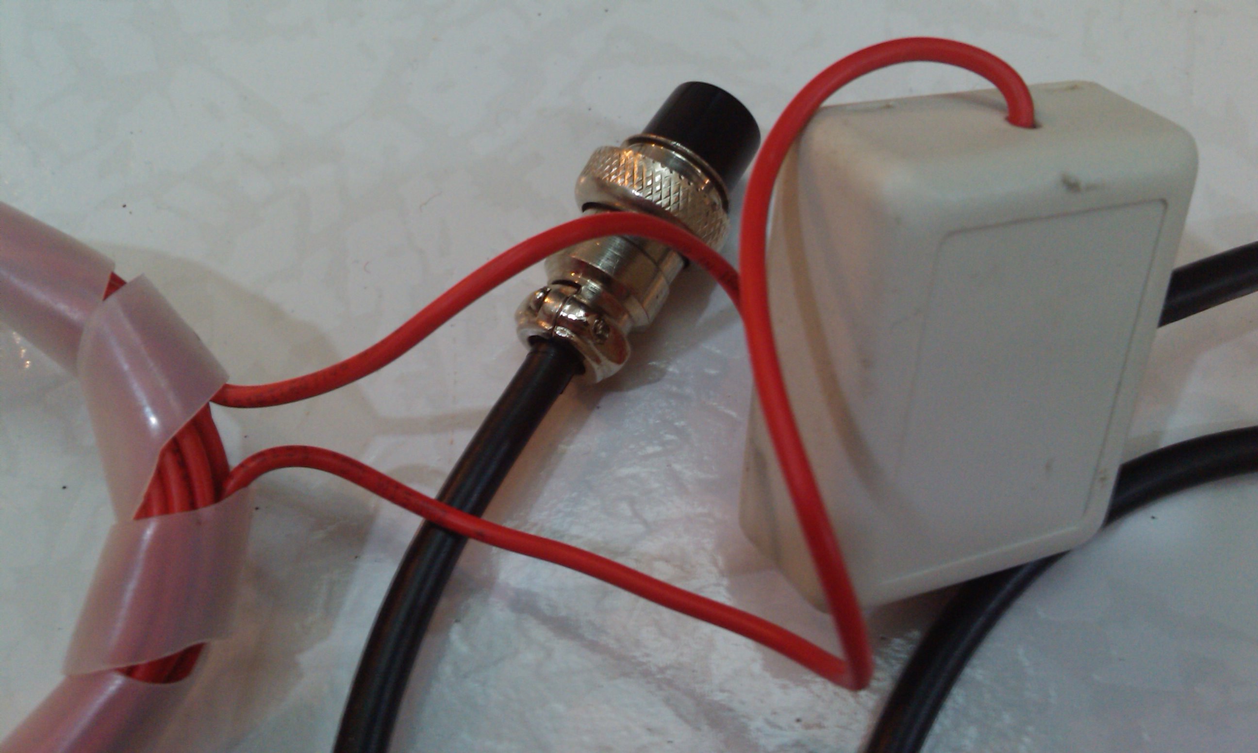

  • HI Jose Nice VID
    Cable flat is not available right now.
    Please tell me how can i make it
    Iused 0.50 Wire LIV and 13 turn And 4 Ohm for 1*1 . has no sense and
    Irf 840 is very overheated .
    pleas guide me .
    THanks.
    Iman Boroumand.

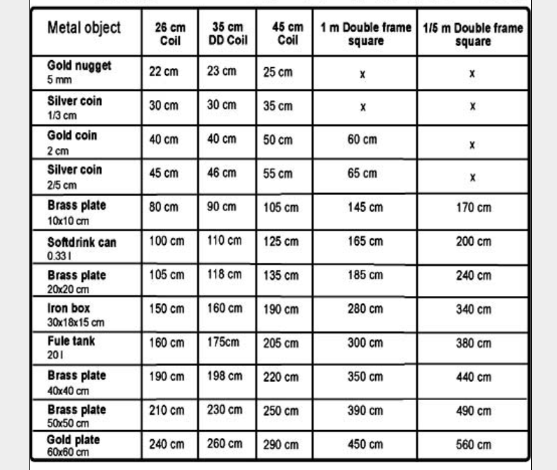

    • Detection depths.
      • Originally posted by Belief View Post
        Detection depths.
        [ATTACH]9739[/ATTACH]
        Excellent Belief, but what for silver coin 1/3 cm (mean 3,33 mm) exist there? I never seen such miniature coin.

          • Hola Belief
            Excellent work
            I use R 51 and C32 (1 ohm and 4700 mf) and a small sink for IRF 840, I see in the picture.
            P3 20K I use 10 K to 60% (approximately 120 microseconds) it seems that this value is the good compromise between power, minimum power consumption and moderate temperature IRF 840.
            Coil 1 * 1 meters
            This is my experience but not if it is right.
            Flat cable as shown in the photo, I got the best return.
            With less than 17 or 18 laps, the behavior of Delta Pulse is unstable.
            With over 4 ohm resistors reduces the sensitivity.
            I think we can try to type workshop with driver 18 X 1 mm.
            You can see another example on page 10 post 239, this same forum.
            Sincerely, Jose
                  Detection depths.
                  I would like to see this 60x60cm gold plate.
                  Tinkerer
                  • Originally posted by Tinkerer View Post
                    Tinkerer
                    this table is belong to lorenz .
