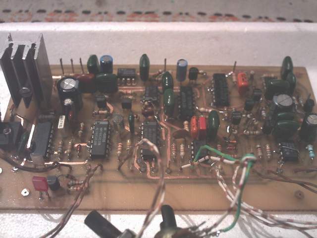

    Treiti informs us that he did order and gotta PSB's for DP, you can see a some his result, an all-in-process. I hope as he is here so can add anything he has yet attained.
    • #92
      Hello,
      Beautiful work.
      It will be interesting to compare performances following the same protocol.
      If there are of improvements to bring to improve the performance I will be very interested.
      JCM

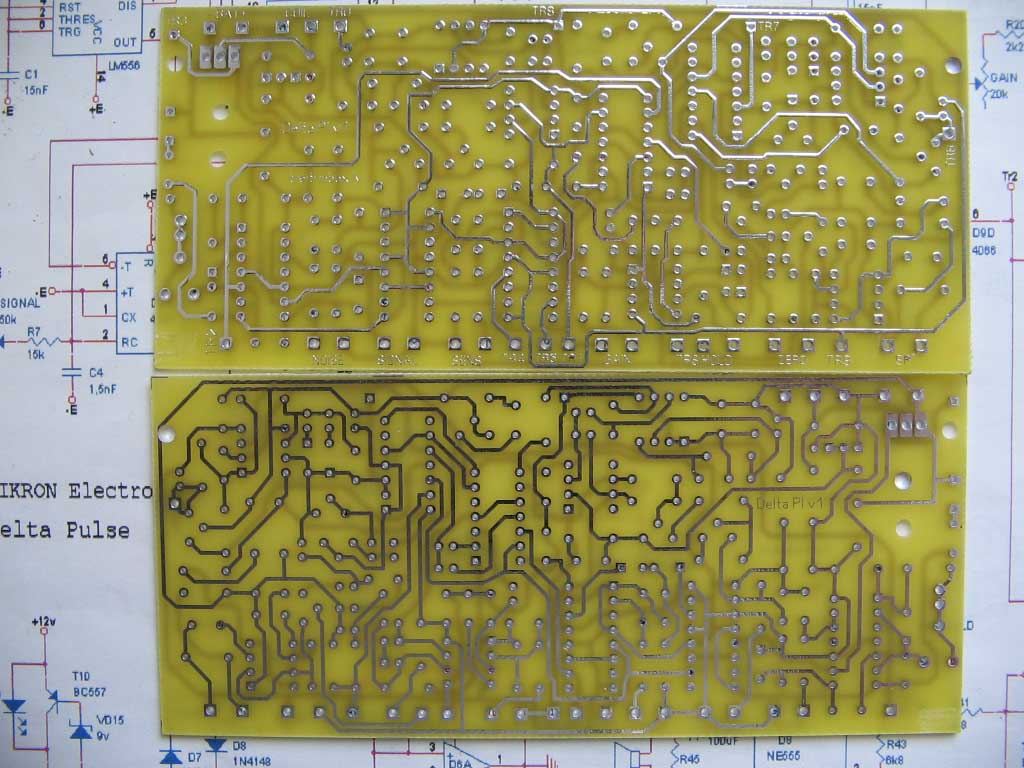

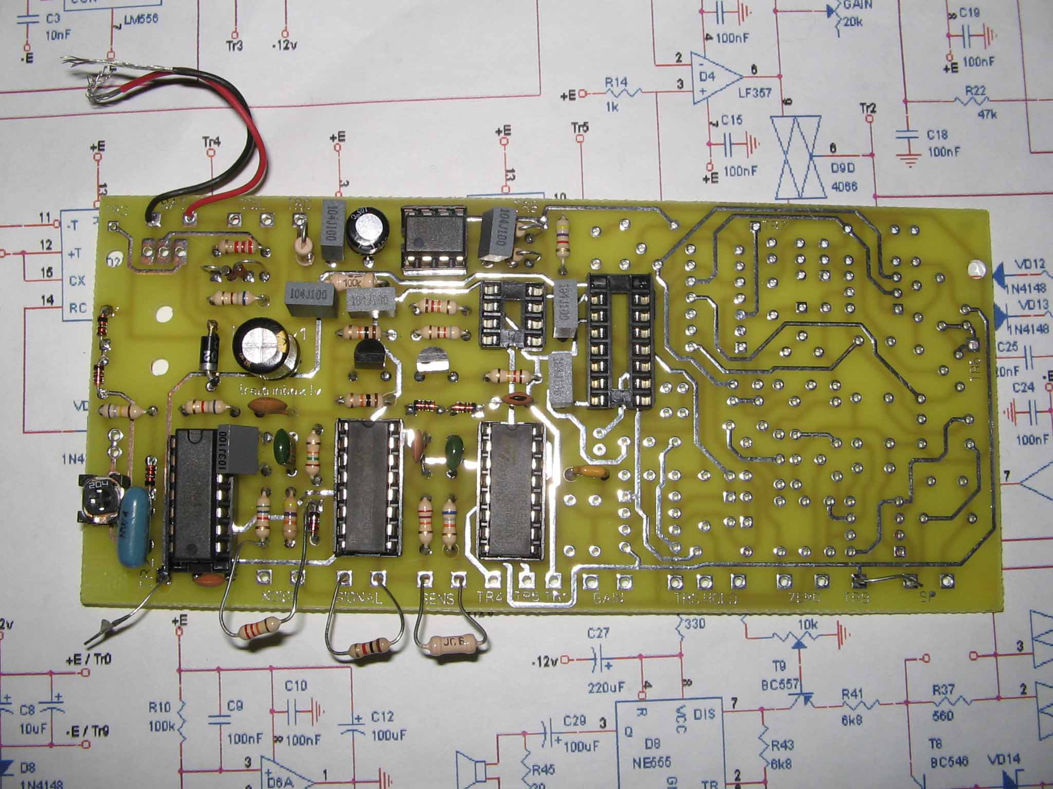

                Hi Kt315
                I tried to build pcb for delta.but it was full of cracks and cuts.
                I wonder about treiti's board.is it made by two sided copper board or with another tecnique.first picture looks like made by electrolitic dyes.
                and second problem was mounting (sockets,legs ...what do we call the part that we put under IC s.to protect them from soldering heat.
                • #98
                  sorry I forget to add problem.
                  it is that soldering this units legs on front side of board.they kiss board well that I can not solder it.

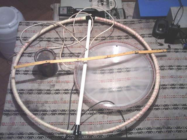

                        • Geo, hi !
                          I busted out my impendance meter a few months ago, so i can not tell you that, but it has 35 windings, 0.7mm Cul wire...
                          One more thing....yesterday i made another coil, on "hoola hop" toy with diamm. 75cm (round shape) i made 18 windings, 1mm wire, 4.4 ohms, and it is working crazy!!! That paint can(1 liter) it can detetct over 140cm, i did'nt test other objects cose it was performed inside my workshop and coil is detecting almost everything from every directions!!!I had to lower the gain at the minimum to perform that test with the can,otherwise it "beep"-ing all the time.I still can not
                          test it outdoor cose i did'nt put it in the box yet. But the "reset" knob is working
                          perfect and once you push it device is calming at once.
                          Thanks for those tips.I am gonna try a.s.a.p. and report here.
                          I just do not know about increasing the gain, is it safe now with this performances already? And what about power consumption.It will increase also.
                          But anyway i'll try it...
                          Geo, my friend thank's and regards!!!

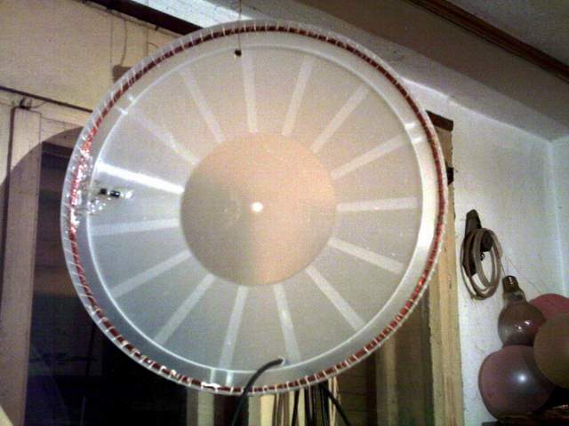

                            • Originally posted by ivconic
                              One more thing....yesterday i made another coil, on "hoola hop" toy with diamm. 75cm (round shape) i made 18 windings, 1mm wire, 4.4 ohms, and it is working crazy!!! That paint can(1 liter) it can detetct over 140cm, i did'nt test other objects cose it was performed inside my workshop and coil is detecting almost everything from every directions!!!I had to lower the gain at the minimum to perform that test with the can,otherwise it "beep"-ing all the time.Geo, my friend thank's and regards!!!
                              Hi Ivconic. At First congratulation for the very good coil. Did you tried the 75 cm coil with less turns? If required 18 turns then at 25 cm coil require at least 40 turns. With 75 cm coil can you detect a 2..3 cm coin? If yes then it is a big coil for small and for big objects. The dumping resistor was 2k2 or 1Kohm?
                              If you put the frequency at 100 hz then at who distance can you detect the 1 litre can?
                              Thanks a lot
                              Regerds
