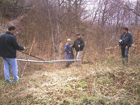

                            • Howdy...
                              Me,Ivconic and Strujas on the field eith Pulsestar II....
