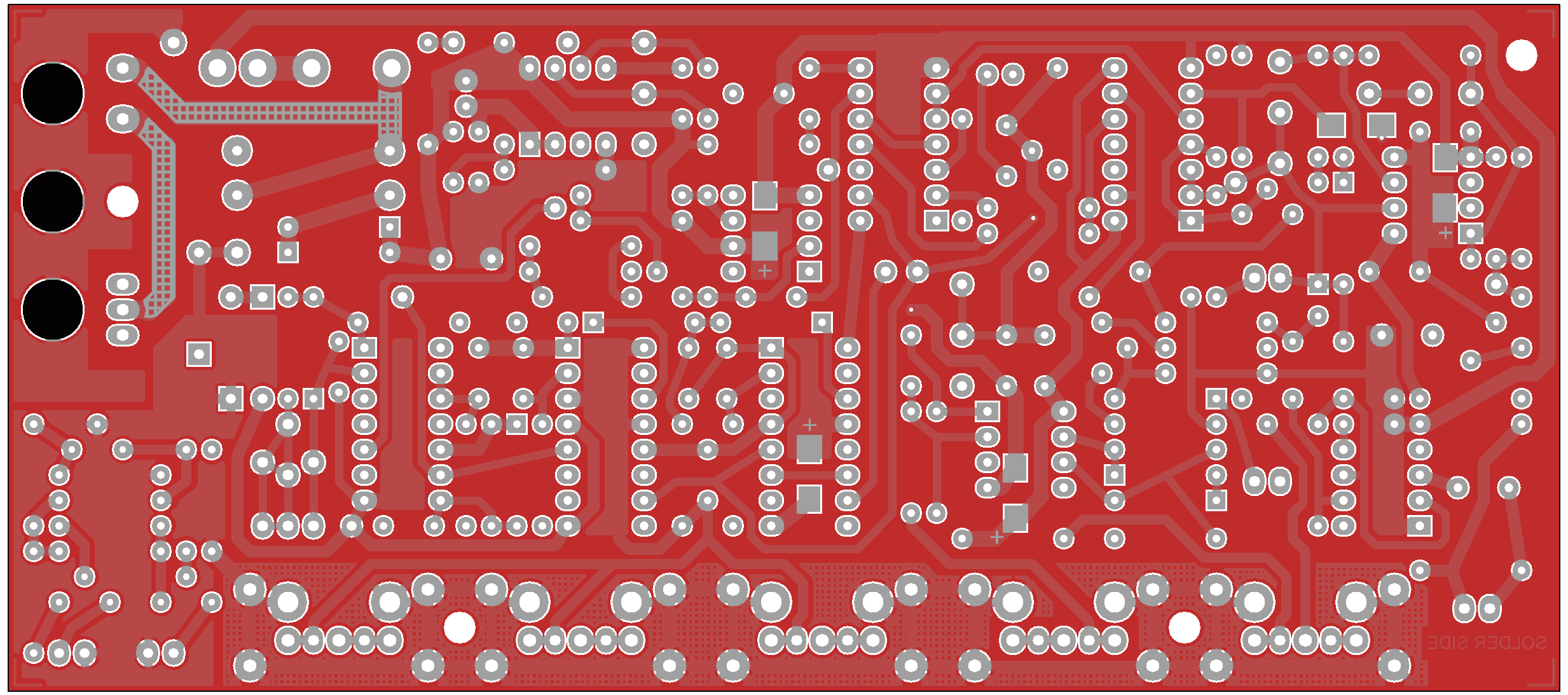

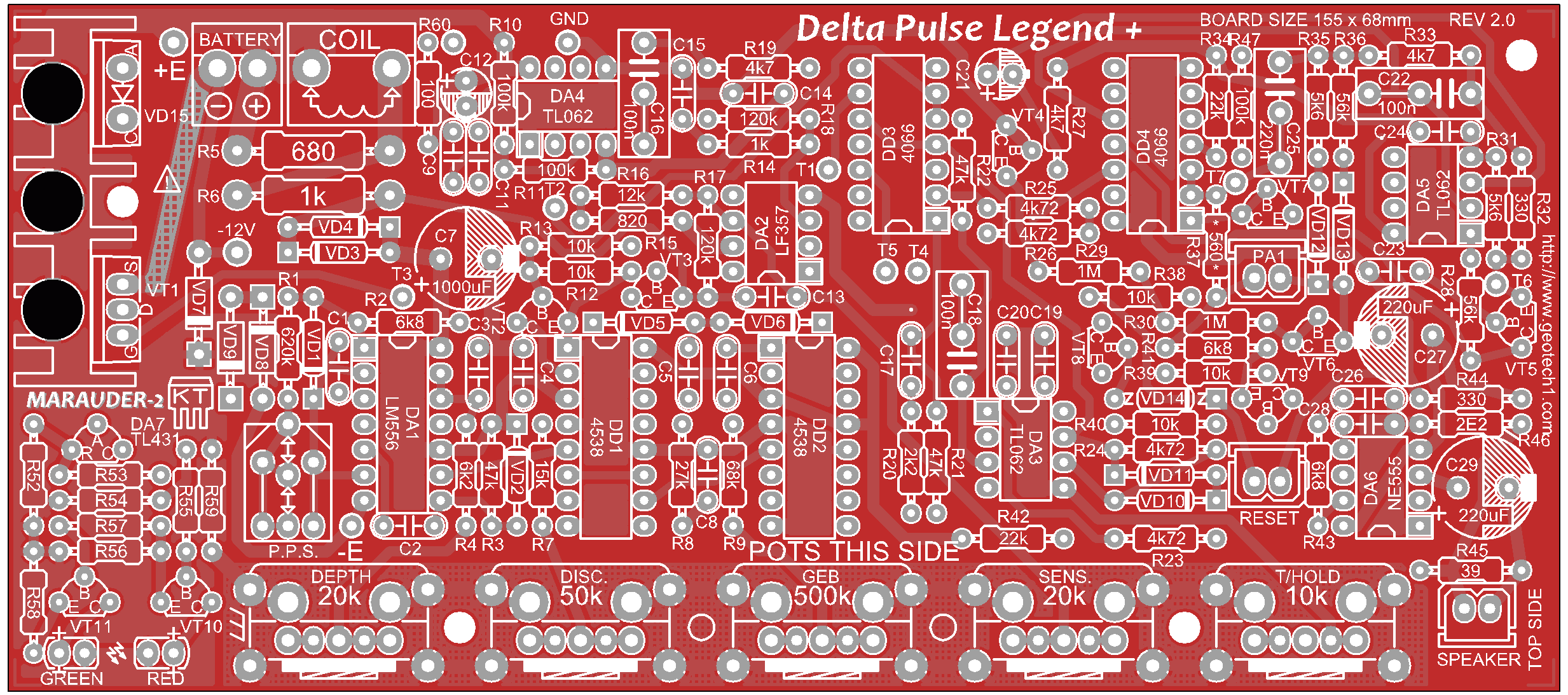

Delta Pulse
      [ATTACH]37789[/ATTACH]
      [ATTACH]37790[/ATTACH]
      Dear KT315, do u have lay and schematic for that version?
      Thank's
      • last revision, no special change

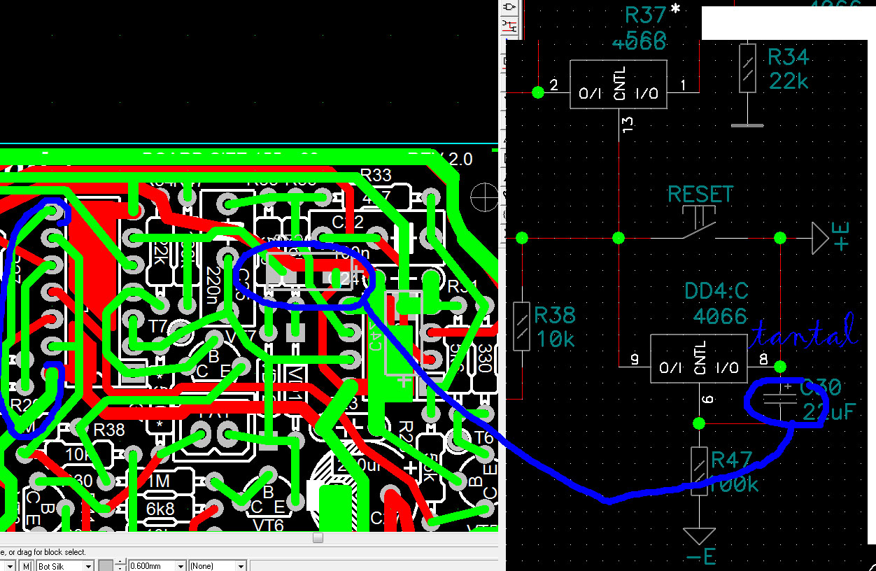

        • a mod that was released. if you set a tantalum, on bottom side, it will work, or not it will not work - simple way.
            [ATTACH]37824[/ATTACH]
            Thank's.

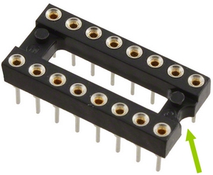

                            • diodes, or one of two, burn ALWAYS if at least one chip is setted backward. people solder sockets for ICs and do not
                              see top silk marking on a board. that is why i do not suggest to solder sockets.
                              • We have to respect the keyway of the socket.
