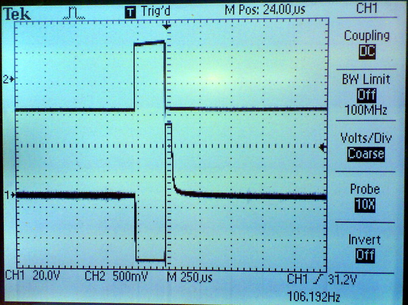

                • Hi Nelson
                  At the final communicate with you, I think you be able
                  Running you delta pulse. Because I don’t have another mail
                  From you.
                  Any way, as I said you latter, one of the important measurement
                  Industrial is oscilloscope. It is better if you borrow oscilloscope
                  From a friend in your local area.
                  See attached picture, channel two show pulse on gate irf740.
                  (upper waveform)
                  Channel one show output of amplifier, pin 1 of TL062.
                  (lower waveform )

                        Hi Nelson
                        From you.
                        (upper waveform)
                        (lower waveform )
