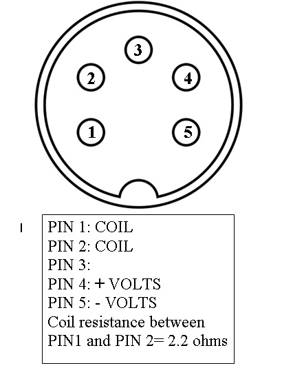

        I need one more clarification. Do you suggest to connect aluminium faraday wire to positive pin (Pin #4)?
        Best wishes,
        Bob
          Yes! To ground. In this case GND is +pole....althought there is digital ground on pcb....i am wandering about it? I never used f.cage,since my previous devices worked on low freq. and i made only large coils so far...

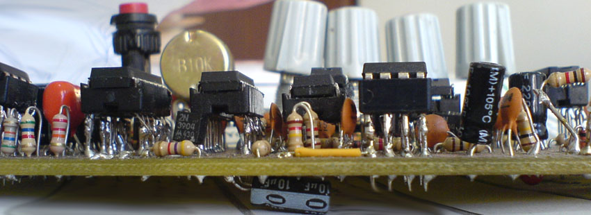

            • Here is my Delta Pulse:

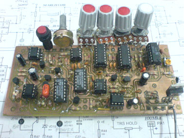

              • Soldered IC sockets photo
                • good job
                  [ATTACH]1551[/ATTACH]
                  hi 1843, good job. which are the performance and which type of coil you used. thx
                  • Originally posted by dan129 View Post
                    Hi dan129,
                    It has a problem and its detection is poor...
                    I shall repair it next week since I haven't oscilloscope now.
                    My coil is 70 x 70cm.
                    cheers
