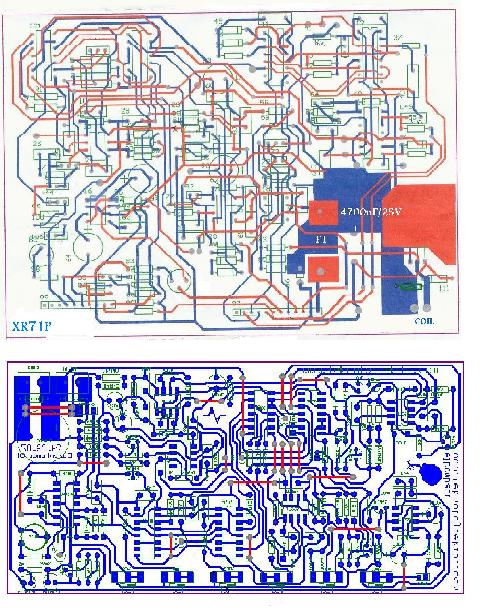

  • I know the Delta Pulse and Sniffer XR71 are almost identical. But their pcb's are designed differently. Has anyone built both designs? Is there any advantage of one or the other in regards to noise, ease of component placement, etc?
