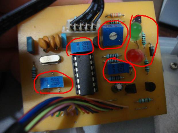

    Hello!
    A friend built this detector at my request, but lacks some adjustments ...
    Their efficiency is very small ... really need YOUR HELP .......
    I understand very little about electronics all tips will go to my colleague ..
    HELP
    1 the LEDs of not funionam small plate (ferrous and non ferrous) ..
    What are trimers (3) on the same plate?
    2 ° I have to pass the ociloscópio in that part of the device and how?
    What is the best fit?
    Any help is welcome .....
    Thank you for your attention and patience ...

                The photos ...
                • 1 the LEDs of not funionam small plate (ferrous and non ferrous) ..
                  interesting PCB. still did not see the circuit. may be similar to one made by man from Poland but why there is a quartz? what IC is standing on the PCB? IMO, enough simple PCB to draw the schematic.

                    • I think the LCD screen is only a mechanical substitute. The Delta Pulse does not discriminate. The Turkish colleagues may display slightly different. The program of PIC will not be published.
                      The trimmers set the value on the display (battery).
                      Already be sensitive to the metal detector, if the previously described set by an Iranian colleague and the changes do give. The small metal detection as described in the previous entries should be exercised.

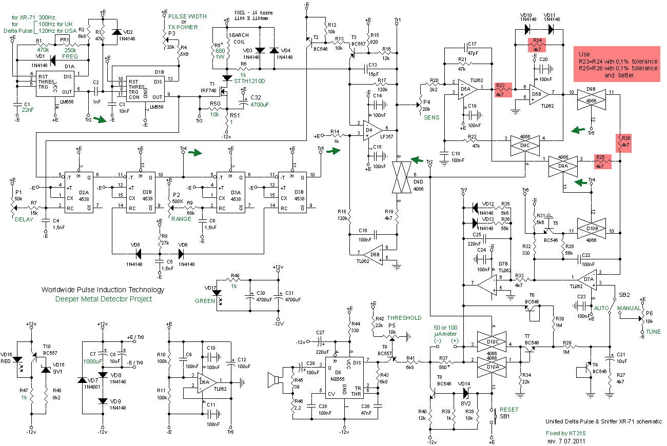

                      • sz, can you draw these points A...E on the schematic? tia

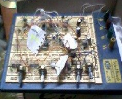

                          • thanks kt315

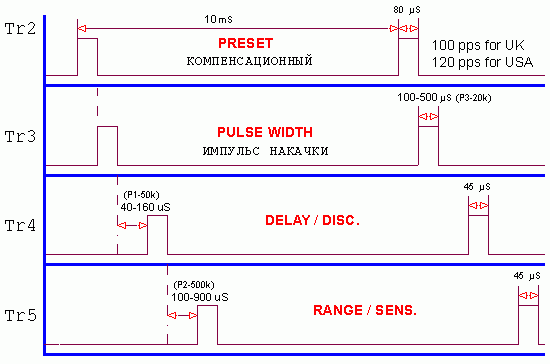

                            I put the components on the test board..... I want to test it >>
                            Do you know the voltage and the current in certain places ... such as Tr1,Tr2,Tr3.....
                            -Isthe coil hasspecial specifications to make??
                            Diameter,Number of turns,H,R and spiral or disk)
                            BEST REGARDS
                            • Do you know the voltage and the current in certain places ... such as Tr1,Tr2,Tr3.....
                              look at diagram. you must get these signals (voltage, not current) in the points.
                              ordinary coil of inductivity 400-450 uH (MICRO- HENRY, NOT MILLI- !!!).
