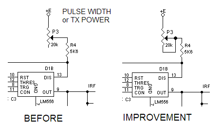

  • Bernd, I think the problem is in bad quality of potentiometer P3. Please test it. The lower end of potentiometer should be connected to wiper as shown below.
      thanks
      problem at mine version is that
      wiper is already connected to higher end
      but i have tried what you say and connect lower end to wiper
      there was a change
      also i see that i cant tune it to no clicking point threshold at mine were 10k
      so i changed to 100k and i cand set threshold to low clicking or zero
      but coil doesnt react on metal
      so there is still a bug on it
      regards bernd

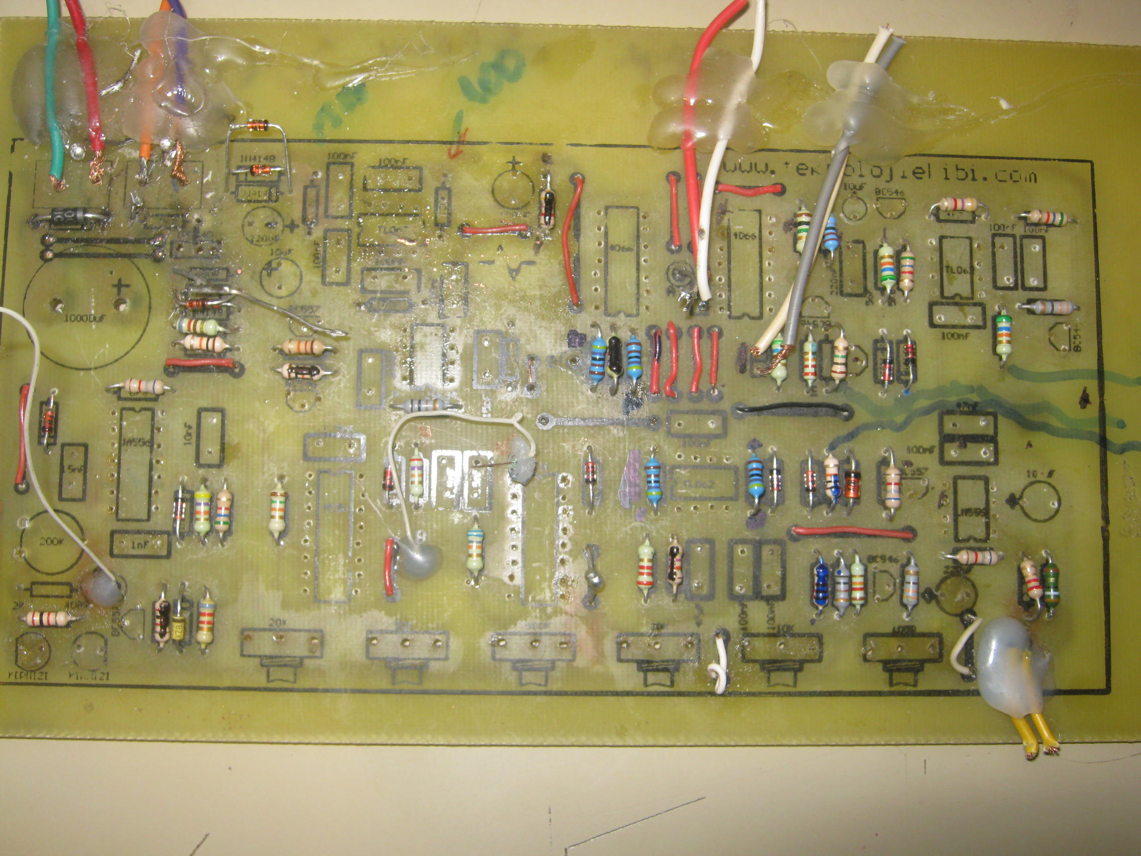

        • sniffer xr71
          Hello everyone.
          I have not made my Delta, I destroyed, will start working on new Delta PULS.
          CAN YOU HELP ME SOMEONE TO WHICH VERSION OF DELTA begin working AGAIN
          HERE AND PICTURES FROM MY DELTA DESTROYED
            Hello all:
            I need help as soon as
            Need the right circuit for Delta Pluse without errors and if there is to explain it and clarify each component
