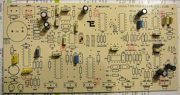

                      • Does anyone have parts placement sheet or schematic for the 7 knob Turkish delta pulse? I found the 6 knob but it's not close enough.

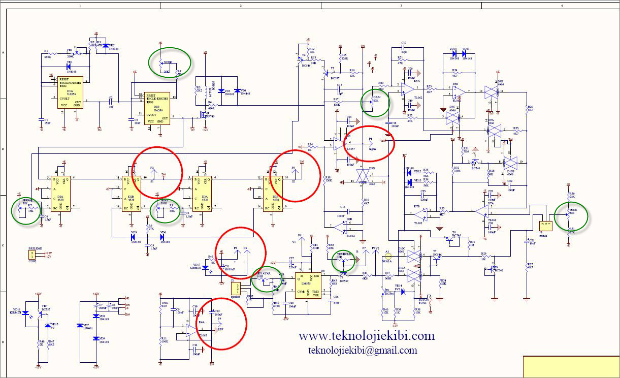

                        • Originally posted by sparky View Post
                          [ATTACH]21305[/ATTACH]
                          Look it.
                          Green circle for Plot or Knob
                          Red Circle Connection LCD with PIC 18f252
                          Best time
                          N.
                          Delta pulse _ema (1).pdfClick image for larger version

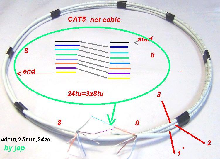

                              can you help my to crate a pefrect coil for my set ? and i have only 680ohm . 1w nad 1.5k 2w resistance for r5,r6 .
                                Hi hadi-dindar
                                -coil 40 cm 0.5 mm 24 turn =adsl cat5 3x8turn ...2.6 ohm
                                Put pictures of the project
                                best time
