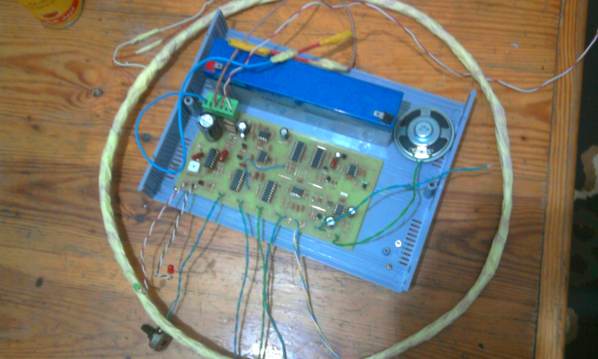

    I finally made ​​the PCB and mount today.
    Question for all that is the final revision of the list of parts ii percent do not know which is good because there are a lot in the forum. thanks

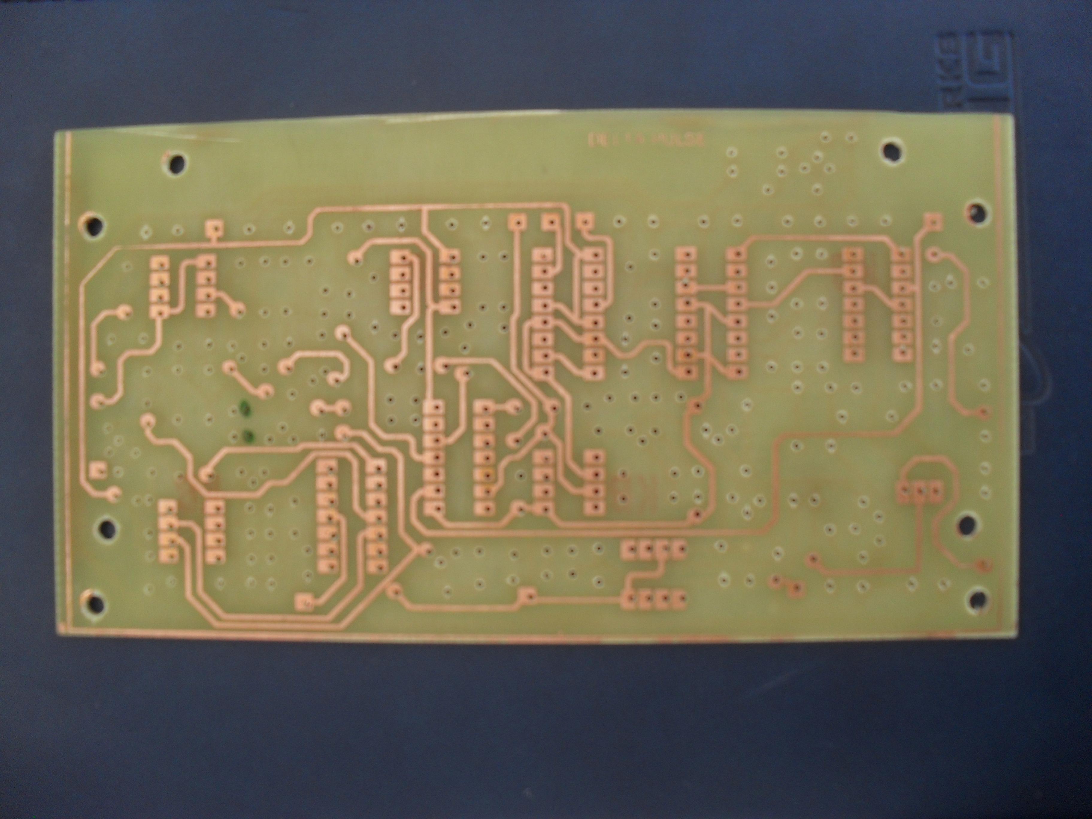

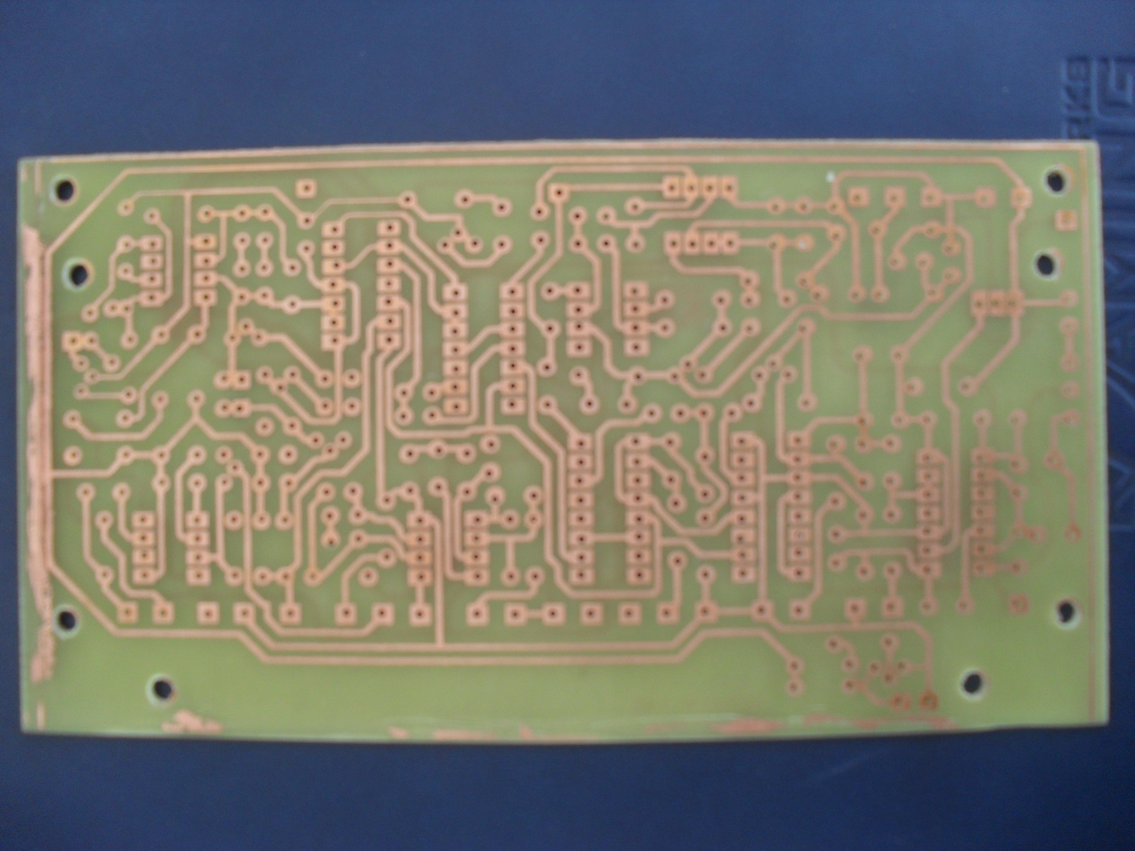

        • Is this full or demo version?
          • This is 2 sided version. Nice work! Congratulation! We waiting for your project ending. :-)

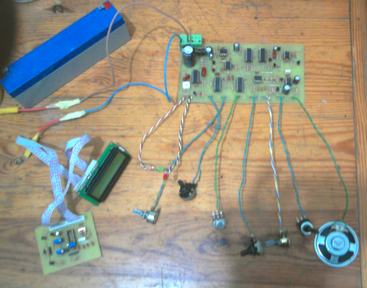

            • Hello everyone
              can i replace diod 1n5819 Located in lcd schematic??
              • Hi KoKo22
                -U can,,,1N5817=1N5818=1N5819=BYS21=BYV10-,,,, OR any Schottky diode.

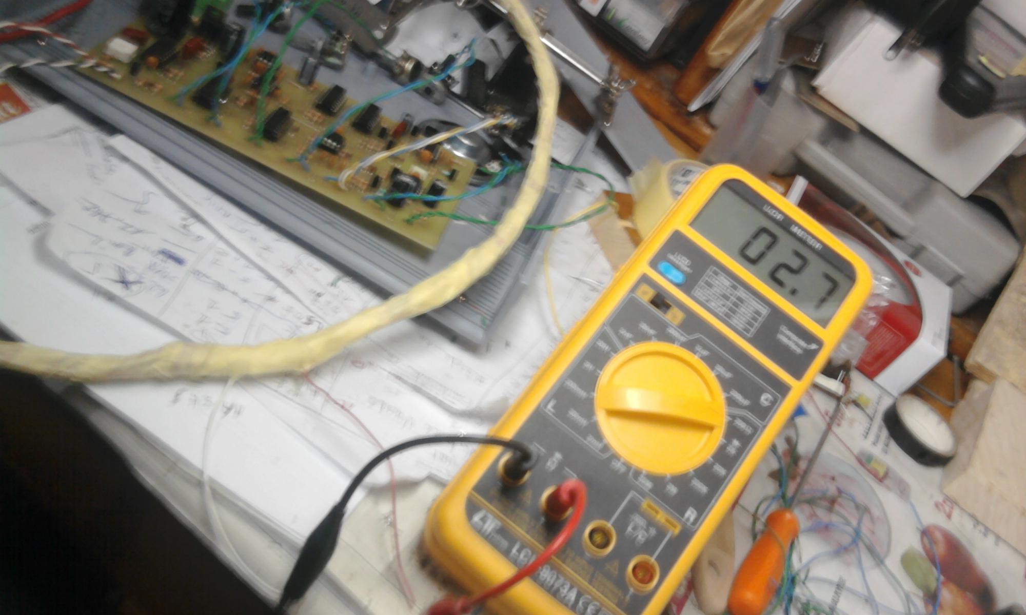

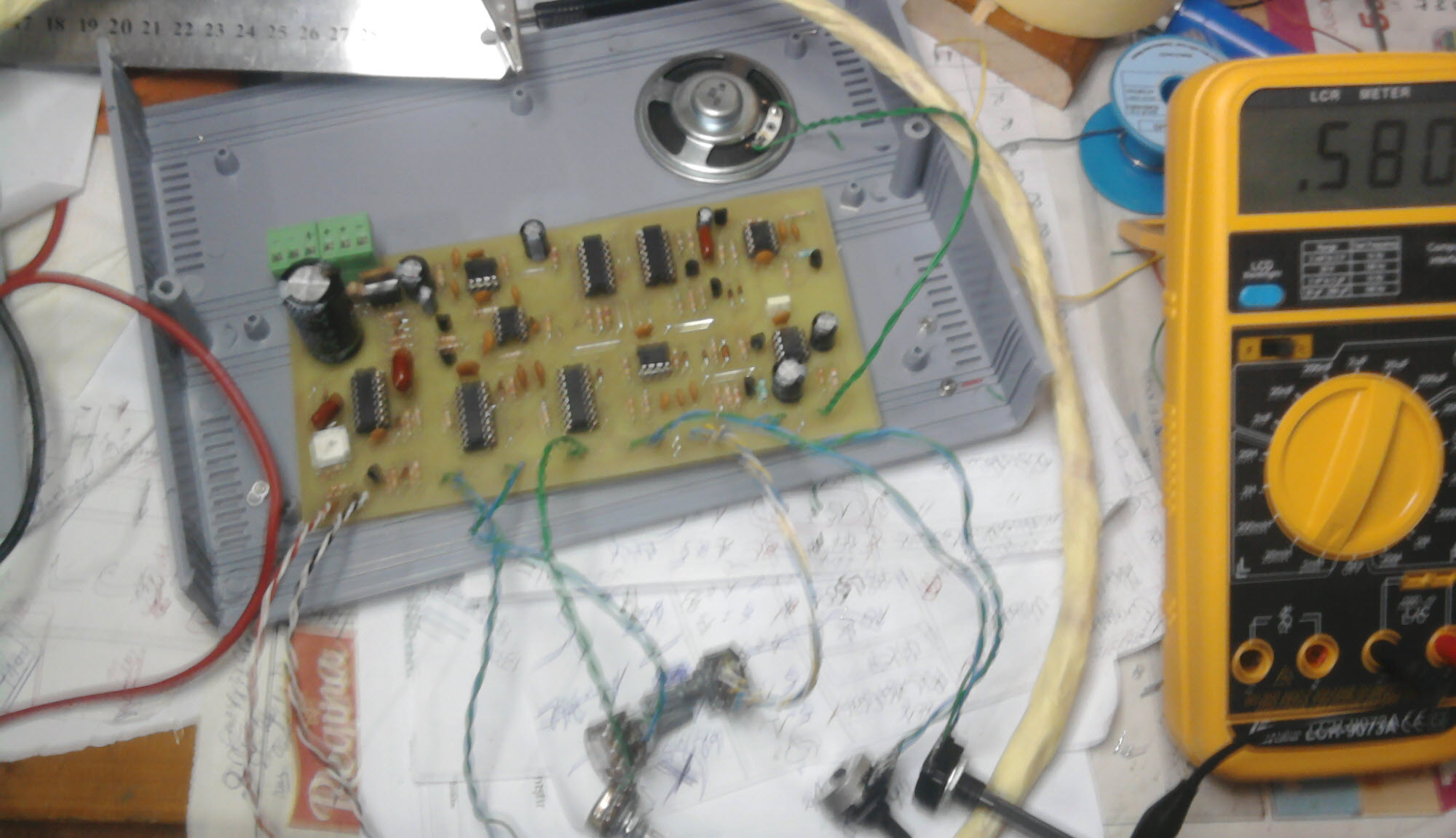

                          I need your help
                          I build coil 40 cm two wire x12 tur 0.5 mm R=2.7 Ohm 0.580mH
                          R5 = 2.2k 1/w
                          IRF 740 is hot
                          and I test coil not detect small parts only 40cmx20cm parts
                          What the problem?

                              Hi Nicolas
                              -Bad coil because the type of wire is ~ not Copper.
                              -try CAT5 .

                                Hi Jap
                                Ok I'll try another type of cable
                                thank you and if I find another problem. I contact you
                                Note: I soldered the IRF 740 in the first place upside down, but after I put it right
                                if you thought that any defective component or
                                Best Regards
