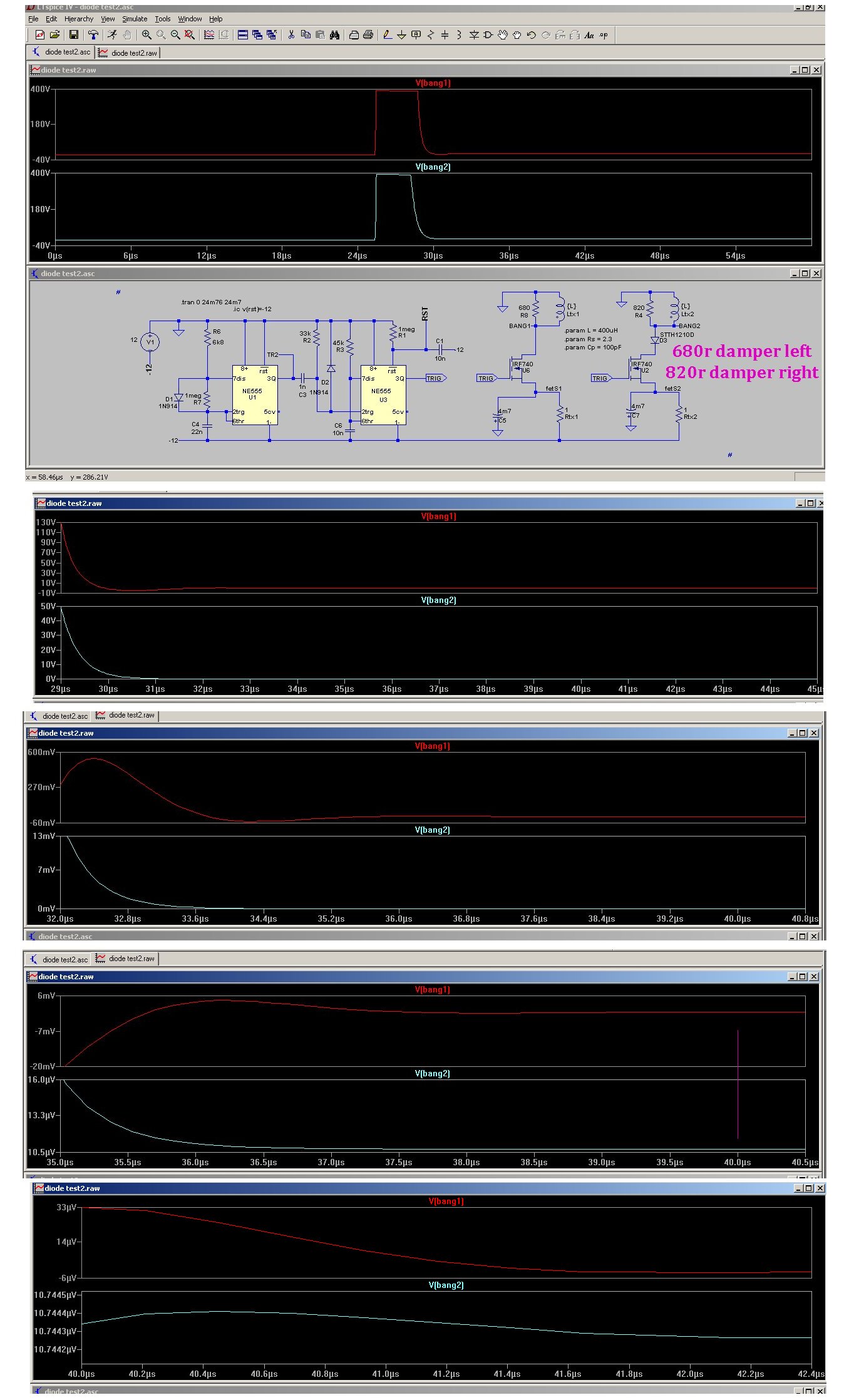

            Here's my "design" process. I am not intending to belabor any particular issue but only trying to make it easier for somebody to follow my (often derailed or just plain wrong) train of thought:
            Using MiscEl's rectangular coil calculator: basing an imaginary coil on a 0.47m x 0.47m form, MiscEl tells me that 14t will get me about 400uH. With 0.4mm cross section wire (~26AWG) the resistance will be ~3.5Ω.
            With PW set to 500us (12V supply and 3.5Ω coil resistance) a 500us pulse-width may be too long. LTspice showed a flat-top on the current waveform which I believe represents wasted power. (So, it's "back to the drawing board".) There are no pictures of this shown here.
            To eliminate wasted power I could either reduce PW by about 70us~100us, or else I could use a larger gauge wire. Since "virtual" wire is very inexpensive, I will increase wire size.
            Next I'll try 0.5mm. MiscEl tells me that the same 14t of wire should exhibit 2.3Ω resistance.
            After making the necessary change in the simulation file, it looks like 0.5mm wire (which is only slightly smaller than 24AWG) might work very well for a 400uH coil, with PW set to 500us. As I am comparing one circuit with a diode and one without, I am having to split the difference when figuring out where I want to be... it is not a huge difference in peak coil current when using a diode as compared to not using it, but the difference is measurable.
            Now to run the sim and take some pictures. Note that the 40us mark in the pictures represents about 14.5us from end of tx pulse.
            After comparing things, it seems apparent to me that using a diode can definitely allow you to use a higher value damping resistor and still sample earlier than without. In retrospect, a series diode will affect the coil current final value and perhaps adding a small resistance in the test circuit on the left side would have equaled things out, making the comparison more valid, but I have no time for that particular exercise.
            I want to understand this because my design in progress uses two transmit channels, alternately. A diode in series with each coil is required for the two channels to have some degree of isolation. I hope to see it come together before the end of summer.
            Sorry about the long post.

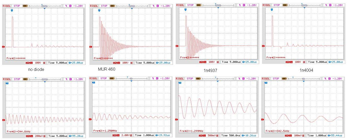

            • Recorded some data. No diode, MUR460. 1N4937, 1N4004. The data was recorded with R damping disconnected. 280uh coil, the diode was connected in series with a IRF740 fet. No coil and 1N4004 had a resonance around 340khz, Mur460 and 1N4937 doides had a resonance around 1.25Mhz. The top traces had the scope probe connected to the coil. The bottom traces had the scope probe disconnected laying near the IRF740. Planning on recording amplifier out with no diode and a MUR460 diode with the coil critically damped to see how much faster the signal could be sampled. Those are the only high voltage diodes I have.

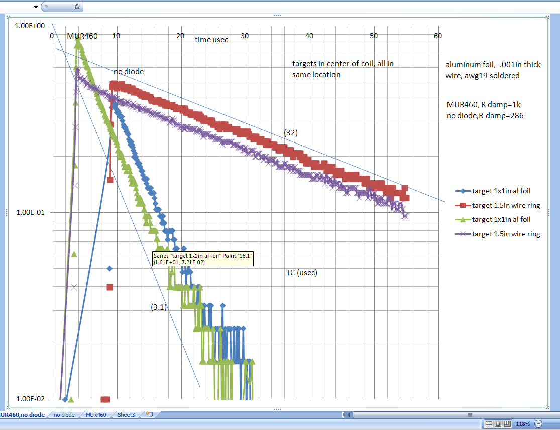

                  • Recorded more data. No diode vs MUR460. Didn't get what I expected. Thought the amplitudes would be the same at longer delay times. The no diode recordings are higher. Using pi*L uh*circuit resonance Mhz(no R damp) to calculate R damp. No diode=303 ohms, MUR460=1100 ohms. I used 286 and 1000, a little over damped. I already had a 1k resistor for R damp, paralleled 1k with 400 for 286 ohms The diode in series reduces the current at turn off, might be the cause for lower amplitude. Used a 6 volt supply, 12 volt supply might have less difference. Any other thoughts would be appreciated.

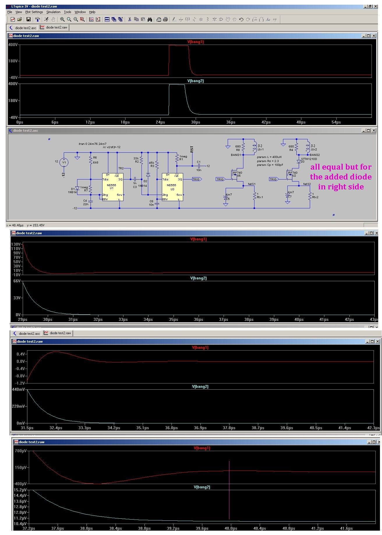

                        Here is a virtual comparison of using a diode and not having one. I see some apparent difference between the two circuits' performance, but how or if that equates to improved target detection can only be determined in the field .
                        It looks to me like adding the diode will cause flyback to decay much faster in the first few microseconds. If adding a diode works out for builders being able to sample earlier than they could have otherwise, that is a good thing. And if you can use a higher damping resistance than before, that should also allow a stronger signal to be seen at the receiver input.
                        I don't think the diode would need to have a 1500V breakdown voltage (although for all I know, the STTH1210 might still be the best choice for some reason or another), but it would be a bad idea to use something with a lower breakdown voltage as compared to the zener voltage of whatever MOSFET is being used.
                        In case it is not obvious, what I did with the progression in the photo was start with the "big" picture, and then zoom in sequentially towards the last few microseconds of the flyback's settling. Note that the 176us point is about 14us after the end of the transmit pulse.

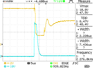

                        • hi
                          i see pis of dear Tepco , and this pic of my coil : 28cm , 460mkh and 2.1ohm (without coaxial cable ) and damping R is 820ohm
Name:	Damping for 820 ohm.BMP
                          • This looks reasonable, actually surprisingly fast. If you measured this with coax cable connected leave it as is, some ringing on waveform wont hurt, eventually reduce Rd to 680 ohm.
                            • Originally posted by Tepco View Post
                              yes , you learn me before , i change it with 680 ohm and next 450ohm , and next see in scope , both of them have a same respond in scope ( less than 15mks ) but why 450ohm work better ?
                              • but why 450ohm work better ?
                                that is only your subjective perception. fantazy. in original schematic Rd value is 820 Ohm. for DP working on long MAIN SAMPLE DELAY the ringing is not so actual
                                like may be for Surf PI, Bara, HH etc. from your pic BMP clearly seen that if you set MSD on 40us (really practically I set on 100-120us) the ringing is leaving at left on timing and not effecting.
