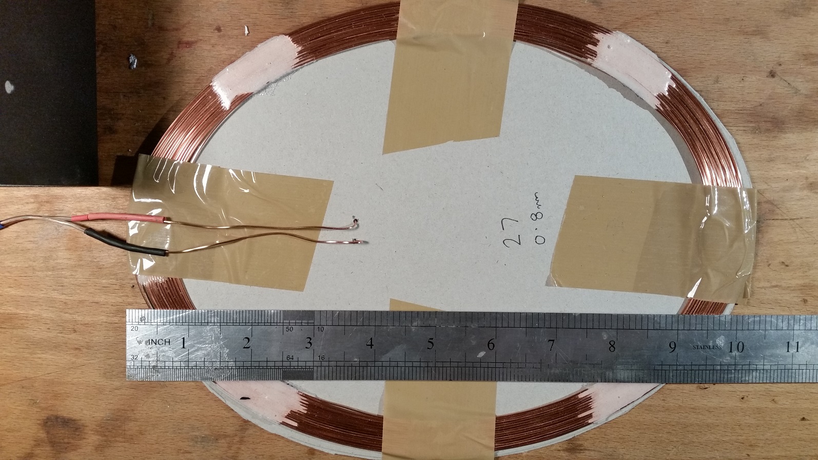

                        • Dean, what size diameter your coil is?

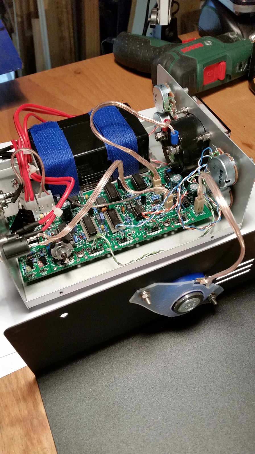

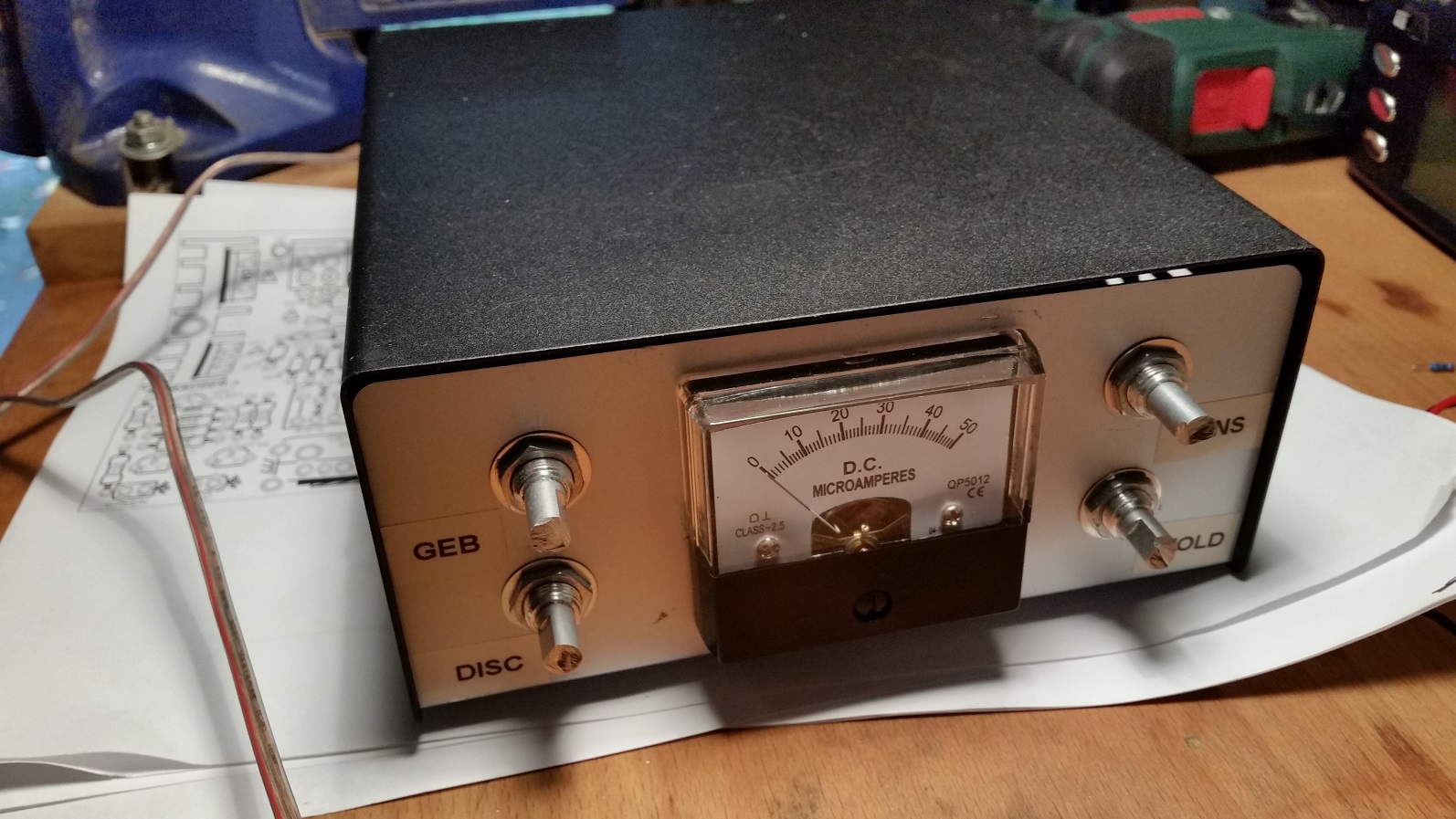

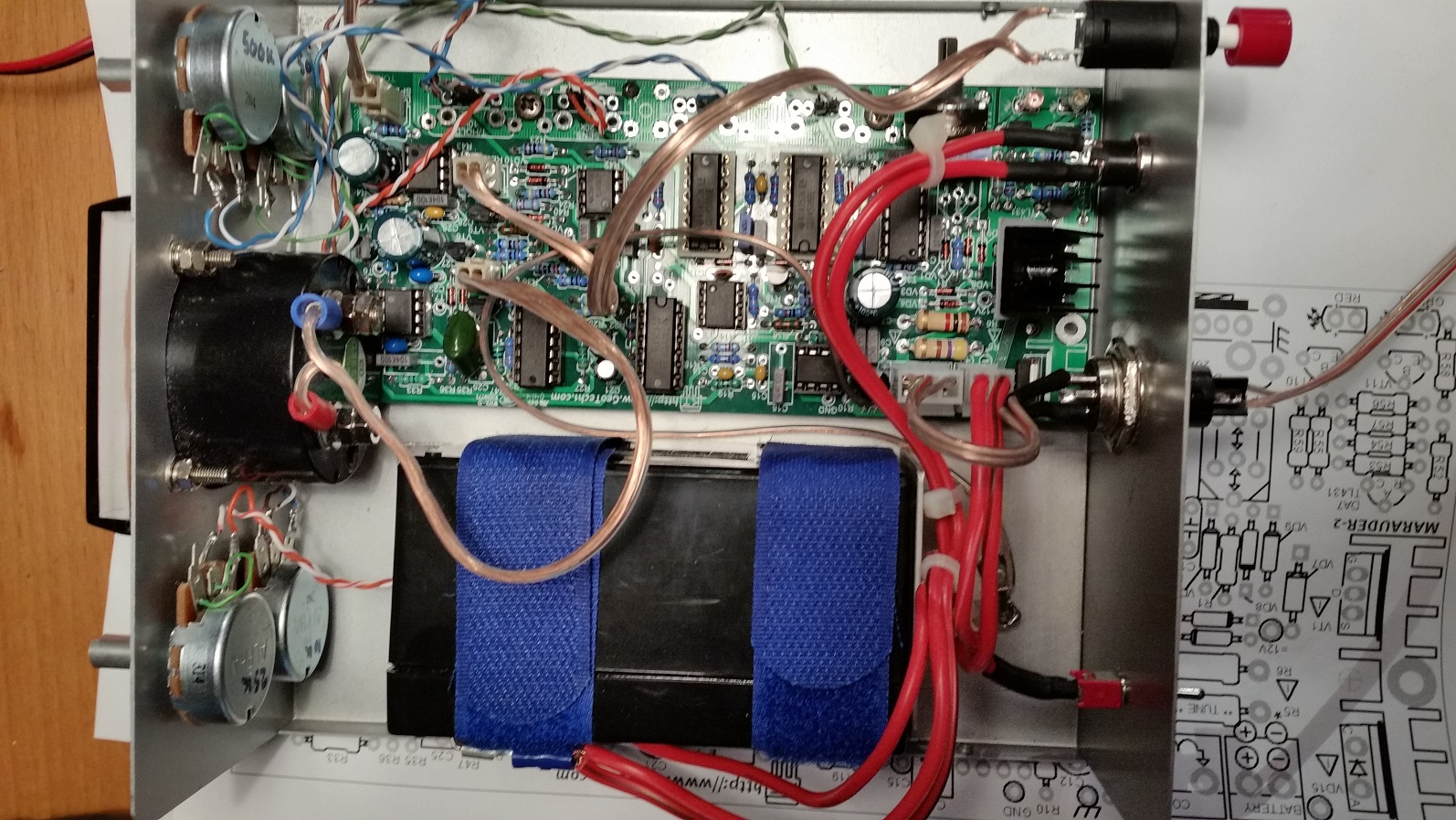

                          • Hi Kt315,
                            The coild I am using is a flat spiral wound coil is 10inches long and about 8 inches wide refer to the attached picture.
                            When I measure the inductance with an inductance meter is measures about 300uH.
                            I have includes some pics of the assembly also..!

                            • Hi Dean
                              I want to discuss my personal experience with the DP if it's any help, this may be wrong, but this is my finding on the issue.
                              Small gold is difficult to detect with the DP.
                              You can change the delay to work on minimum values​​, but the response of the amp (LF357) can reach 17 or 18 microsecond minimum value by design, and this limits the ability to detect small gold, besides the SAT, it is a bit slow.
                              However, you can spot a good gold ring in 30 or more cm.
                              Another thing you could see is that it is not stable with low resistance coils. The total resistance including cable, should be 2.5 ohms, or greater.
                              Also the frequency and pulse width TX, affects performance.
                              For small objects, works well up to 400 or 500 Hz.
                              The TX pulse should be between 100 and 200 microseconds
                              greetings
                              • Hi Jose,
                                Thank you for your comments this is very re-assuring..!
                                First I think I will look at replacing the LF357 with a faster slew rate op amp and see what difference this makes..!
                                If changing the op amp doesn't work then I will look at the TX pulse width..!
